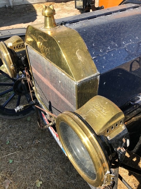

As usual, the cautious reply would begin, “ . . . It depends . . .” I’m a slob. All summer I use my Lizzie (‘13 runabout) as a farm vehicle, hauling feed, changing the irrigation, chasing water, etc., through deep mud (sometimes) in all weather. Come late fall, she’s in for an annual cleaning, R&R, tuneup and whatever repairs are necessary. This includes polishing the brass, which takes a while, but I consider it good winter therapy. She won’t look a lot worse come November, this is the state of tarnish now. Once I let it go two seasons, the process wasn’t noticeably any harder. I use “Blue Magic”, it works very well IMHO.
I’ve worked on items so tarnished they looked like patinated statuary, and years of deep tarnish is very difficult to bring back.

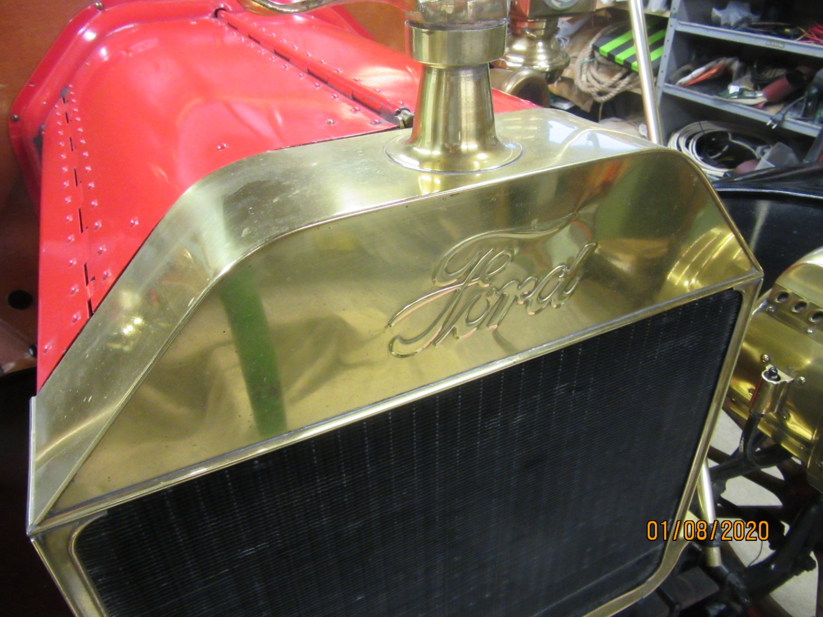

Post by ABoer » Sat Aug 01, 2020 3:47 pm
Two more pictures .
Toon
Posts: 3743
Last Name: Wrenn
Re: A question about brass
Post by TWrenn » Sat Aug 01, 2020 7:41 pm
Looks good Toon. I am surprised it holds up so well on the hot radiator though.
