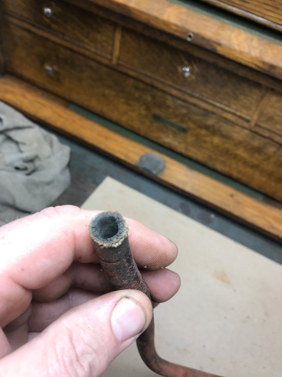

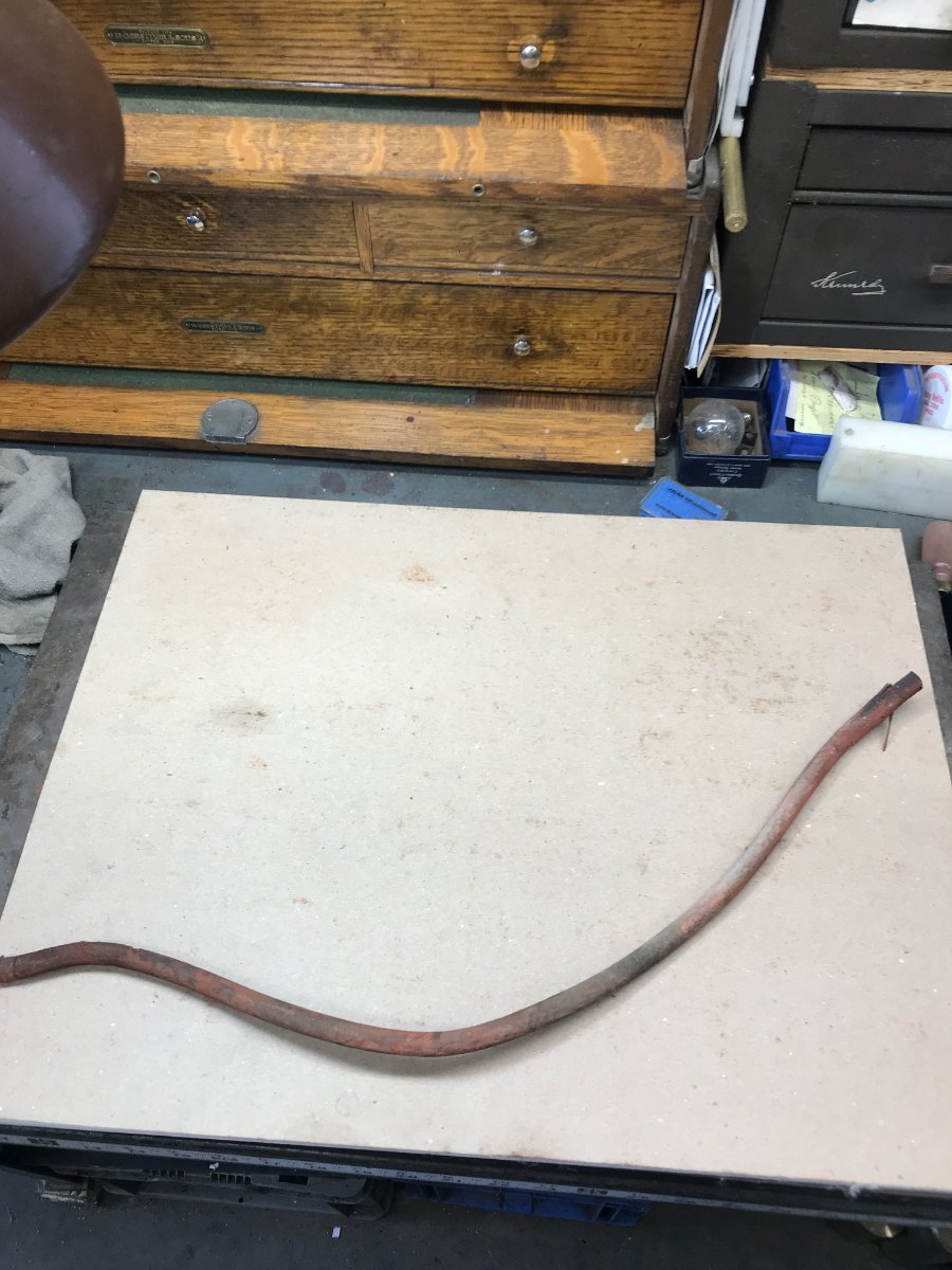

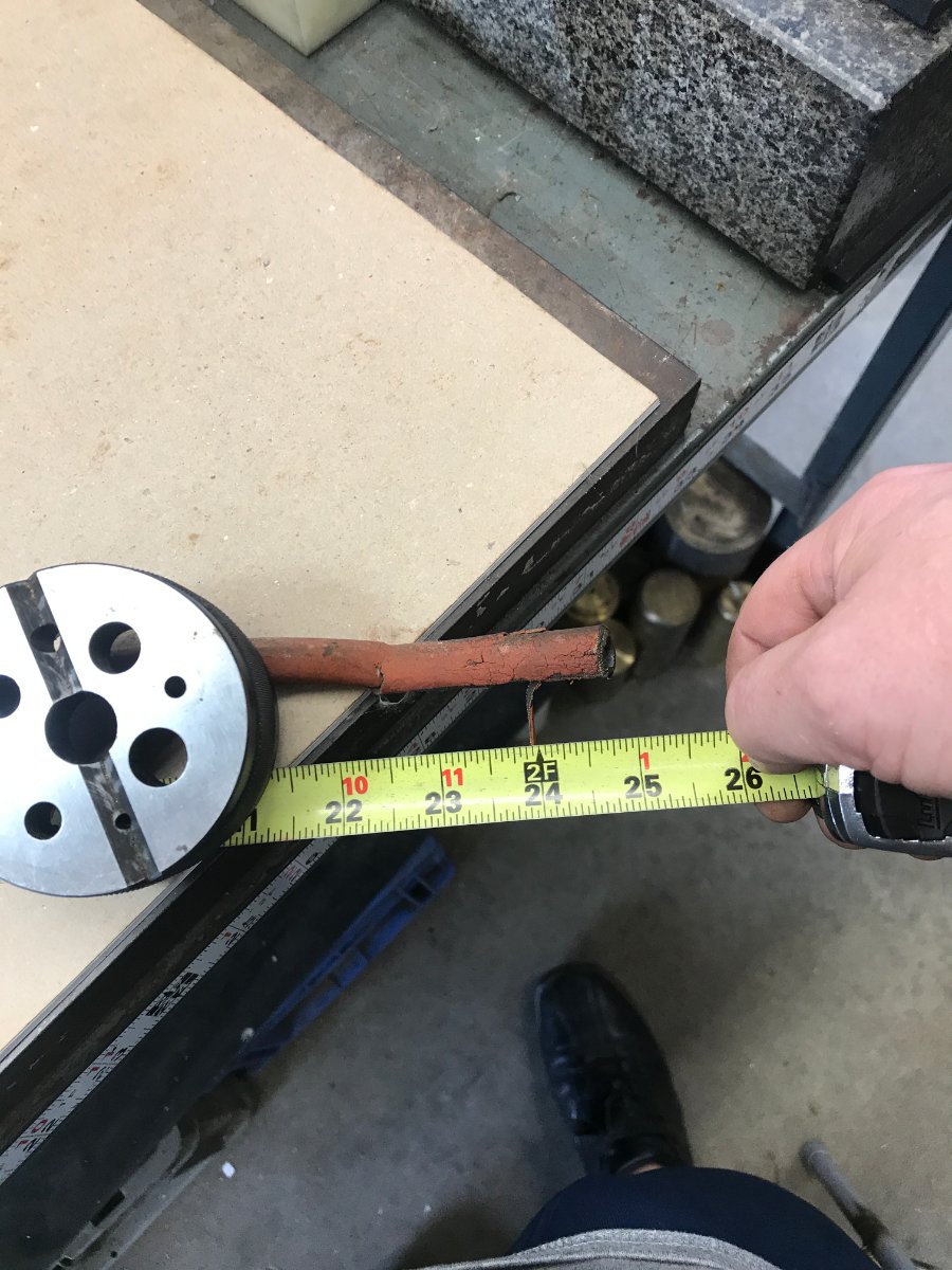

I still have the petrified original hose from my generator to the frame pipe. The piece that goes thru the splash apron for my early '13. I'll measure it.

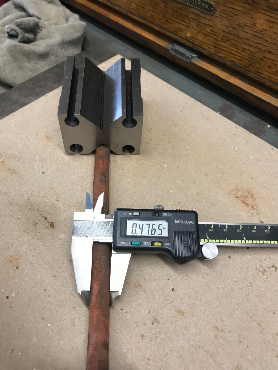

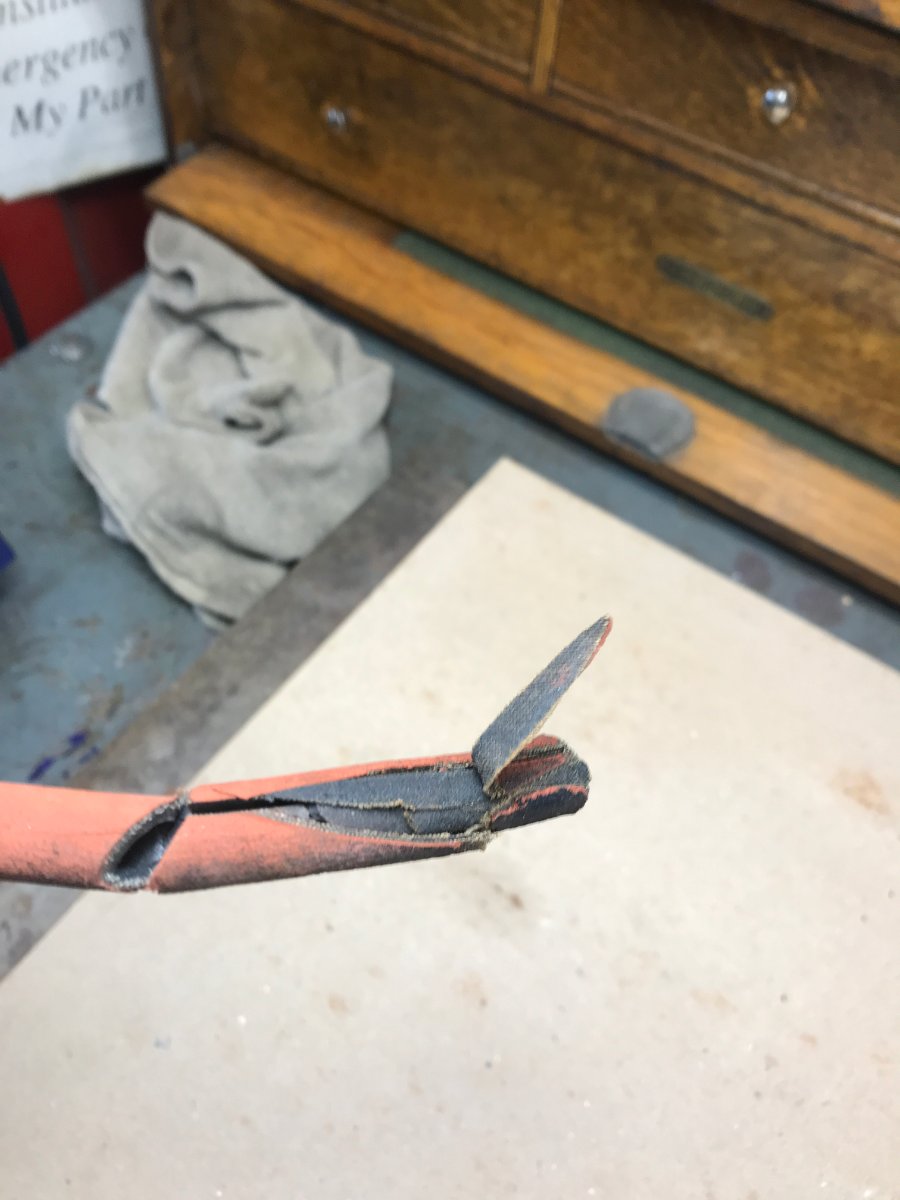

Here's photos of my "original" hose. It is between 24 3/4" and 25" long. The outside diameter is 15/32", slightly over 7/16" as Larry pointed out for original specs. Since my car is a Canadian car, some variations may apply(?) This has been on this car since my grandfather bought it in 1956. I would imagine, it's been there all it's life. I have no way of proving it but take this info for what it's worth. Hope this is helpful. The hose is cloth wrapped.

While not correct mine works perfectly and welding hose comes in more than one size.I would avoid old cracking hose but that is just me.Bud.

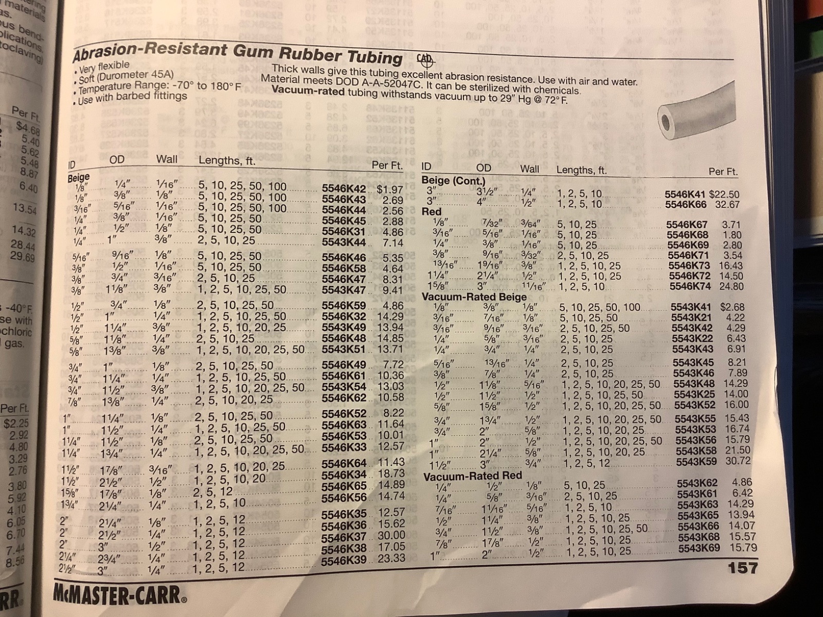

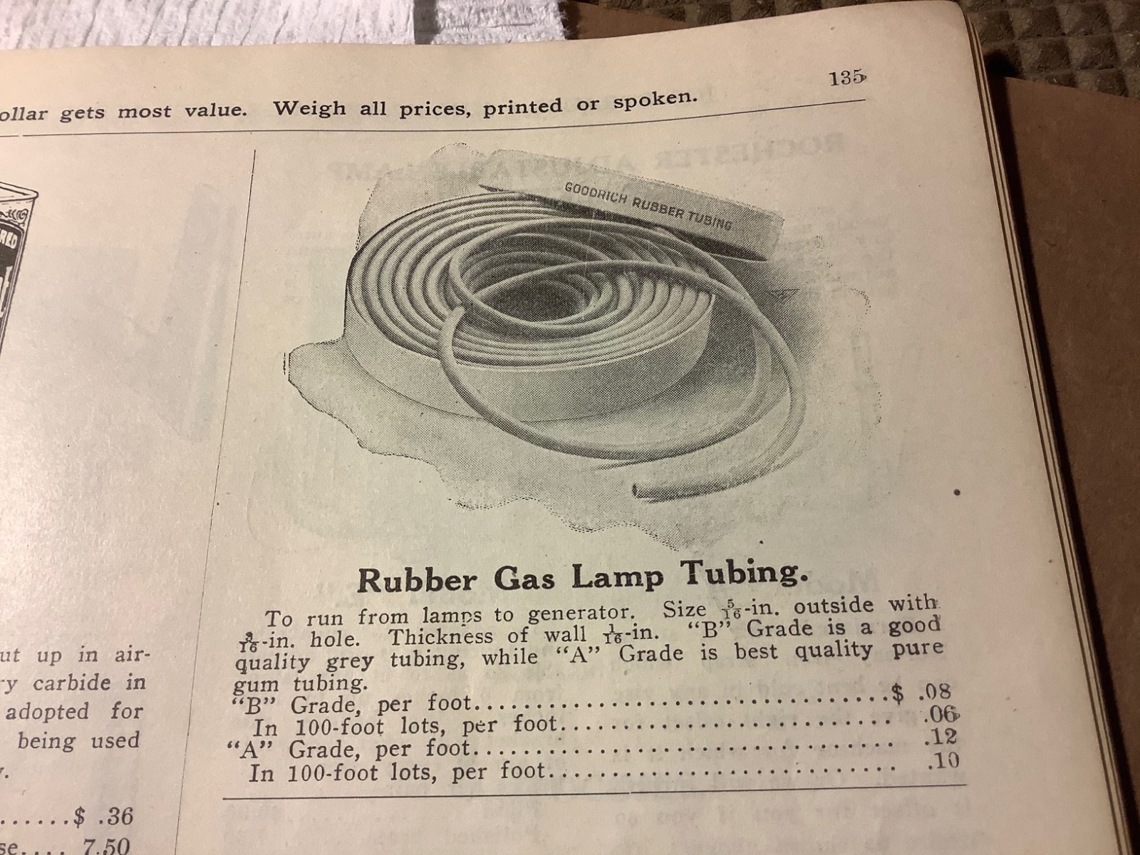

Every couple of years this quest for original red acetylene hose pops up. I don’t believe red acetylene hose ever was used on early cars up to the 1913-4 models. Over many years, I’ve had many original artifacts come through my hands, and every once in awhile, there is a bit of old hose still attached. Petrified and mummified but was obviously a white or cream color rubber tube. Out in the weather, over time, this gum rubber swells, cracks and generally just goes bad. Sometimes I’ll find a piece still attached that also has a piece of fine wire, or even bailing wire holding it on. This was an owner fix when the hose started going bad, and swelling.
Searching through my very old supply catalogs, I come up with only one listing, shown below. Gum rubber tubing. I believe this is what early autos were supplied with originally. Stop and think. On the assembly line, would Henry have used a rubber hose , that could just be pushed onto the nibs by hand? Or would he use red plumbers tank acetylene hose that needs to be attached with clamps. This red hose Larry seeks is way too heavy duty, and made for hard use ( on a plumbers tank, for instance) that can be used, wound up, used again, skuffed around. Plumbers tanks use higher pressure appliances than any lamp ever used. I’ll say it again. Lamps use VERY low pressure. The type of pressure that soft rubber tubing can hold by itself on a bib fitting, no clamp. It’s hardly ever shown in the catalogs of the day, likely because it was a common hardware store item, easily bought when your ford hose started failing. My other picture is shown gum rubber tubing, available in many sizes, even the size Original Smith seeks. It’s pretty cheap. I’m showing new hose next to some delicate vintage gum rubber that still has some life in it. Available in many sizes from McMaster-Carr supply. If you agree, I’d grab it soon, as they just started carrying it again, after not having it for many years. The picture showing the two hoses is of old coin operated machines, with hearing tubes, made in the same period as our old cars. JMHO

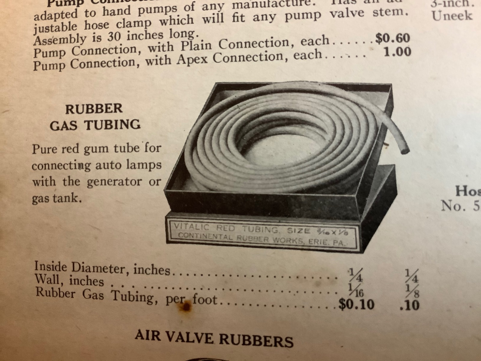

Here is another period ad, gum rubber acetylene lamp hose. 1925 catalog. This in red. By then they were starting to add compounds to increase the longevity, black in tires, red in hoses. I’ve put this out there, mr. Original, any rebuttal archival evidence that FoRd used acetylene welding hose originally? fWIW, McMaster-Carr has gum rubber, in the right size, Available in red, along with the natural color. I’ve got a sample on the way.

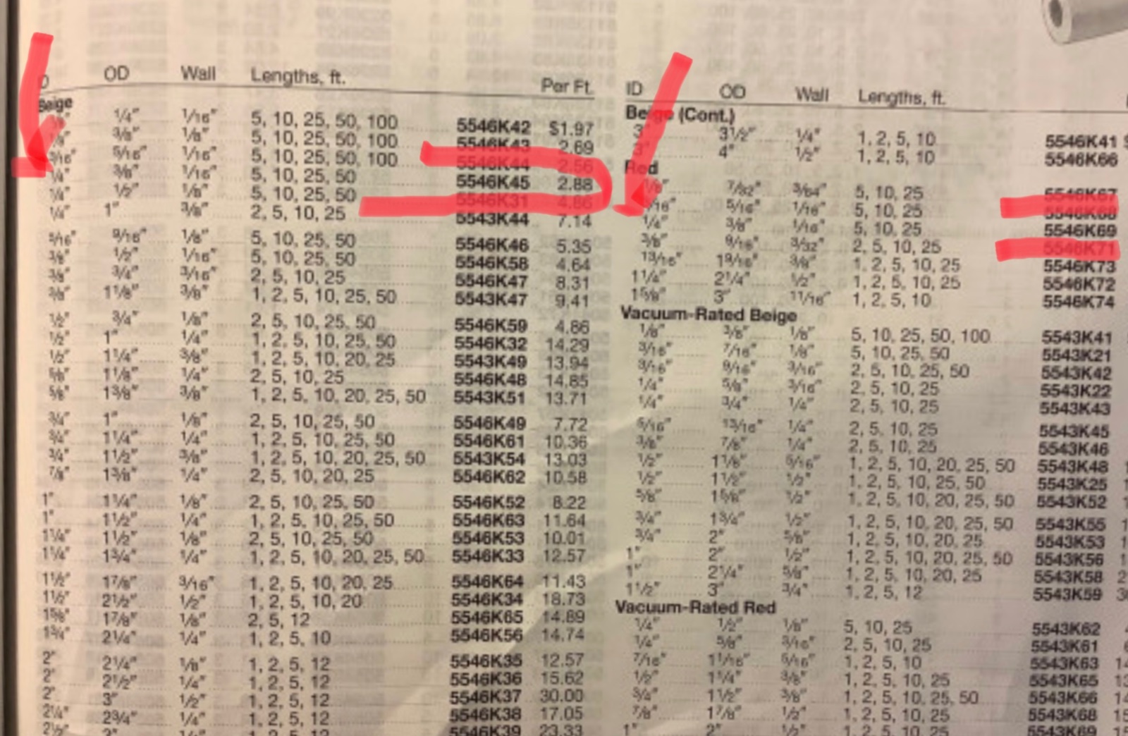

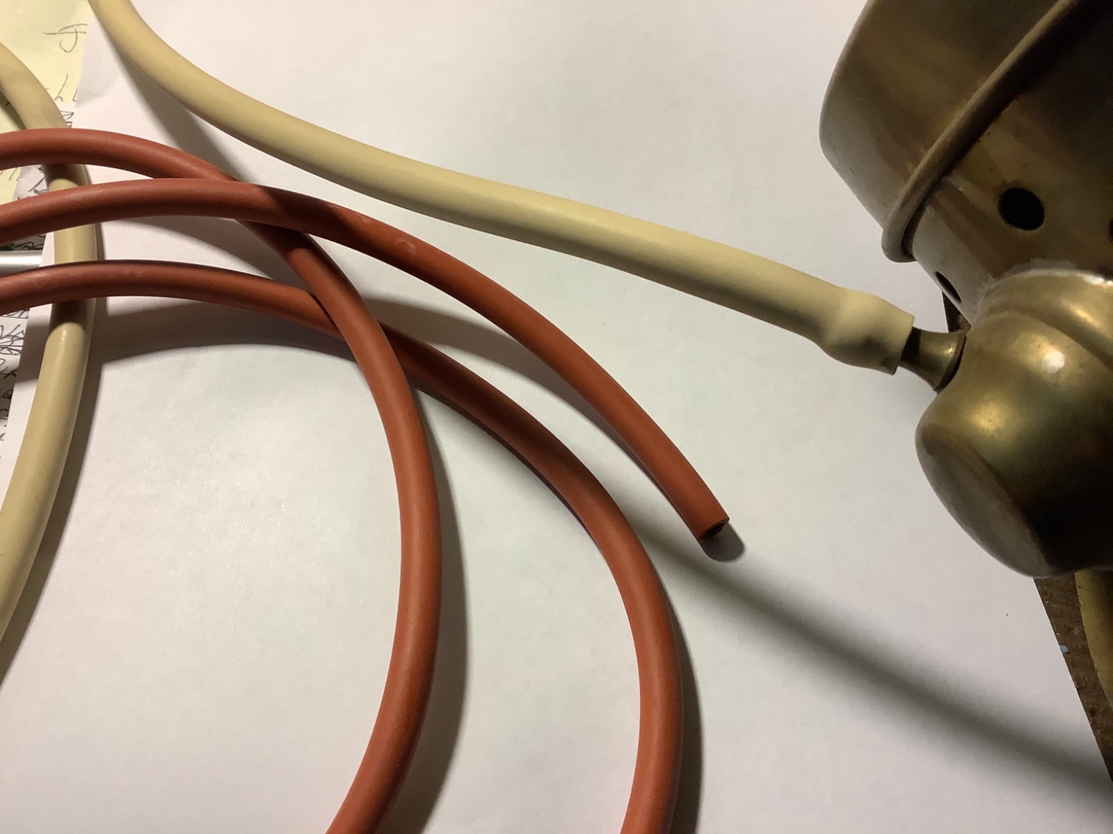

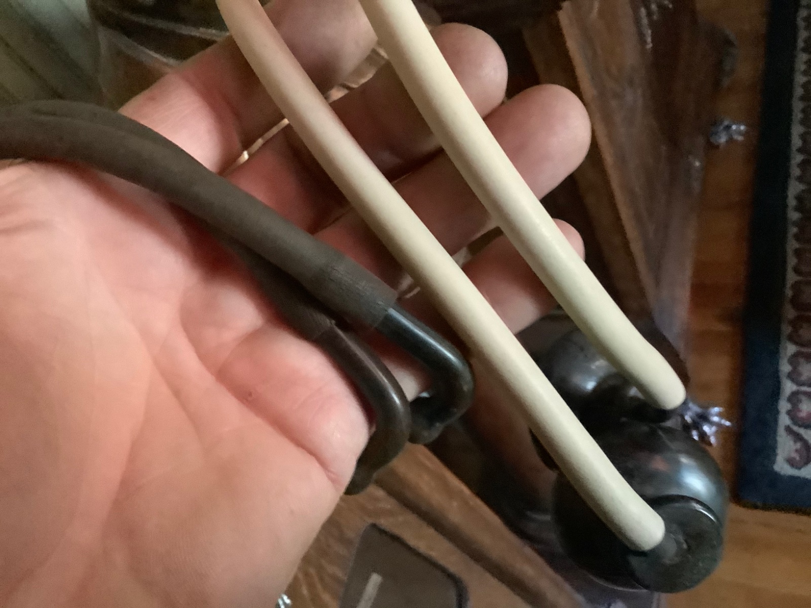

The off white is $2.88/ft. The red is $2.80/ft. The red shown is shown for color, it’s a different size that I’m using for something else.

I agree with Tim on the off white hose. I have seen it still attached to old burner elbows.

Art, here is the McMaster-Carr parts numbers. If you read up on the history of rubber, they started experimenting with adding material to change the durability of rubber very early on. From the original bits of it I’ve seen over the years, it’s swollen so much from age that a lot of 1/8” wall stuff was used back then, too. It would be my educated guess that white hose would be appropriate for very early cars, the red for later gaslight use. A personal choice, I would think, also. If anyone around here wants some, I’d be glad to order it in. ( original Smith is taking donations of used acetylene hose)

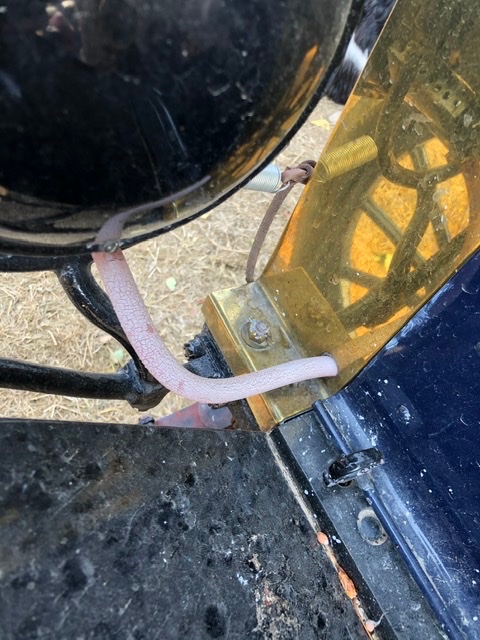

I re-plumbed the acetylene lines on Lizzie after she adopted me, using the red rubber hose with a cloth outside pattern that Lang's offered at the time. After four summers spent mostly outside, it needs replacing. I wonder how well the original hose held up ? Any historical accounts of that ?

Rich, I’ve had original gum rubber tube inside on coin op machines for 25+ years now. Inside, air conditi9ned, out of the sun. I’d say it would last a lifetime kept like that. For on an old auto, my guess would be that you’d get several years out of it, depending on use and storage conditions, of course. Ozone is the killer, it will start getting a hard skin that dries out and starts cracking, even though the inside will still be supple enough to hold the pressure we are talking about. Keep in mind, it’s offered in two different wall thickness , 1/16 and 1/8. I’ve seen more original bits on burners and such that appear they were probably 1/8 wall, and swollen pretty huge.

I did get the 1/4 ID X 3/8 OD with the 1/16 wall from McMaster-Carr and it seems like the 1/16 wall is too thin. I would think the 1/4 X 1/2 with the 1X8 wall would be better. What do you guys think? Art
