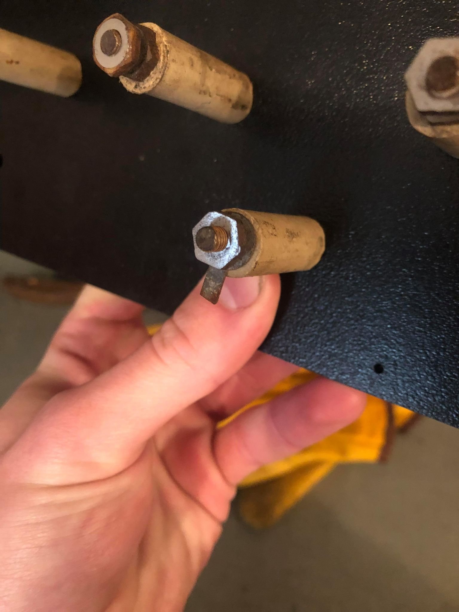

In the meantime, I have my coil box and 8 coils on hand that I want to go through and get a better understanding of. I've studied the circuitry over and over, and I'm finally starting to understand the function of the internals. Part of me wants to open up one of my coils just to see and feel all the internals to fully grasp what's going on.
I'd like to keep the coil box as weary and battered looking as possible, which involved keeping the original wood. Is there any risk of losing the functionality in the coils with old wood and the old box? I just see there are modern plastic reproductions. I'm guessing the risk is the wood getting wood, and then making contact with the brass terminals? I don't plan to get stuck in the rain, but that's happened to me in my Model A several times now, and I'd hate to do damage to a fairly exposed coil box if that were to be the case. Early Ford's that had no top could have been susceptible to the same conditions. Does anyone have experience with a rained on coil box, and the damage that it can do?
I took one of these guys off the back as well for curiosity.
Any need for replacing of the coil box tubes? Or do they provide a more important role that I'm unaware of?
In my head, a proper rebuild (in addition to the coils themselves) would be replacing the bottom contact strip, the back 8 contacts, and the coil box bolts and nuts, just to ensure proper conductivity?
Thanks in advance!

You want a T that runs. I would recommend replacing the wood in that cool box with the plastic kit. Using that old wood will just give you problems down the road. However, keep all the other parts. They are just fine and the flexible strips inside the box are most likely the correct metal to make your coils work correctly. Just clean them up a little.

What wasn't mentioned is that the wood, even without getting wet, can develop carbon traces that short out the coils. Once assembled on a car, you can't hardly see the coil box wood, so use the modern kits. The contact strips are phosphor bronze, while some of the replacements aren't, so this is a situation where the original parts are often best.

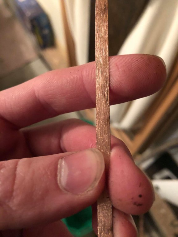

I've spent the last week going through the circuitry and science of the coils themselves. Boy, the amount of classic physics that I had to draw back on was a lot, but I finally had that eureka moment. Very happy that things clicked for me. I'd like to pull one of my coils apart for the winter and see the magic with my eyes. I still love the charm of the opening and closing of the primary circuit with the sparks on the top hardware. So cool.
A Model T guy I met earlier in the year had the mantra of "not understanding the science is when trouble begins to happen", and I've tried to apply that to my old car journey ever since.
I'd love to have a rebuilt and functioning coil box, as that is one of the things I can really do while I don't have access to a car assembly space. I can't imagine there's much to go wrong with a box sitting idle, is there? Not like I'd have to rebuild it again. I'm (hopefully correctly!) going on the assumption that it would be built right the first time, or at least in time to install on the car.

Allen has a point. The original wood was a form of plywood (pieces of wood held together with dovetail tongue& grove joint(s) with a veneer glued to the front and back). The backs and bottoms may be warped and the veneer separates - if you decide to keep it coat with Minwax wood harder to water proof it. Your tubes, bolts and contacts look good. You need to get the fiber washers and new nuts (not worth the trouble cleaning the old nuts unless they are brass). If you replace the wood the waterproof kit is the way to go. Your coils are likely in need of $ome attention.

Thanks everyone for the input. I actually was unaware that there was a modern wood replacement. I've since bought the modern plastic, and finally went about disassembling it tonight. Boy, that would is actually quite brittle and rotten. I would've had to replace it anyways, so I'm glad I splurged and bought my plastic repair kit. With buying that, I almost doubled my entire investment in my T!
Regarding the conductivity of the bolts, contacts and contact strip. Is there any harm in letting it sit in a rust remover solution? Everything just has minor rust around some of the threads. There is really no serious damage anywhere. I can't imagine soaking in a solution would cause any detriment. I'm just wondering if people swear by the hand polishing/emery cloth method and why.

Not sure what your bolts are made of. May be brass or copper coated and had steel nuts. In any case if i ts minor rust I just use a wire brush on a drill or dremmil tool. If yousoak them < 1/2 hour is all that's needed and then you still may need to brush off the residueryanf1023 wrote: ↑Wed Sep 02, 2020 11:27 pm.......

I bought the resin kit and it made a big difference. My original box was pretty rotten as well.
I just wire brushed the contact areas with a little Dremel tool wire wheel and left the rest alone.

when I rebuilt my coil box, i used new bolts and nuts and put silicone greece in between all electrical connections. also, I used a wire wheel and a buffer wheel to clean up those brass contacts.

The old insulators virtually disintegrated when I took the nuts off the porcelain. I almost forgot about them until I was using emery cloth to clean the nuts, until I unintentionally disintegrated one on the cloth. Are these things I need to replace?

- Posts: 6790
Re: Basket Case Speedster Build Thread
Ryan, both the battery and magneto connections are soldered to the strip in the bottom of the coilbox. From there the wires follow a groove in the underside of the base timber/plastic. These grooves meet with corresponding groves on the inside of the back panel, and the wire follows that groove to the terminal bolt. The little terminal you have is likely used on one of those. The same effect can be had by soldering the wire directly to the bolt head.
The porcelains can be quite fragile, and may well have been cracked before you started working on them. The earlier glazed ones were more robust. I have 14 later ones put aside to select 10 good ones for a box on which I am presently working.

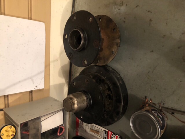

I've dug deep into the wheels. I finally removed the final two felloes from the rims, after having some help remove two tires yesterday. I was prepared for a whole lot of wrestling with the old rubber, but was pleasantly surprised with how quick we got them off. I'm less apprehensive about having non-demountables than I initially was.
I need to go through the rim edges to straighten them. New hardware must be replaced or remade, and whatever preparations are needed for the wheelwright. I'm trying to preserve the patinaed look as best as I can.
The magneto was finished earlier this month. It was a lot of work, I made many mistakes which had to be rectified, but I'm glad to say that I rebuilt it and that it's finished.
