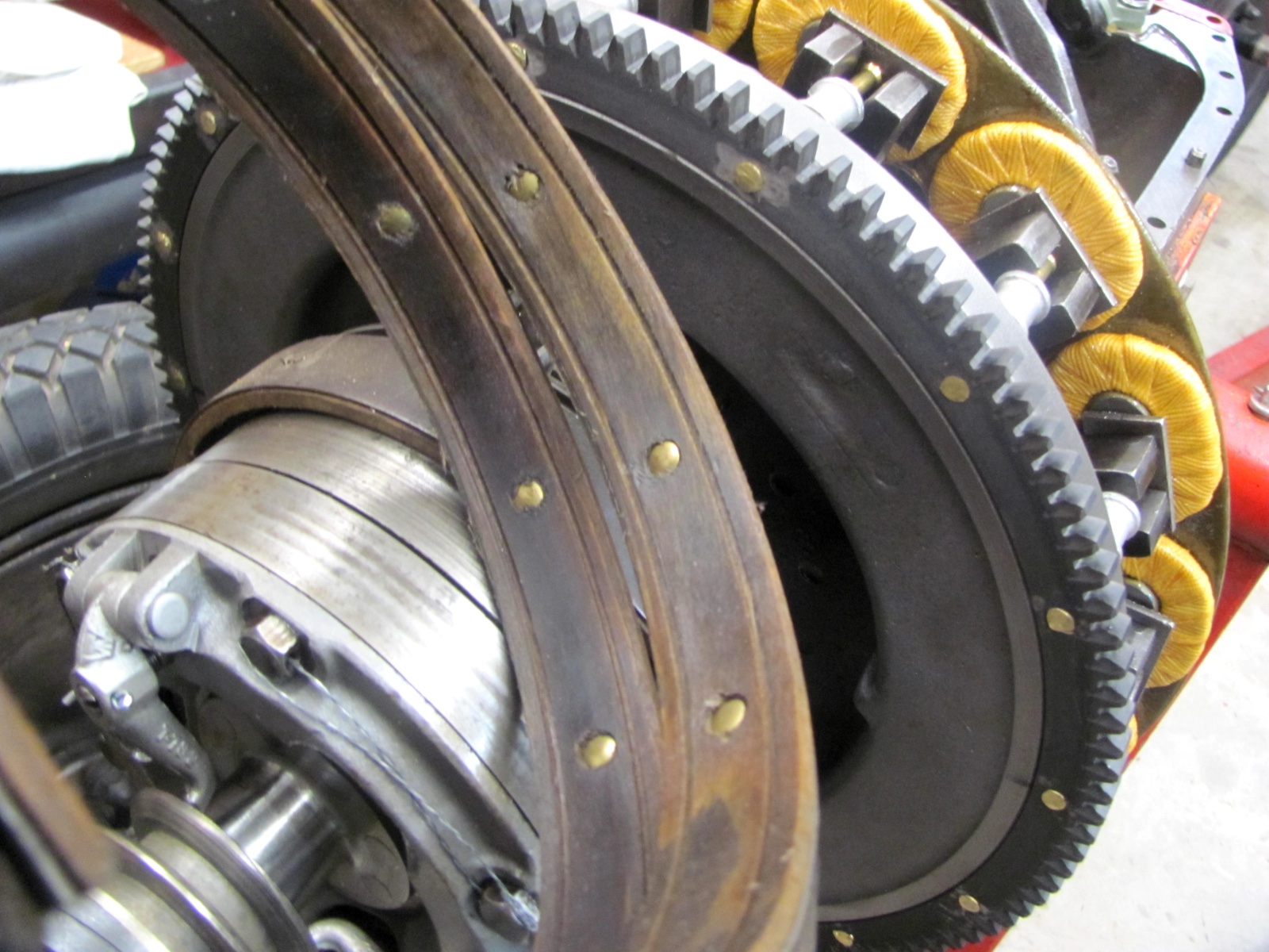

Those aftermarket wood linings were likely segmented as the wood pieces weren't made well like Guinn Wood linings. His linings are full round and easy to place on the band. Cutting his linings seems poor idea.
Experience for me with wood is that the lining is needed for the full contact. You can see these are worn, low band lining in center, and lots of wear at the bottom and sides on that band.
a famous brand of wood linings, these are full circle like today's Guinn.

Post by dhosh » Thu Aug 20, 2020 8:11 pm
Dan ....
Sounds like good advice to me! Yes... Mine are Guinns, as well.
We're all 3 of those bands mounted at the same time? How long were they in? I would have expected the brake the to be the most worn.
Thanks!

Posts: 4046
Re: cutting wood bands
Post by DanTreace » Thu Aug 20, 2020 8:41 pm
Dennis
That wood brake lining wasn't worn as the Rocky Mtn. brakes do the yeoman's stopping work. The low lining wore a lot when the oil got down, and slipped the band. A bit of charred wood shards in the oil screen. Still ran those linings for additional 1500 miles or so. Total on these was approx. 8000 miles.
Yes, give the wood linings a tad of overhang so you don't have band metal or end of a band ear hitting on the drum surface. Some demountable ears overhang more than others, so fit the lining to the bands and ears.

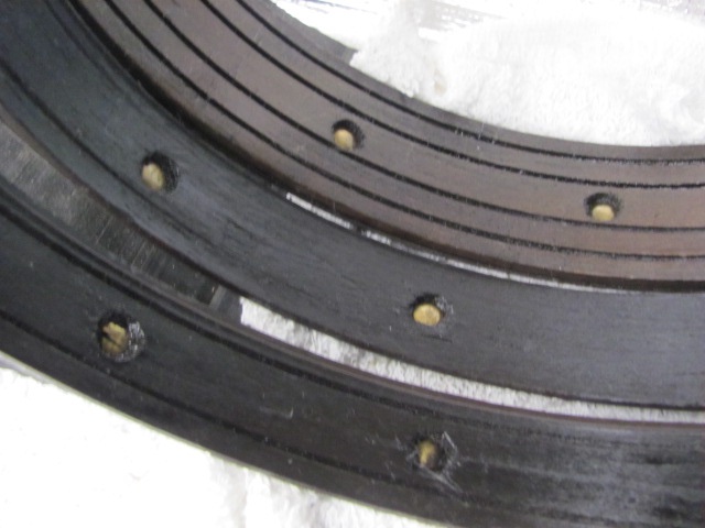

Used regular band lining brass split rivets, sunk the head into the wood with a counterbore wood bit. Tangs spread on the backside of the metal band.
Do know that Jim sold lined ones at Chickasha, and these have split rivets. Guess they are brass, any way that is what I have used.
These were used slightly so went back in a '24 engine had rebuilt for a runabout I sold a while back.
New Guinn linings on bands
