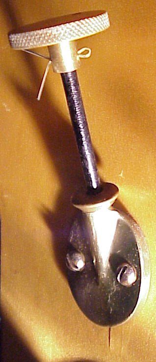

I used the mixture control rod to go through the firewall just enlarged the hole in the 1915 dash and made a tube over the mixture rod and a second brass knob.

Here is the motor side. Hopefully the photo will load, sometimes they don't for what ever reason
If not email me and I will send it to you direct.
