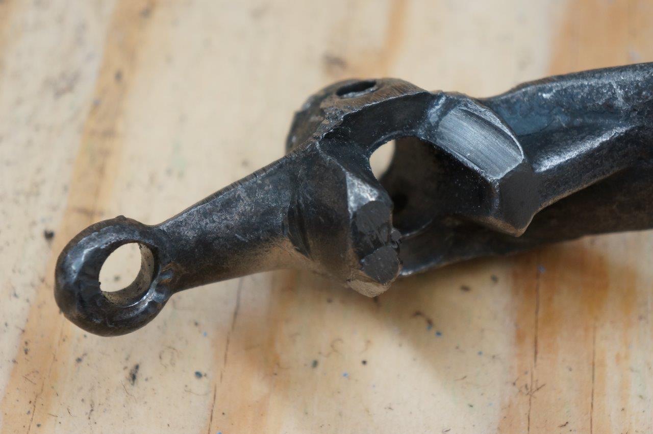

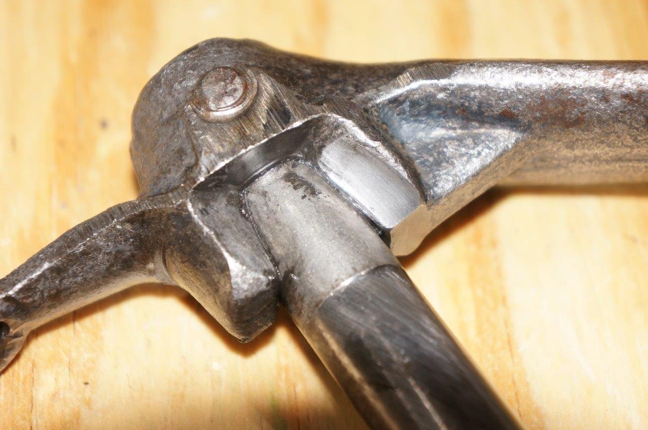

The clutch pedal on my 26 has excessive wear on the cam. I'm building up the surface with weld and then filing it to shape.
Does anyone know what the ramp angle should be on these cams?
The photos are as found when removed from the hogshead.

I’m thinking the cam angle on the clutch pedal would the same angle that’s on the notch that’s attached to the transmission cover. Only opposite.
The cam on the pedal mates up against the notch angle when it’s compressed together.
In other words the correct angle for the pedal cam would the angle that’s on the notch assuming both cams are not worn.
I think I would install a new notch while you have the cover off if your wanting to get good clutch action.
Others might have a different idea about the angle.

Odds are pretty good that it’s not really worn. The clutch cams are supposed to have additional play. That’s what allows you to push the pedal partially in to actuate the clutch without engaging low band. The cams are also internal and run in a constant oil bath. Usually they aren’t too worn.
If you get rid of the play you will never have neutral at the pedal, only with the hand brake lever...

It's a right hand drive hogshead, hence the greater wear, since the cam is on the outside. This pic of mine shows the cam arrangement.

When I do this job I start with a new bolt on ramp. The pedal should be removed from the shaft to have its ramps built up with weld. Then the fitting begins! Some bearing blue is your best friend. Once the welds have been roughed back, the pedal is fitted to the shaft, with no pin at this stage. fit the new ramp to the hogshead and blue its surfaces. Slide the pedal into place and work it on the ramp. The blue will show the high spots that need dressing down. The ramp is a spiral, and it will take considerable time to get the new welded surface mated with the ramp surface. Each time you have to work on the pedal ramps the pedal has to come off the shaft. I cheat a bit here, leaving a used and ever so lightly undersized shaft in place in the hogshead as a pilot for the pedal.
Once you have the two faces mated to one another, you still need to check that you have play in the pedal that allows you to hold a neutral with your foot. There should be approximately 1.5" of free pedal travel before it starts ramping. On my first attempt at this rebuild, in ignorance, I took out all the free play and had no neutral.
Hope this helps.

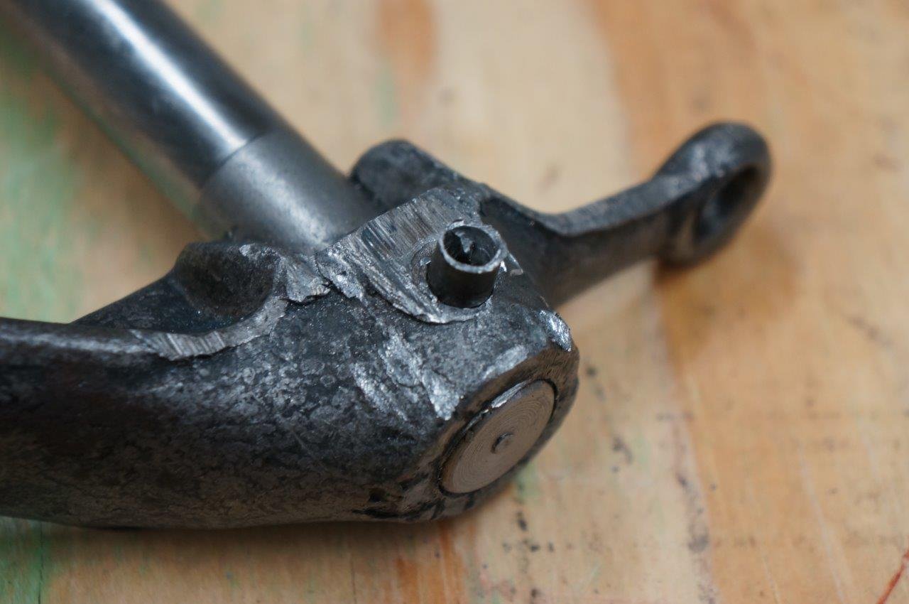

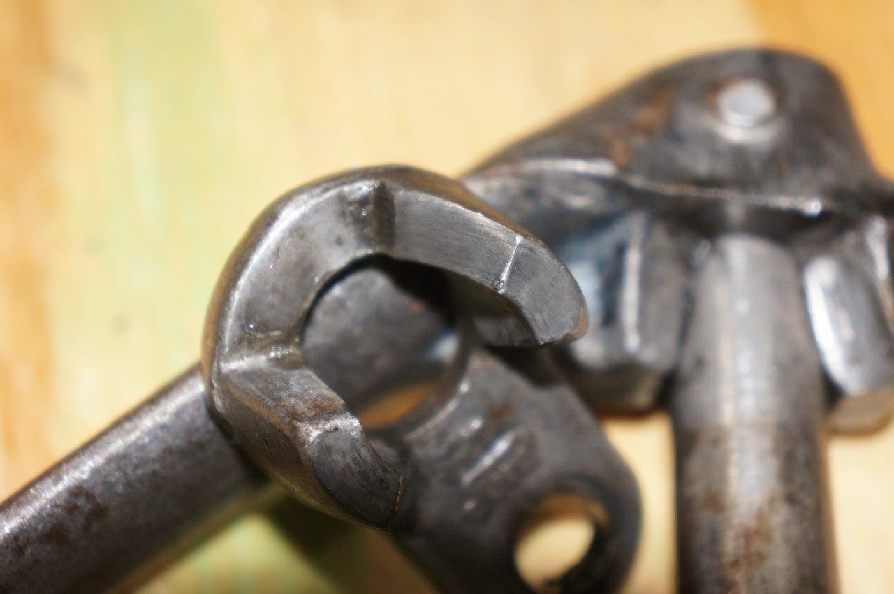

Here is a clearer photo showing the cam wear. The hole for the linkage is also a bit worn so I’ll have to deal with that as well.
She’s had a hard life.

The clevis hole is an easy fix. Clean it back to bare metal and bronze the hole up completely. Then re-drill a standard size hole through the bronze. Chances are you will then have a bronze bush in the hole.

If possible it might help if you had a better clutch pedal but that’s not something that can always be found.
Just thinking about it but if the suppliers can make the brake and reverse notches the clutch pedal pedal cam can be made also. They could be made just long enough to be welded on the existing pedal. Cut off the old worn end and then weld on the new cam.

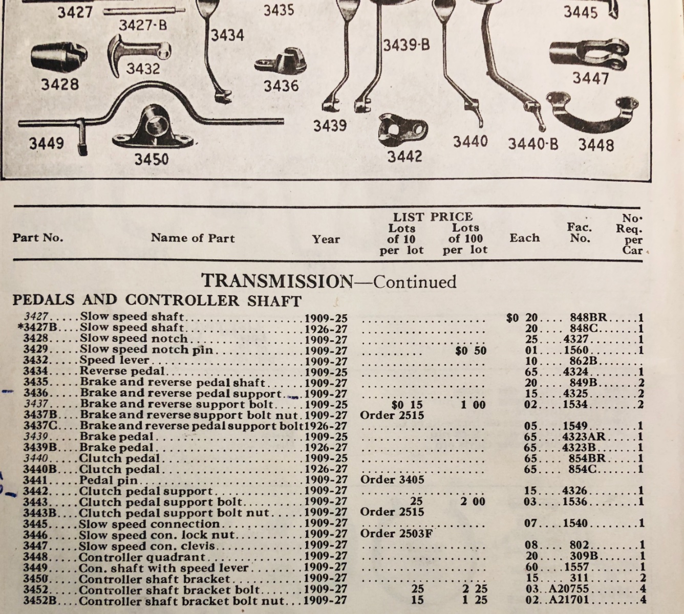

Here is the mail order form, right now due to pandemic, there is a delay in receipt as only a few staff are there. Note, you must use the "Factory Number" for parts, not the normal part number in Parts and Price books. The Fac .No. is shown in the far right columns in Price List of Parts.
Just Google 'The Henry Ford part drawings', and the home page of the details is there, below is the link to the mail order form.
https://www.thehenryford.org/documents/ ... f?sfvrsn=6

Thanks for the two pieces of information. How to find the factory number was the piece that I was missing. I see that the Model Aers have an online search index, I wonder what it would take to get the T index online or even better, the DWG online to purchase? I think I will broach that with the HF and see if I can get some interest.
