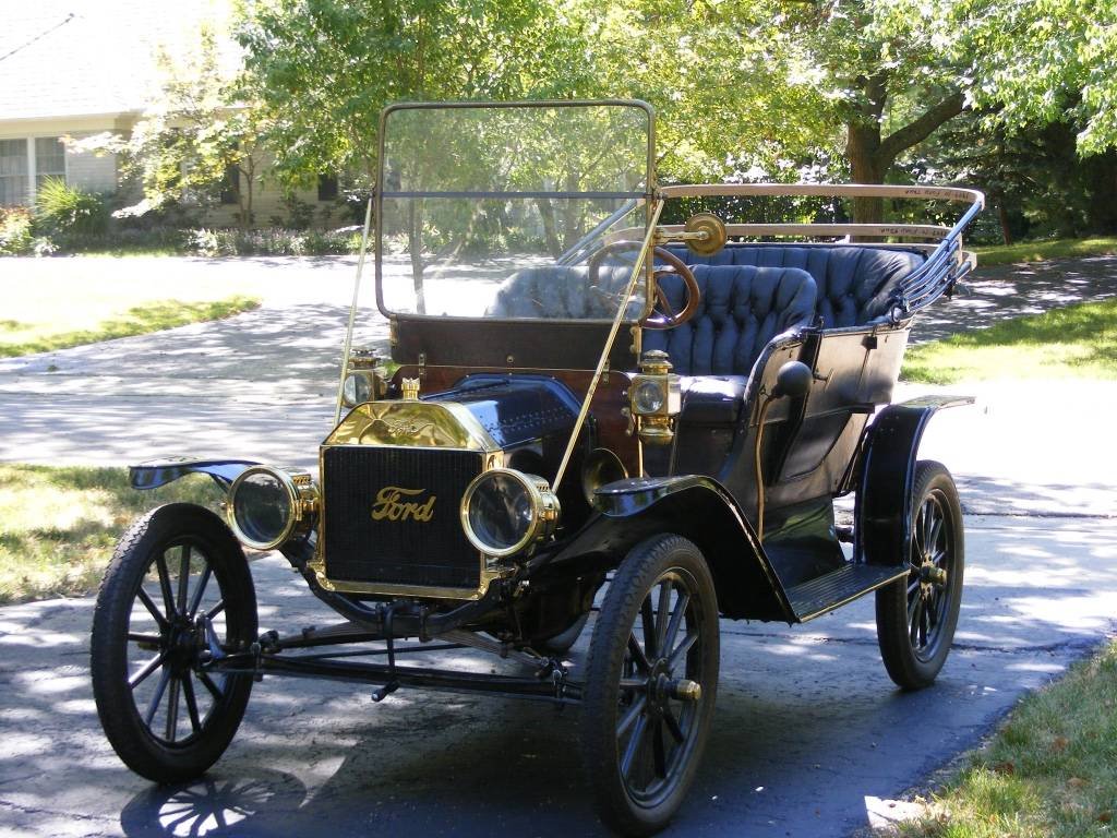

My wife saw this one and I know how much everyone likes to look at pictures so check it out.

The body looks like it may be an original? The front axle is 1911 or later. Beyond that? I can't say.
I should add that it looks really nice and like someone is trying to make it better. All in all, I do like it!

I believe this automobile was on Craigslist a couple of weeks ago. Thinking it was in Kansas City. Later axels and motor, but a Pontiac aluminum body. I’m thinking he said the lamps are repos, but still what a find.

I think I see three rivets / bolts under the rear door. Wouldn’t that make it a 10?

Three bolts on the rear half of the body was from the beginning of model Ts. It was the front bracket that had only two bolts only in 1909 for touring cars, roadsters had the two bolt brackets in the front brackets until sometime in early 1910. If you zoom in on a couple of these pictures, you can see that the front brackets are the two bolt ones, indicating that the body at least may be an actual 1909. However, I don't think much else is actual 1909.

BTW, the historical plate on it says Minnesota so perhaps this wan't the one on Craigslist.

A Minnesota Collector license plate would be an incorrect Minnesota registration for that car.
Minnesota Collector plates are issued to motor vehicles that are at least 20 years old and manufactured after 1935.
It should be registered with a Minnesota Pioneer license plate which are for motor vehicles manufactured prior to 1936.

I saved these pictures from Craigslist after my wife found it. Wish it had been closer. The add did say it had an aluminum body and looking in Bruce's book I see those were only built in 1909. Seller said he thought the paint on the body was original which is hard to believe but when was the last time you saw a 1909 Touring for sale?

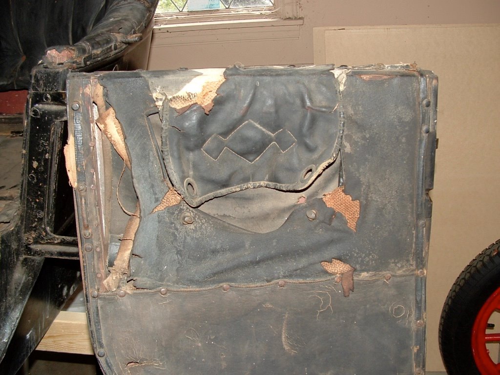

Some more pictures the seller sent to me that were never posted.

This car has a known history back to 1935. It has a 1916 engine and later axles including a 1911/12 style 12 rivet clamshell rear end. The body is stamped with B B 194 X which I need to confirm when I am feeling better and can check. It has the aluminum body and some of its original parts but that's OK because this is going to be a driver and will be used on tours and just driven. If it had been 100% correct it would be hard to justify driving it 100+ miles a day with the open valves and the chance of engine failure damaging an early 09 block. I would rather drive and enjoy the car than to leave it in the garage and just show everyone pictures and say I have one. Car shows are nice but only so many a year before it gets old. I want to feel the wind in my hair while I still have hair. :D
