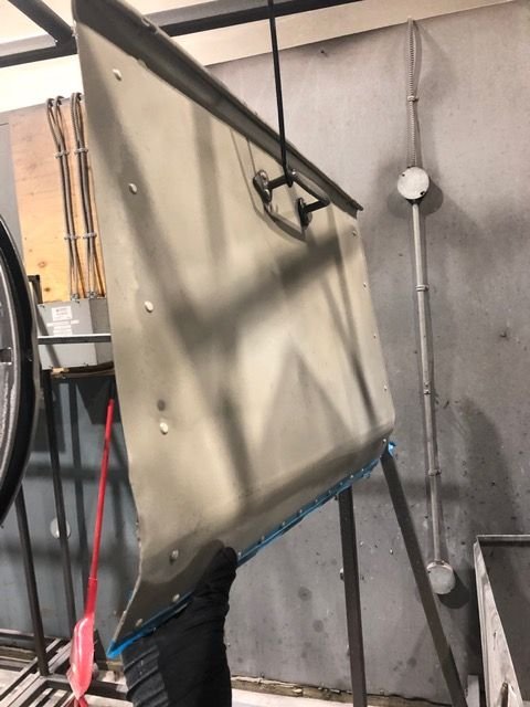

Starting to prepare and power coating some parts for my 1914 speedster
Super Mario Bross ;)

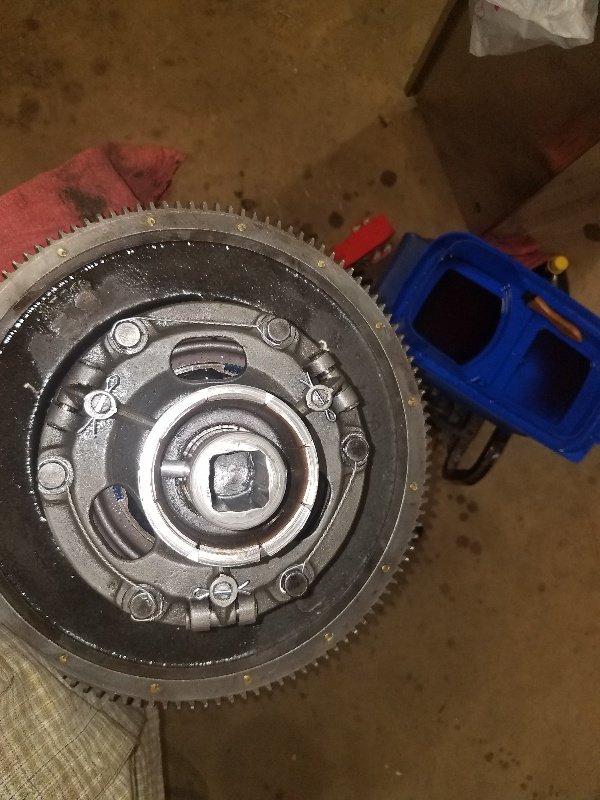

Starting to see the light at the end of the tunnel on my trans rebuild... Balanced the triple gears, and mounted. Ready for the clutch plates!

My local T friend and I redid the valves in my T.
It had been running rough ever since I broke a valve head last year. I replaced some valves but didn’t get enough clearance
Number 1 was 55 pounds, number 2 was 25, Number 3 was 25 and number 4 was ZERO.
Unbelievably, the car ran and drove...warped the hell out of them. We had to sink the number three exhaust to get the seat to clean up enough that if it goes out again, it’ll have to have an insert cut into it
And before anyone says anything...there are no two piece intakes in it any more. I took them out too
