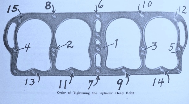

Your engine should be just fine now with a new head gasket. My '27 is .060 and ran a Z head, no issues, but got a Prus head and put that on, with a new gasket and runs super.
Just a note on gasket install, all the other postings are correct on having the bolt holes clean, etc. Use Copper Coat or equiv. heavy metallic content Alum spray paint and coat the gasket. Fit the gasket with #4 and #1 @ TDC, to be sure the gasket is aligned.
Then run down the head bolts. Finally do the torque sequence shown, very important to torque first all the center bolts, as that is where the cylinder walls and the gasket is thinnest. Doing the squish there first is necessary, then go outboard and finish at the ends of the cylinder head.
IMG_2510 (1280x960) (530x398).jpg (105.58 KiB) Viewed 2388 times
Between the cylinders in the center is where most times the gasket goes.
