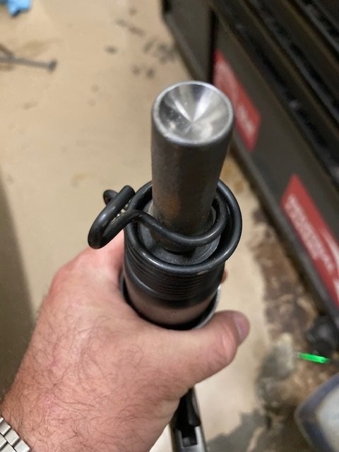

Re: Air Hammer Spring too tight, now too loose for 1/4 bucking bar.
So my original Air Hammer retaining spring was too tight for a 1/4 bucking bar. I bent it to fit and now it is too loose, see picture. The bucking bar goes flying. Should I try to bend it again to fit better or does anyone sell them to the right size? I looked but didn't find one. I have 2 original retaining springs and they both are the same size. They start out too tight for a 1/4 bucking bar.

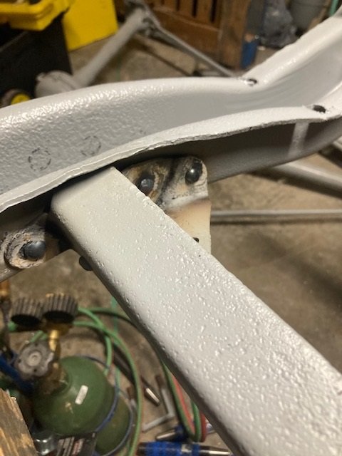

Okay I think I have this. The key was per suggestion you put the air hammer on the rivet so it won't eject the bucking bar. I also focused the torch on the shaft that is showing not the head to get it good and hot. The running board hangers are half on now with the top rivets in. Looks pretty good I think in picture 2. It is much faster with an air hammer bucking bar.

If you are going to use the stock starter push switch mounting location I hope you didn't  rivet the top strap to the frame. It looks like it got riveted in your picture but I can't tell for sure. The switch mounts with one hole going under the brace strap on the driver's side (USA) front  running board bracket and takes a bolt and castle nut.
The frame has a hole drilled for the other mounting hole of the two in the switch. You can mount the switch someplace more convenient for your speedster's use if need be.

Good eye yes it is riveted. I can cut it off if necessary.
						kmatt2 wrote: ↑Sat Nov 28, 2020 2:05 pmIf you are going to use the stock starter push switch mounting location I hope you didn't rivet the top strap to the frame. It looks like it got riveted in your picture but I can't tell for sure. The switch mounts with one hole going under the brace strap on the driver's side (USA) front running board bracket and takes a bolt and castle nut.

I did not cut any of the rivets because they are supposed to expand into the hole when heated and driven. They form a nice dome when done correctly even if it sticks up a lot at first. I purchased bolts and nuts in various sizes for the spots that my jack is too big for.

Re: Beginner frame riveting.
I picked up this one from Northern Tool for $49.95. It looks superior in every way. It has a quick change chuck, comes with 3 end tools and actually works every time.
So I was almost out of oxy-acetylene so I setup four to do all at once. A problem has been that they have a tendency to lay over somewhat off center. Is that okay?
