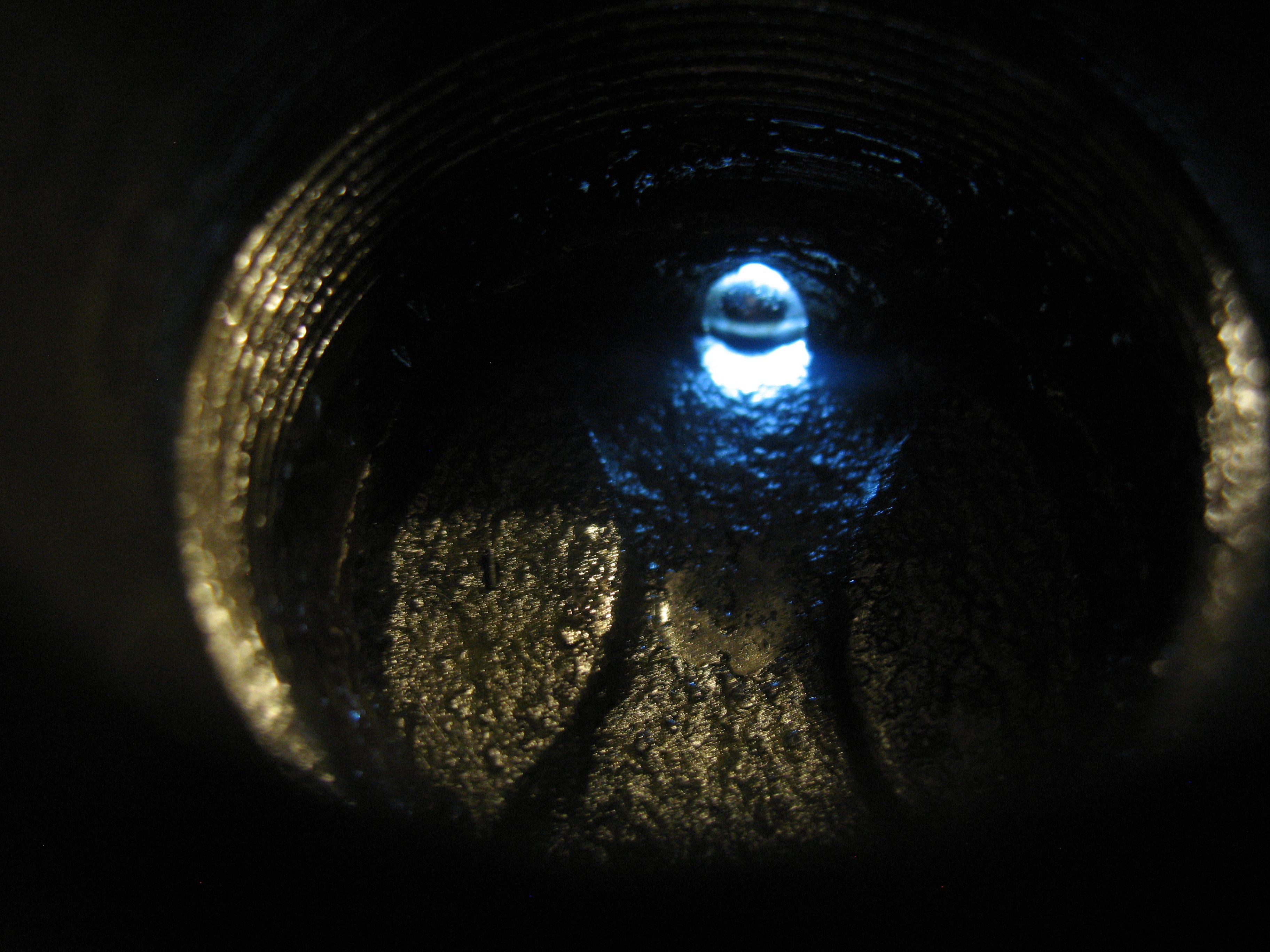

It's a round ball in the base of the pump just below the hose that seats there, and is "trapped" by staking into it's "cage". The schrader valve wouldn't work as a check valve as you have the hose involved, as well as the schrader valve being held open by the nozzle, without the check valve you don't pump air. What it does is fill the pump cylinder from the tire.

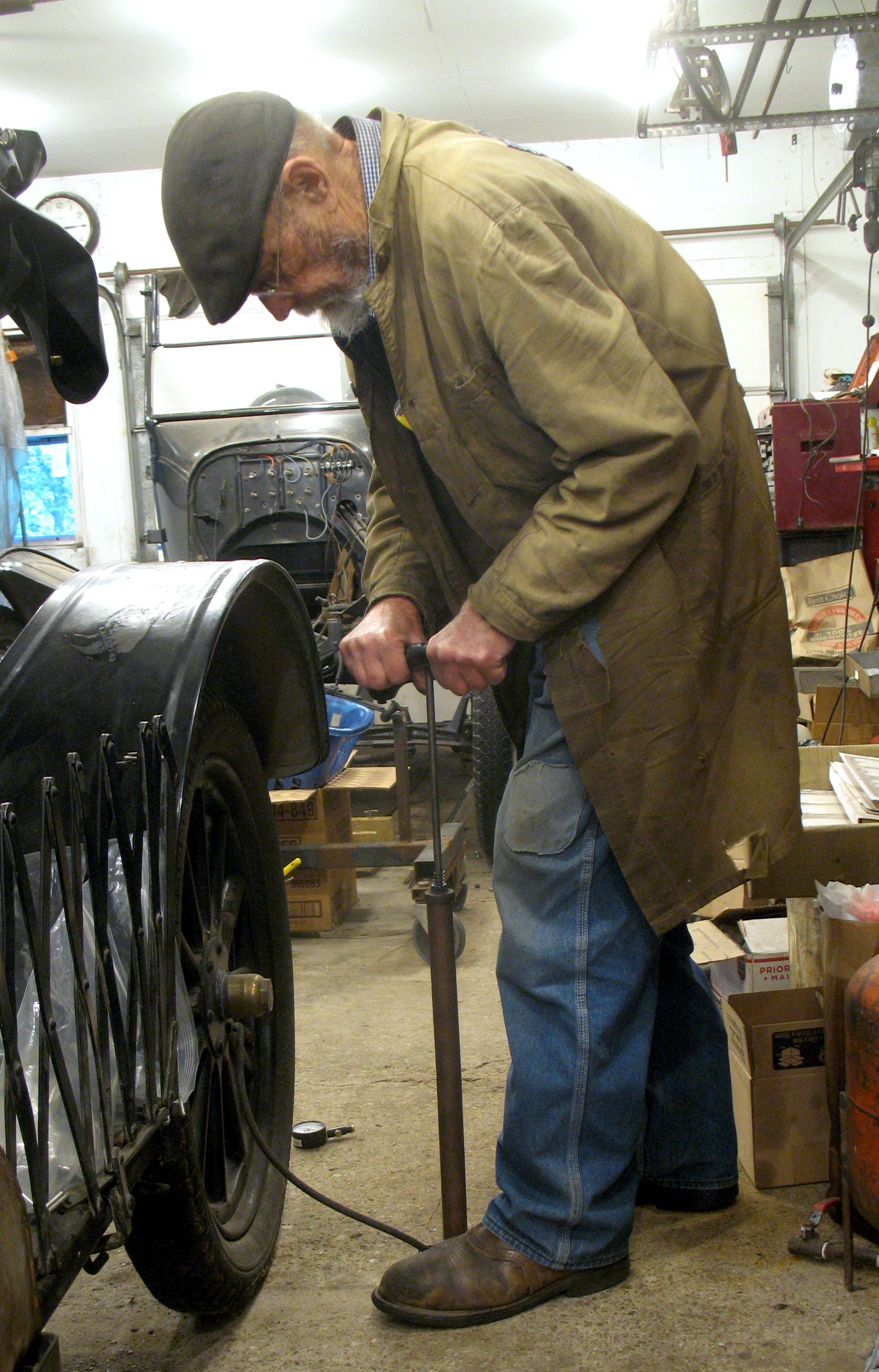

It works.
I hooked up the better of my two Ford pumps to a low tire and went to work. Being of the elderly persuasion I found the exertion challenging enough to take occasional breaks during the job. I started with the pressure at 5 psi and blew it up to 72 psi (had to let out a little air at the end).
The secret is removing the center post from the modern connector so the check valve is the one in the valve stem. There's no need to blow $33.50 plus shipping for an external check valve. The one in the stem does the job.
I believe the brass pump is a very good reproduction except for the modern coupler that made it useless.
The base is slightly thicker and rougher than the one on a real Ford pump, and has no markings on the bottom. The hose is marked Made in Germany (not West Germany), so I'm guessing it was made in 1989 or later.
The ball bearing check valve theory is bogus. A ball will not seat in the air passage. Lang's catalogue is correct about Ford pumps not having a built-in check valve.

Maybe not in the brass cylinder one, but my Ford steel cylinder has a check valve in the base.
Topic author - Posts: 7344
Re: Ford tire pump: Check valve?
Is it marked T-1484? A-1484? My other ford pump is steel and has what looks like T-1484 on the bottom, though it's pretty faint. It has no check valve. I'll have to clean it up and see if a ball will seat.
