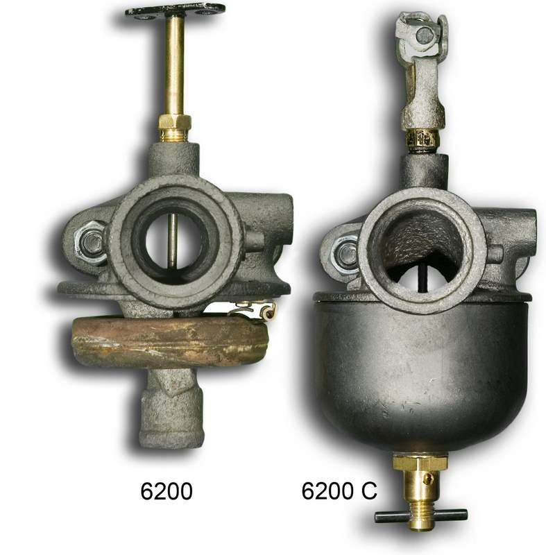

Can anyone help me identify an NH carburetor and what is the way to ID a straight through carb?
Is it as simple as being able to see through it? Or are there salient features from the side to look for?
Thanks,
Jim
Posts: 6821
Re: How to Identify a Straight Through NH carb?
Post by Scott_Conger » Wed Feb 20, 2019 11:09 pm
Straight through on left for both pictures:

None really .... all the same parts. Just make sure all the little chambers are clean and plugged properly.
Posts: 6821
Post by Scott_Conger » Thu Feb 21, 2019 10:36 am
They rebuild just like any other NH...no different parts or adjustment.
My opinion is that they will perform only slightly better than the more common sway-back NH, often with slightly harder starting and a greater propensity to spit a little fuel when starting and sometimes when shutting down. Not always, but many people report this. I ran one for awhile on our '13 and believe it was a little harder to start. On a car with a starter, this may be less noticeable.

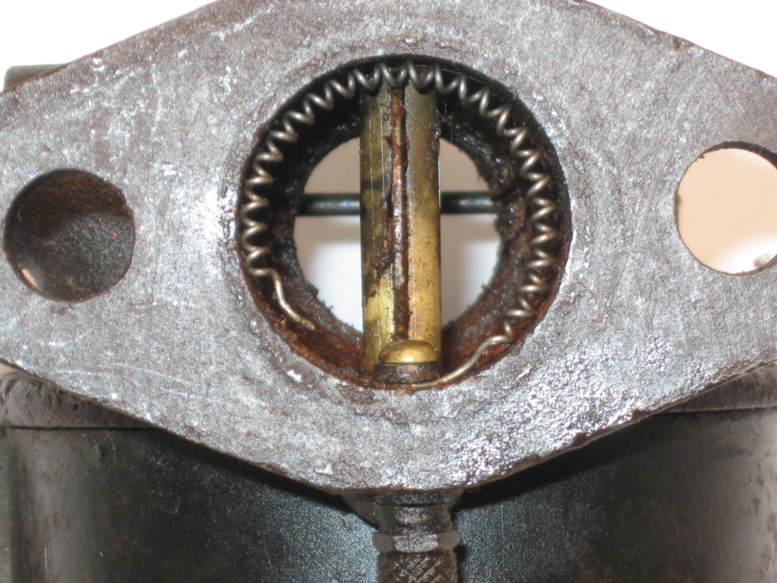

The one that you have listed on Ebay is not an NH, a straight-thru carburetor yes, but not an NH and not made by Holley. Either a Western Auto or Simmons Super-Power, both aftermarket. There would have been a wire heating element where the brass screw is filling in the hole. Does the carburetor that you have in the listing have the small pot metal flapper in it?
Fozz71
Posts: 288
Joined: Wed Jan 16, 2019 11:38 am
Last Name: Chochole
Location: Oswego, Illinois
Board Member Since: 2003
Post by Fozz71 » Fri Feb 22, 2019 9:39 pm
Where would this pot metal flapper be located at? Both butterflys are the standard steel and brass type so potmetal is gone, no wire has survived.
Pep C Strebeck
Posts: 650
Joined: Sun Jan 06, 2019 11:12 am
First Name: Joseph
Last Name: M
Location: MI
Post by Pep C Strebeck » Fri Feb 22, 2019 10:24 pm
The flapper would be located behind the choke butterfly and would mount/pivot on the small rod attached to the brass screw that can be seen in the photo below:
You can see the small rod (horizontal) in this photo. This would normally be behind the choke butterfly but that has been removed in this photo.
The flapper is supposed to help with low speed idle and make the carburetor run/operate smoother.
