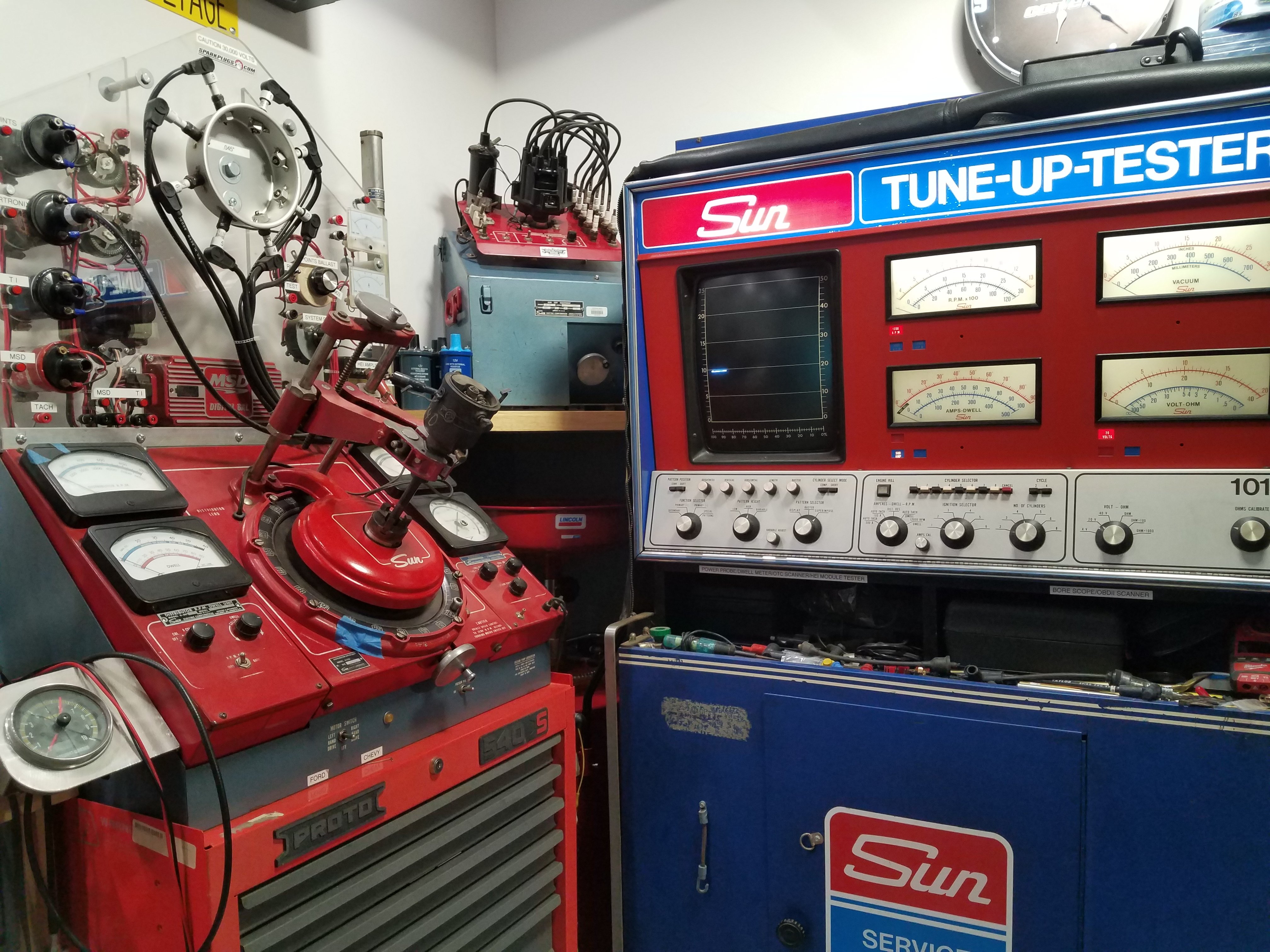

A ballast resistor is Not a voltage regulator, it is a Current limiter. A volt meter cannot pick up what is happening.
You need a scope to understand what is happening.[image] [/image]
The coil sees 12v, and as the magnetic field charges, the voltage drops.
When the points open, the field tries to collapse back to the points at approx 250 volts. The capacitor prevents this, sending the energy out the secondary winding.
The induced secondary voltage is regulated by the gap and combustion chamber pressure.
I only wish to explain the dynamics. Jeff

I have noticed that when people are trying to debug something electrical on their T they haul out their DIGITAL volt meter and try to take readings. Now they may or may not get anything meaningful. I try very hard to convince them to send me what they are reading using an analog meter but they then make a reading and give me 3 numerical digits which is just about impossible to get using an analog meter so they are just fibbing thinking it will get me to go somewhere else to find the problem. The problem isn't going to move or be found until you run a test that reveals what is going on. I had one fellow reading the 12V supply at the coil with engine running. I asked him to rev the motor and see if that voltage went up since he was also using an alternator and he said his analog meter read a steady 12V (at ALL RPMs) while his digital meter read -.1 0 volts. at all RPMs (YES a minus voltage of .01 VDC). No way to make any sense out of either reading since he clearly was not charging anything with anything and had no ability to make any reading that I could trust to be accurate. There are really good small analog meters for sale at several of the BIG BOX type stores around me and they are less than $15 but most people are convinced that their meter is fine for what they are doing. There is nothing wrong with digital meters other than they CANNOT be trusted once the engine on their Model T fires up since the coil itself and the unshielded plug wires and other components and poor grounding make it a noisy nest to make any sense out of.
- Posts: 455
- First Name: Jeffrey
- Last Name: Hausey
- Location: Anaheim, Ca.
Re: is a resistor needed in a 12 volt system
I still have my Simpson 260. Still my go to meter, like seeing deflection on a cap, or sweeping motions.
