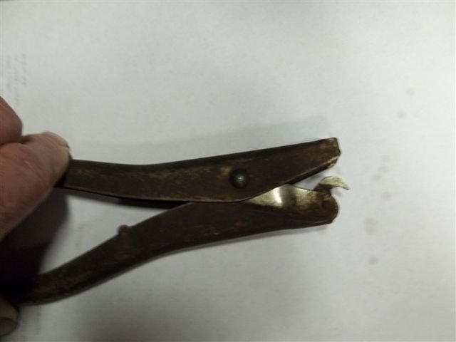

I've posted this in the past but here it is again. Found at a garage sale most likely. Jim

Inthegarage

That’s a great for pins.
I Magine they are scarce
Where can I find one of those?

Bill, can you post a photo of the snap on one? Craftsman use to have one that looked like a bent awl. The one Jim posted is interesting, and looks like it could be effective. I also usually use side cutters. I really like Steve's ss pins.

I should mention that tool I posted works well on newer or recent applications but if your working on something that has not been apart in 100 years or so they won't come out so easy. This is what I have had good luck with, I just back the nut that I'm working on off shearing the cotter off then I take a small drift and drive out the remaining parts of the pin, the remains usually show up as shiny metal against a rusty background. Jim

Are there any manufacturer markings on your old tool? Wondering who made it. It would be a neat conversation piece if you never used it.

Post by TFan » Fri Oct 09, 2020 11:17 pm
Mike, I finally dug it out haven't used it in awhile, it is made in USA and named Zim cotter pin puller. It looks as if it may have been plated at one time. Jim
