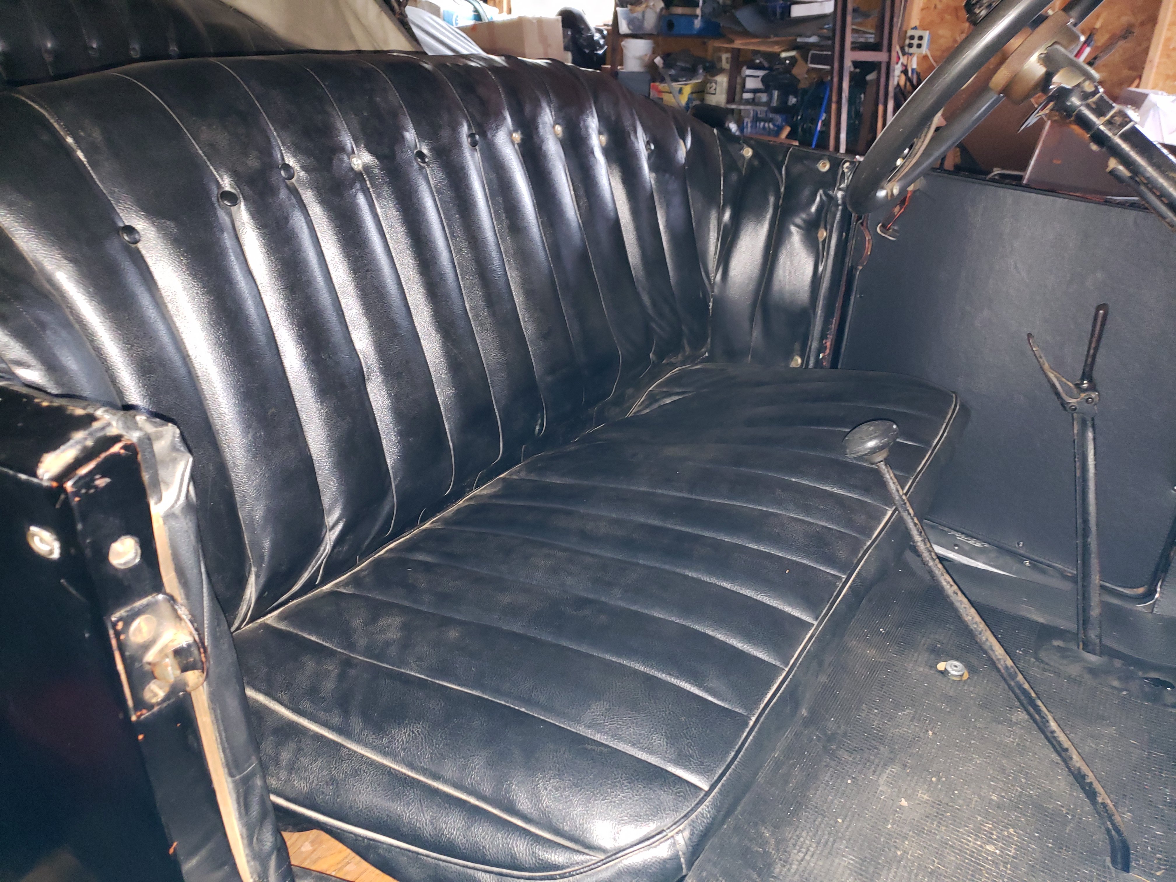

BobP
- Posts: 1064
- Joined: Wed Jan 09, 2019 7:24 pm
- First Name: Robert
- Last Name: Peterson
- * REQUIRED* Type and Year of Model Ts owned: Original 1911 open runabout, 1914 tr, 1916 rdts, 1921 tr, 1923 rdst, 1925 cp. 1927 pu, 1927 tr.
- Location: MN
Re: HELP! Can Get some pics of interior upholstery from 26 or 27 Touring please?!
Hi, My 1927 was made on Jan. 31 1927, 14693546, It has original paint and all of the interior is original. Look at the pictures. Thanks, Bob.
