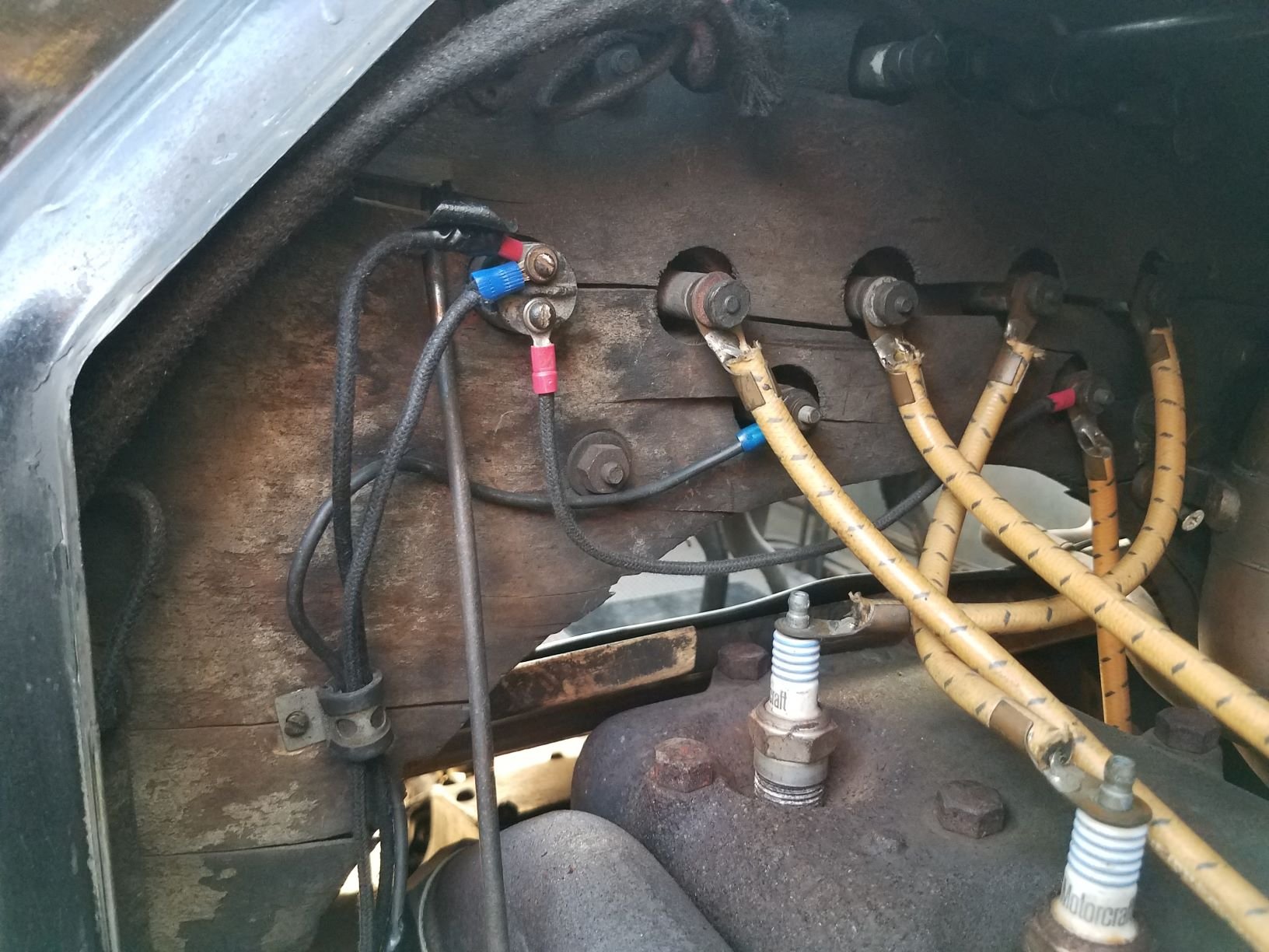

Here is how I have it wired.
Red and blue on top of the switch are hot to the lights, each light is grounded on their respective radiator mounting bolts.
Blue (under the spark plug wire is hot from battery
Thanks in advance
John
Thanks in advance
John

Re: Engine dies when lights turned on
So....your lights only run off the magneto if I'm seeing the wiring correctly. I assume the battery post is only connected to the 12 volt battery. Norman may have it correct although I would think there would be enough juice at high rpm to keep the engine running albeit perhaps poorly. I think if you choose to run the lights off battery and install the appropriate bulbs you will have more reliable lights than the magneto bulbs. I went to LED'S which draw a lot less juice and are brighter than the available incandescent bulbs. I don't have a generator and use a battery minder to keep the battery up. My battery is a small AGM unit so if you have a conventional car battery installed you'll have a lot more reserve than I have so running lights shouldn't be a problem. I use my battery for starting and then run on mag.

I wonder if I could relocate the far right connection from the mag terminal to the terminal with the blue connector (under the plug wire). The result should be that the car will run on mag and the headlights will run off the battery........Correct?

Thank guys. I don't do much driving at night (the occasional gas light parade) so, if I relocate the far right connection from the mag terminal to the terminal with the blue connector (under the plug wire). The result should be that the car will run on mag and the headlights will run off the battery........Correct
- Posts: 5557
Yes, that should work.john in kzoo wrote: ↑Mon Oct 12, 2020 11:34 amI wonder if I could relocate the far right connection from the mag terminal to the terminal with the blue connector (under the plug wire). The result should be that the car will run on mag and the headlights will run off the battery........Correct?

I'll move the connections tonight and run the car on mag while having the lights on battery

I see your wiring totally different.
If your inside switch is wired correctly...
It looks to me like the lower right RED crimp ferrule connection is on MAG post of the coil box??....the lower left BLUE crimp ferrule is on BATT post ??
Thus you still have MAG voltage going to the light switch, and then two parallel 6-8V lines coming out the top of the dash light switch? Then, where on earth does the BLUE ferrule crimp on the lower left go to? (I hope it is to wherever you have your battery located) Wired this way, your lights just might illuminate at idle, but you give it some RPM and they go poof.

He explained where the wires go in his post(s). Lets not over complicate a simple thing like changing a wire for the power source. Other then the extra wire for the head light, it is wire now as it would have been with a battery added.

George,
Blue crimp connector goes to my battery under the backseat.
Guys,
Another stupid question, I have both a 6 volt battery (currently not using), and a 12 volt battery to start and then switch to mag. I should run my lights on the 6volt as again they are old tung sol 6-8 volt incandecent bulbs
Guys,
