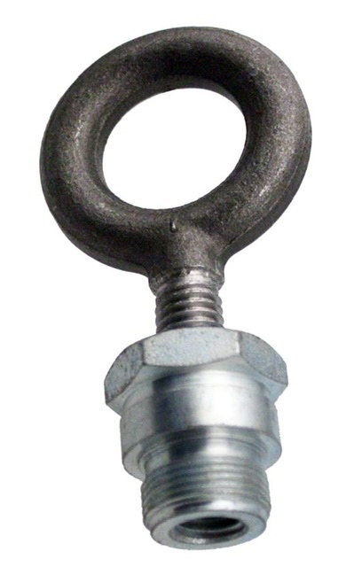

I don’t think the firewall is removable. You might be able to do it with the body in place by loosening the pedals and wiring them down, but the hogshead hump will still need to be cleared. If you have a engine hoist, you may be able to tilt the rear of the engine down with the nose up and carefully inch it in place under the firewall with the pan supports sitting on the frame and sliding rearwards. I have posted a picture of a lifting eye (sold by Snyder’s) that screws into the spark plug hole for lifting and tilting the engine as I described. I’m pretty sure the radiator will need to be removed for this. I believe you said the steering column is out, which is necessary. Good luck. Jim Patrick

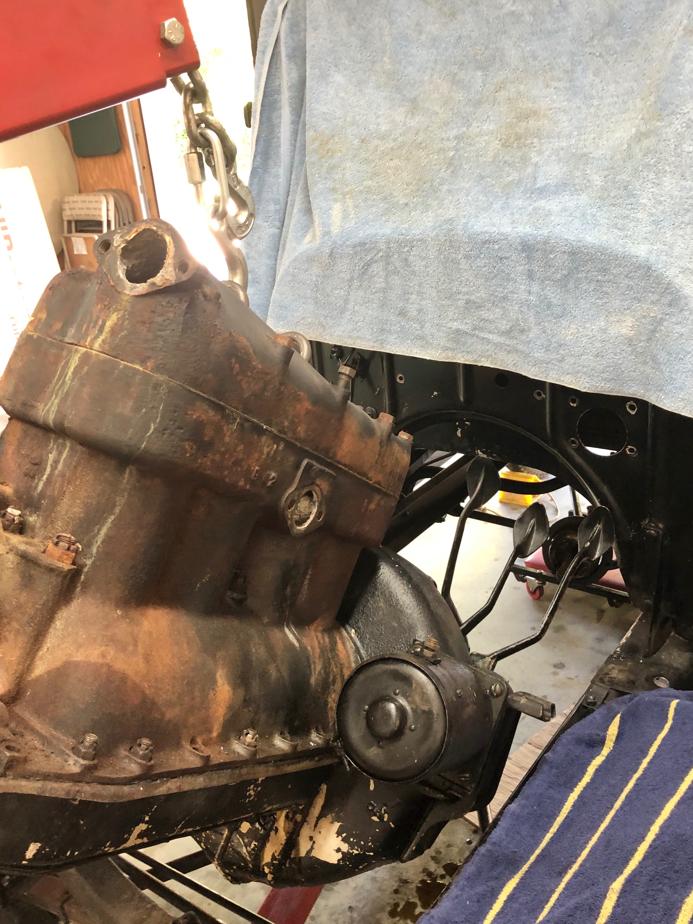

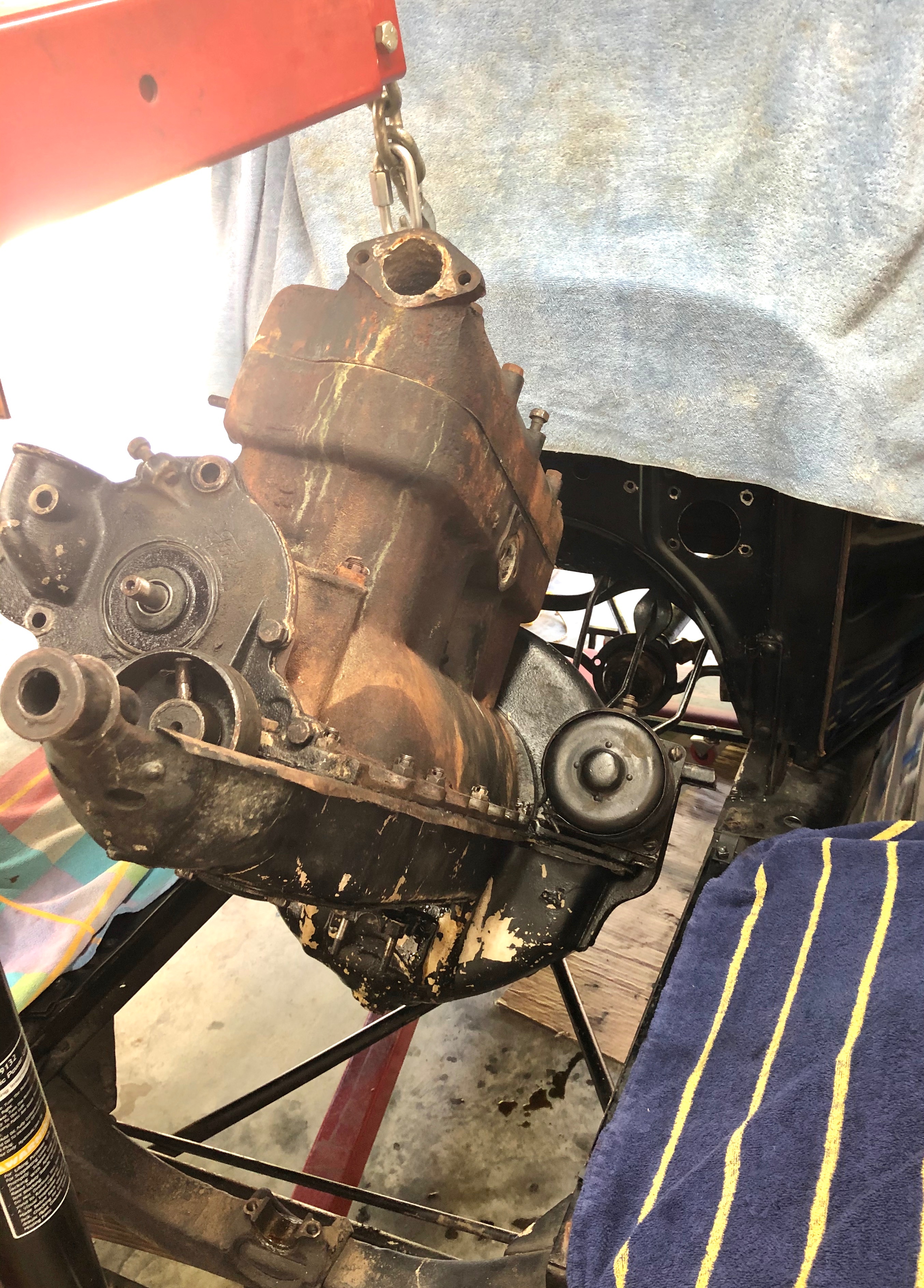

Post by DanTreace » Wed Oct 28, 2020 9:03 pm
Easy one person with a good lift, and plug hole eyes positioned for max tilt. Clears firewall.
Pedals behind firewall:
Pedals now clear:

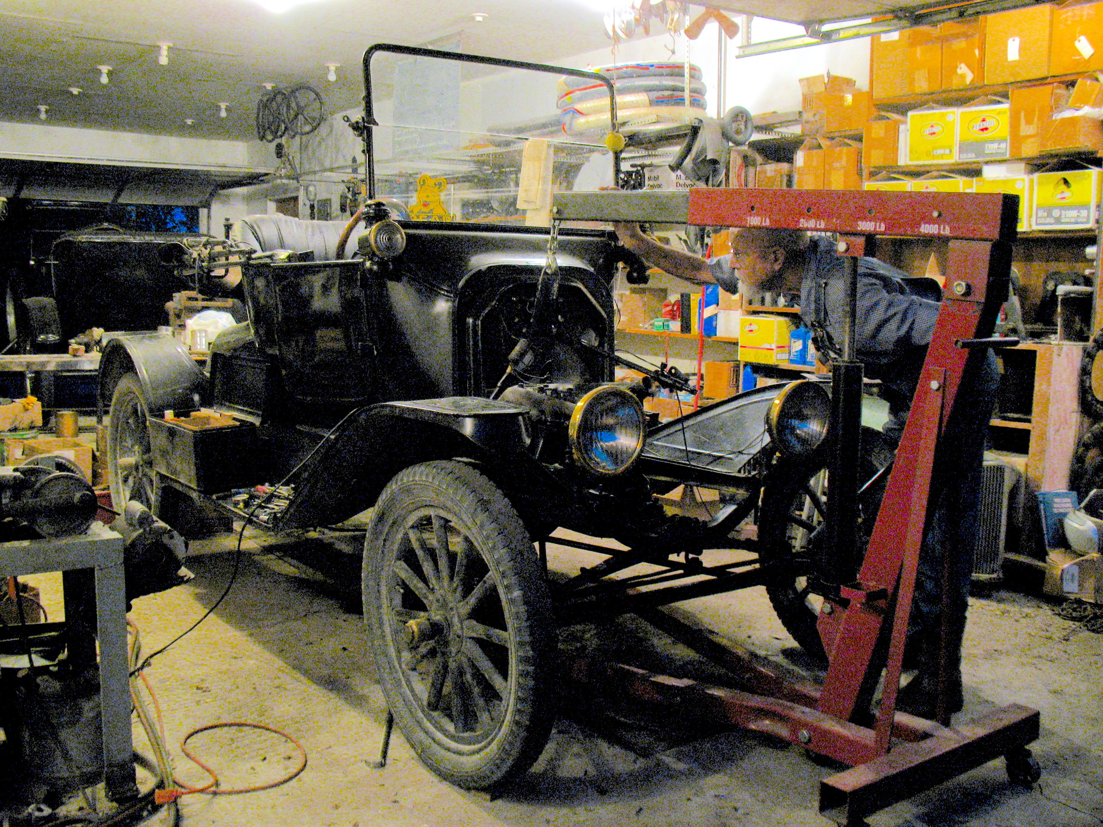

Post by Steve Jelf » Wed Oct 28, 2020 10:29 pm
with an engine hoist and a helper it is easy (enough) to do without removing the body or the firewall.
Helper? What is that? :D
Note the steering wheel back against the seat.
