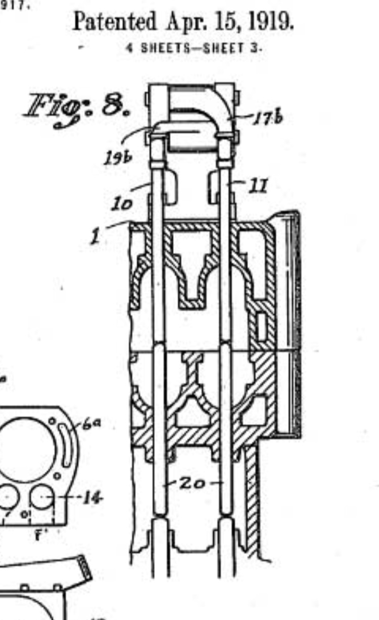

Here are some pictures of my 16 valve. It is a Model BB with 1 1/2" valves in a square pattern. This motor had Laurel pistons, Laurel aluminum rods, Luarel camshaft and radiator when I found it. These are the better rocker arms, than earlier versions. If I remember correctly the Model A head pictured above had push rods that went through the intake ports, creating a possibility of vacuum leaks, and bad idle.

I heard about the leaks through the pushrods. The guides on top of my head look different from others I've seen. 4124 sounds about right for the BB head serial number. I'd be curious to what other A head serial numbers are. They said rajo made over 4,000 heads.

Re: Robert m Roof 16 valve head
I stumbled across these a while back... it’s no surprise the push rods can become a major vacuum leak
