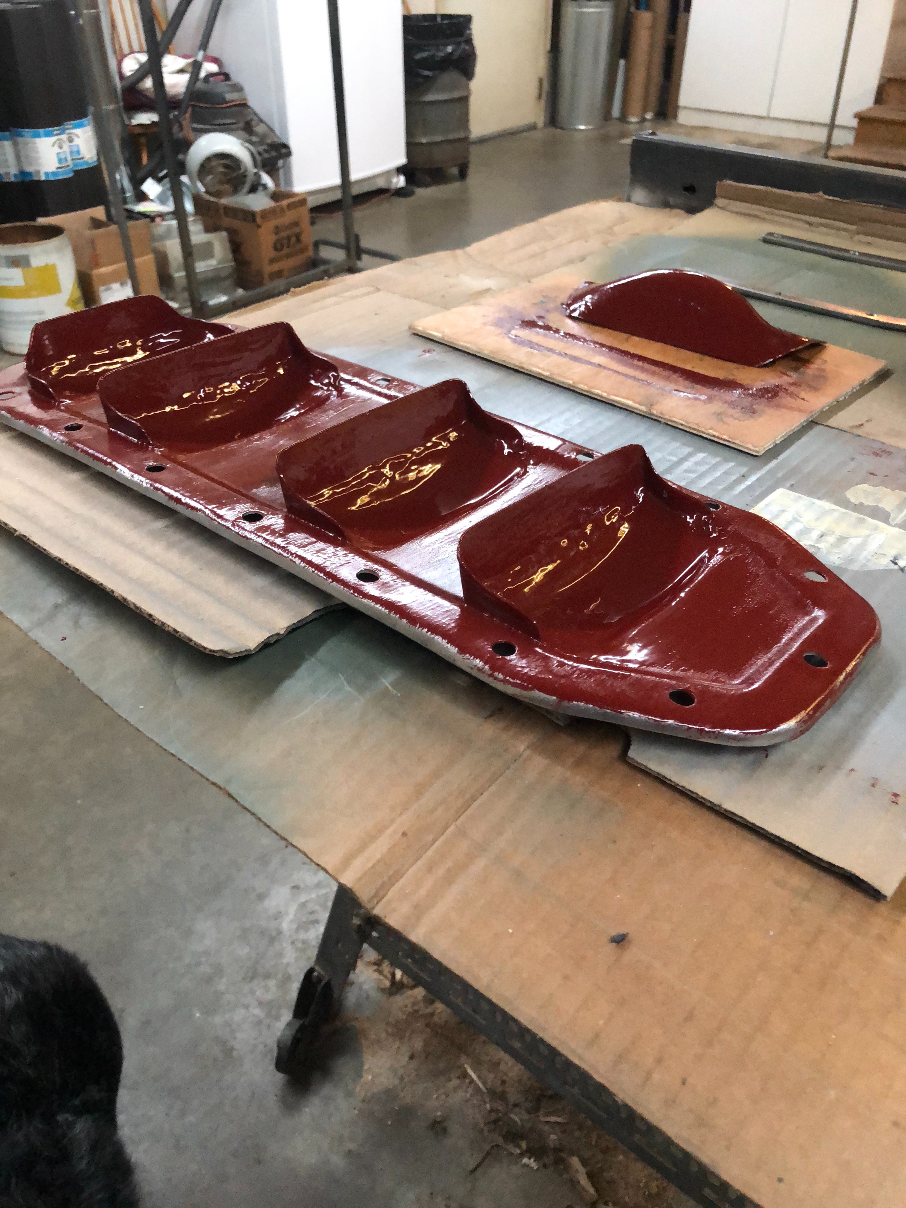

Is anyone manufacturing/selling a Horlick-style mountain pan (4-dip)? I'd like to install one on my current rebuild.

No, that's not it. Terry puts dams along the back sides of the dips to keep oil in them when the car is climbing a hill. I believe he solders them in. I think it's a DIY project.

Actually it is just dams toward the rear of the dimples to hold oil for the rods. Ask Admin Jeff to post pictures of the one I built for him, cannot seem to find them. He said it worked out great on his hill.

I braze the dams into my mountain pans.

I have only seen a few of these big oil sumps on model Ts. They have all had drilled cranks and pumps (usually a VW oil pump on the back end of the camshaft, I think). I agree that if you don't have a tray like the inspection plate or an inspection plate with dams in place you are risking the big end of the rods. I assume that the flywheel and magnets should still create enough splash that there will still be a general oil mist inside the crankcase.
