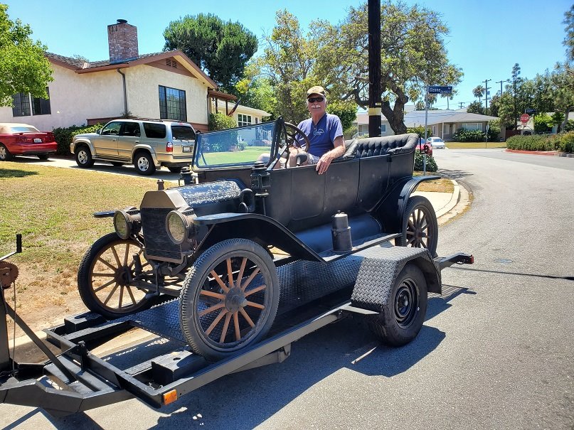

Here you go guys! I did it just for you. I don't work on it much, but try to get a little done on it daily. Here is the engine number: 378058, Nov. 21. The car has few miles on it, probably because the driven gear was shot before I bought it. The hand crank is a tight as new, and still has an aluminum handle. The ratchet is riveted to the crank. It has a model 100 speedometer on it that a previous owner must have installed, as it hasn't been hooked up ever. I plan to have Russ fix me a model C, which really isn't correct either, but I'm putting one on anyway. It also has the extra large 1913 hubcaps. The top is shot, but hope there is enough left for me to use as a pattern. The upholstery is also original to the car. The handle for the sediment bulb was broken, and I fixed that yesterday. More later.

Wow Larry, that is one nice original '14!

Very nice. I hope you research the 14s as thoroughly as you do the 13s and give us the info.

Very nice car Larry! What have you discovered about the wheels. Has all the paint flaked off or were the spokes replace and not painted? I was under the impression that natural spokes were not offered until later.

Nice looking car, Larry. Thank you for posting the pictures.

The floormat is definitely not black, but close to it. I wonder why Snyder didn't put Made In USA in the corner like the originals? Since this car has had many owners before me both the rh wheels may have been changed, or a previous owner may have wanted natural wheels, and then never got around to finishing them. Another thing that bugs me is a previous owner must have had issues with the fenders, splash shields, and running boards, because they have all been replaced with the correct parts. When all that was going on a former owner replaced the body mounting bolts upside down. I can't stand that kind of stuff on my cars, so decided to turn them over. Well, I'm glad I did because the two center bolts were 1/2" diameter. They are supposed to be 7/16. Here is the issue. You can't buy 7/16 NF bolts with an 11/16 head. I know the four flywheel bolts are the correct thread, and have a 11/16 head, so I plugged the two holes in each bolt, threaded them a bit higher to match the originals, and drilled new cotter pin holes. Are any of you aware Ford used three different lengths of body bolts on the same cars? Enough for now!

Nice looking car! Now I know why you call yourself "original" Of course, that title can have two meanings! One is you want everything original, the other is you are one of a kind or "Original"
That's correct. Wheels were always painted body color until early 1926. Even after they became an option, I believe "natural" wheels were uncommon. How many do you see on cars in period photos? Mighty few. They are mostly a modern fad.

While Ford may not have offered “natural”wheels from the factory... most original ads offer natural varnish as an option. There are a few ads in this ‘ol thread;Steve Jelf wrote: ↑Sat Oct 31, 2020 11:35 amI was under the impression that natural spokes were not offered until later.

Here in Winnipeg the dealer offered natural wheels as fare back as 1912 ,one of our club members back in the 1960s how worked on my 1912 T when it was new told my Dad all the cars had painted wheels when new ,if the customer wanted natural wheels they would take a new set of the shelf and varnish them , and do a switch at no charge. He said this was very common . My 12 had painted wheels on it in a 1936 picture . When Dad bought it they were natural and he left them that way .
