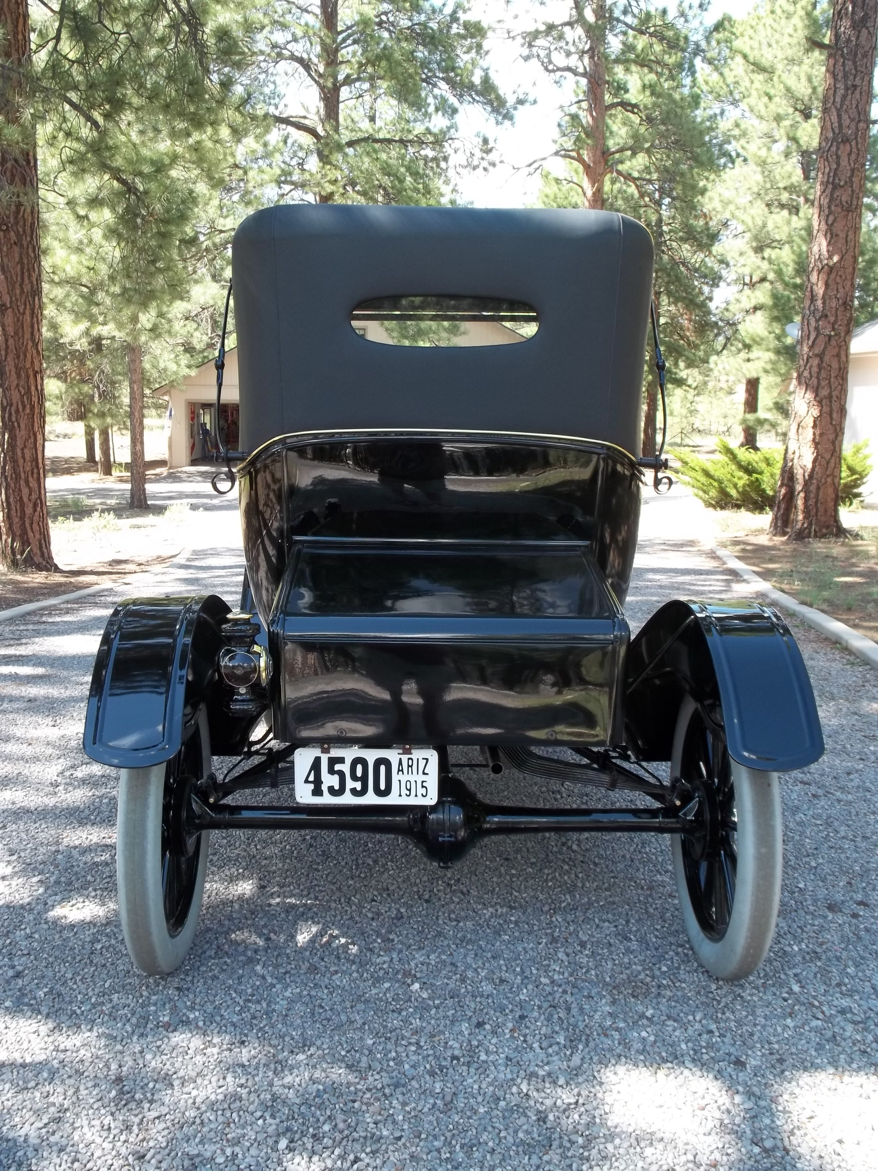

Mike, The 1916 coupelet used the same tail lamp bracket as the runabout, but the 1915 coupelet used the blade bracket that set the tail lamp off to the side of the trunk so the rear deck could be opened. I hope this helps, Russ Furstnow

Wayne, This one has me confused also. I know of a totally original 1915 Touring that is sitting in the Pioneer's Historical Museum in Flagstaff that has the two piece tail lamp/license bracket. The car was assembled in April 1915, and it was originally sold in 1915 by Babbitt Ford of Flagstaff. The oil tail lamp was replaced with a later electric lamp, but the bracket is the one Trent describes as the four piece bracket. Russ Furstnow

Larry, Here is a photo of the tail lamp bracket on my 1915 Coupelet. I have seen this same bracket in early photos of a 1915 runabout (See "Model T Times", #418, November December 2018, page 29). Regarding my comment about the original 1915 Touring in Flagstaff, I checked the engine number and casting date and the engine was cast on April 5, 1915 with a build date of April 8, 1915 according to the serial number stamped into the block. This car has not been disassembled and has the "four piece bracket" detailed by Trent Boggus. I hope this helps, Russ Furstnow

That's an interesting mount, Russ !

Early Coupelets are very interesting cars!!! Russ Furstnow
