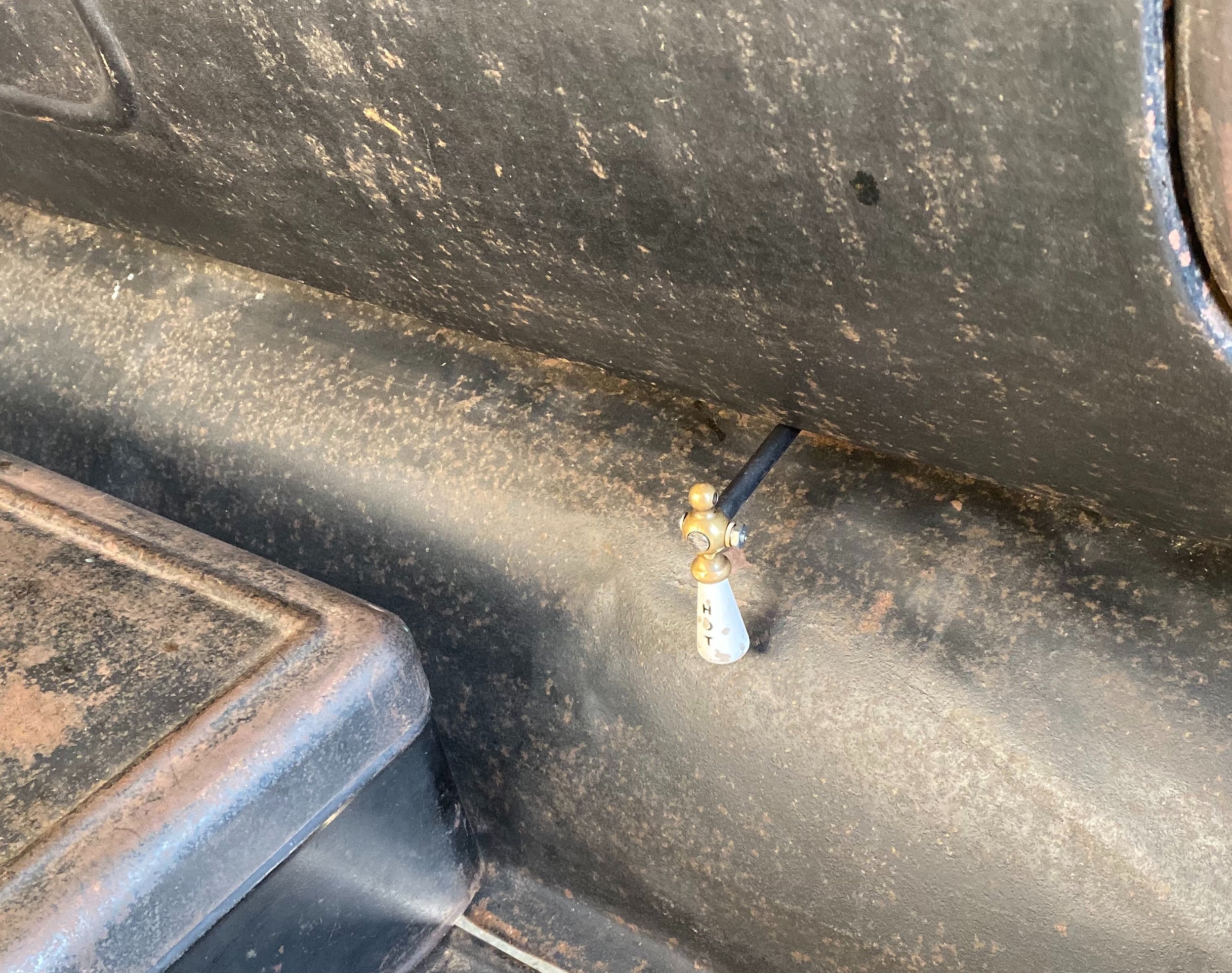

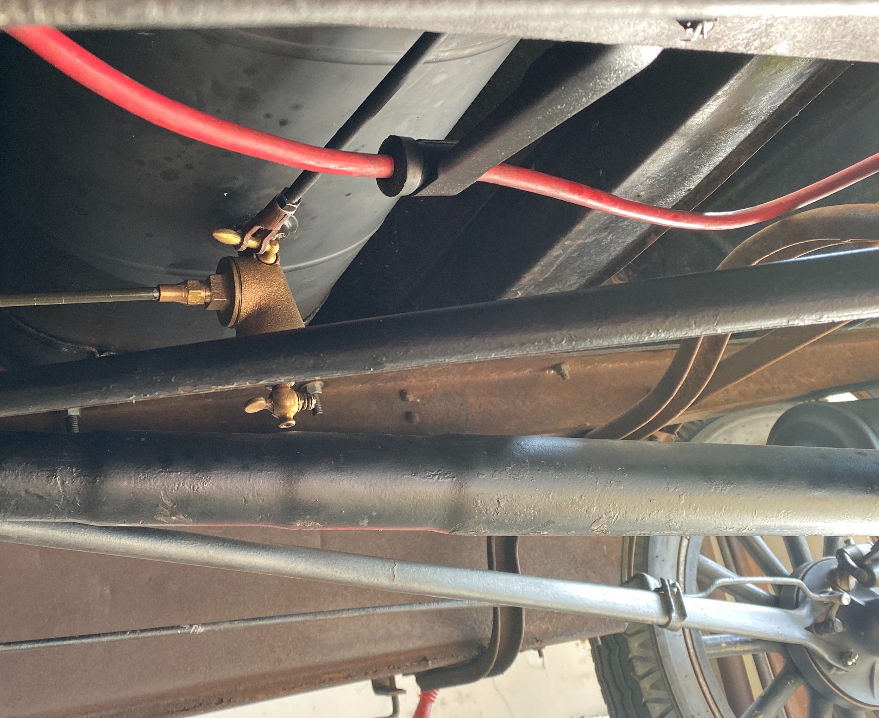

I concocted a remote shutoff as well.
Obviously not a stock item, but it goes very nicely with my weathered T. And, strangely enough, to the "unwashed masses" who see the car out in the wild at a gas station, etc, it's asked about a lot....probably only second to the crank handle and whether or not I can actually crank the car. People are absolutely smitten with the hand crank.

Re: electric fuel cut off
Post by Henry K. Lee » Wed Nov 04, 2020 7:02 pm
Nice Don!!!!!
