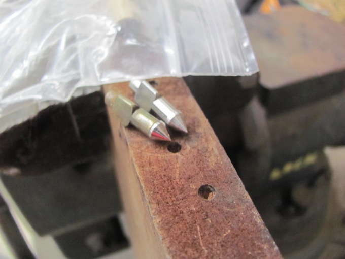

Post by TrashMan » Sun Nov 08, 2020 9:15 pm
[image]
Here is my jet, it’s brass not shiny. Is this the bad jet you was talking about?

When they are saying Grose Jet, they are referring to the float valve, not the needle seat that you are showing in the photo. Grose Jet is a particular style. Slide out the pin holding the float in place to reveal the float valve to see which style it is.
