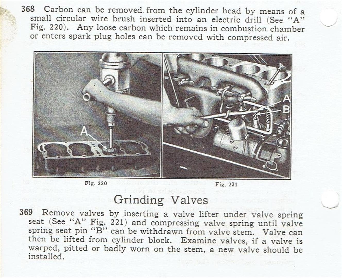

Re: How to use valve compression tool
I believe the original Model T service manual demonstrates this style of compressor. However, the hook reaches up and grabs the top surface of the engine block, (or maybe hooks onto one of the head bolt holes), while the fork on the end of the lever arm goes under the valve spring washer. Simply push down on the lever and the spring goes up.

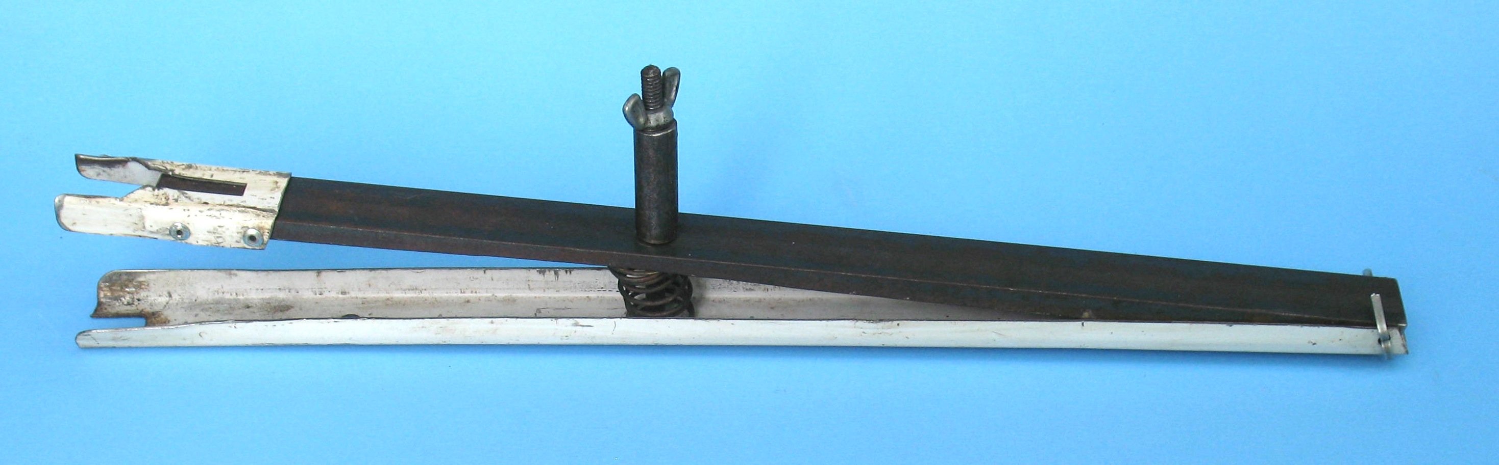

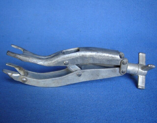

- Posts: 7413
This home made one isn't bad.
This one is better. I found one online for $40 and passed. A few days later I went to an auction and bought this one for $2.

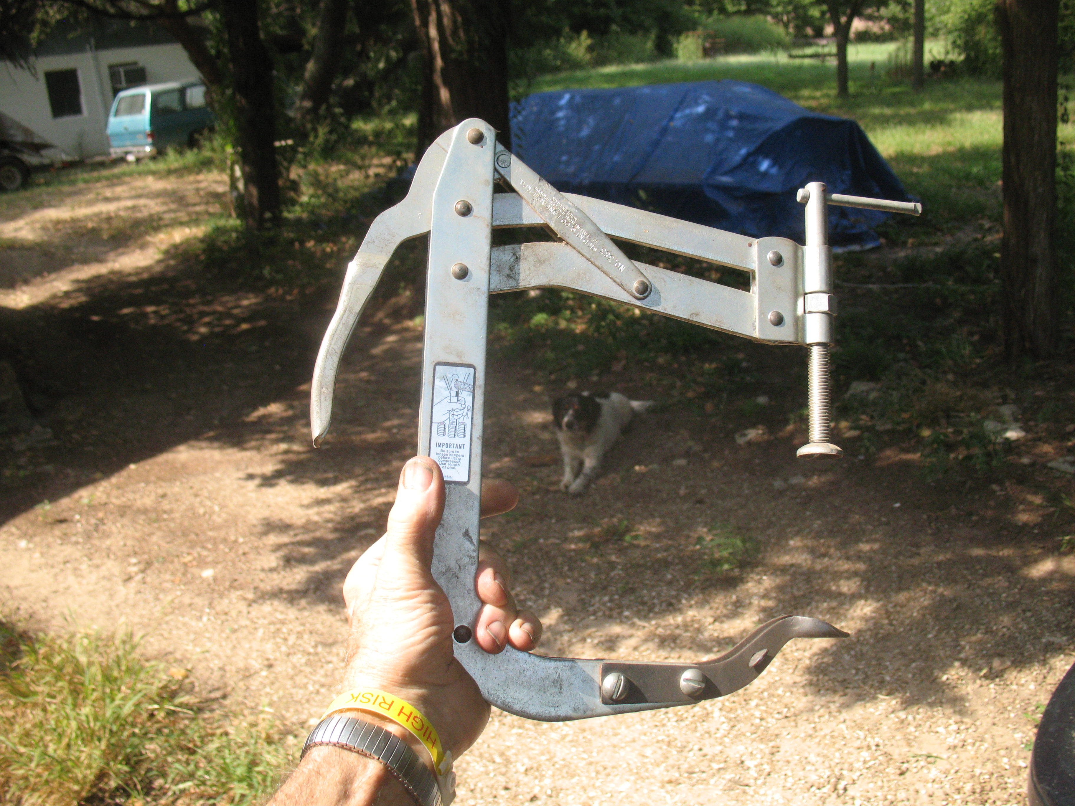

- Posts: 4502
This is the style I like. The "dog-leg" design clears the hood shelf when the engine is still in the car.
