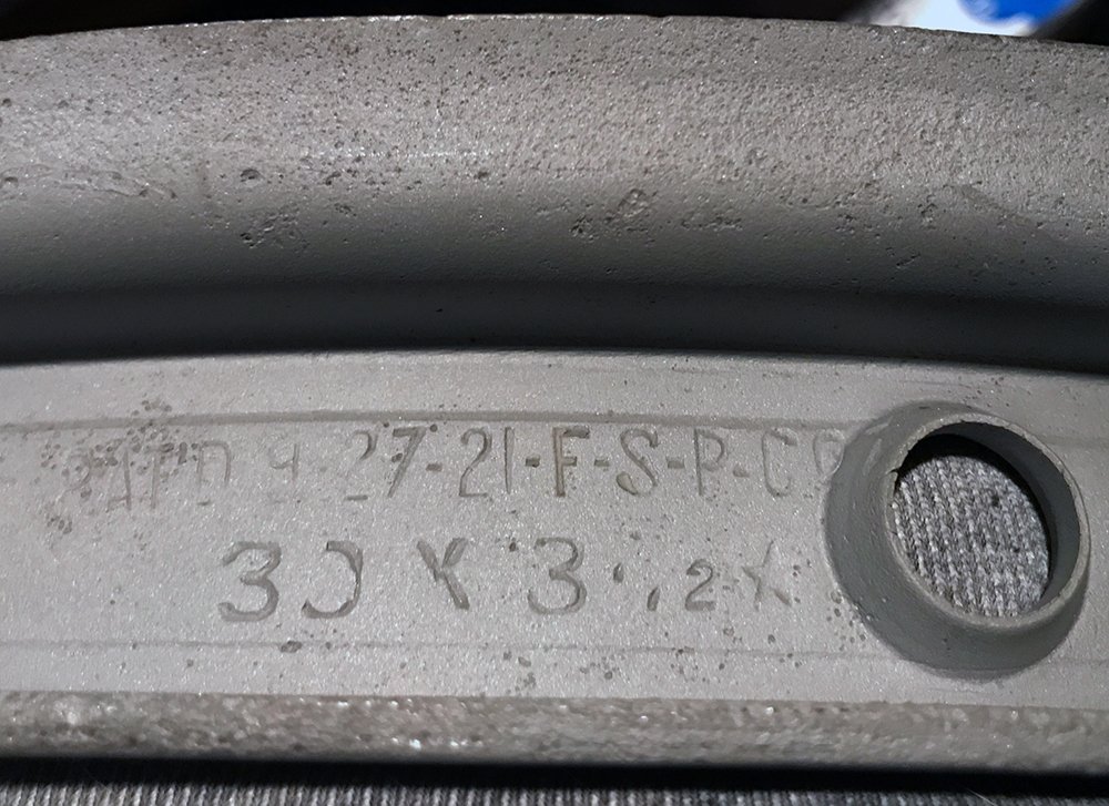

I bought a rim to use in building a new rear wheel and came across this stamping. I know what the 30 x 3 1/2 means but does the other tell anything about it's origins?

Looking at the letters: PAT’D 9-27-21-F-S-P-CO and the last letter may or may not be an "O." I would suspect that the company patented that style on 9-27-1921. Company Name would have three words -- one starting with F, the next with S and the next with P.
From the photo the lower side looks like a clincher, but the side at the top of the photo reminds me of the 1928-1929 all steel spoked Model A Ford rims that had a rolled / rounded edge. Is that just an optical illusion and the rim is a standard 30 x 3 1/2 inch clincher rim?
Also is it a demountable? And if so, are the lugs attached? Some rim makers put a mark on the lugs.
And does it fit a Model T wheel?

Hap, I think the photo shows a steel felloe rather than a rim. It shows a turned in outer edge and a wider turned out inner edge.
I can't help with the lettering, other than to say it's not a Kelsey felloe.

Firestone Steel Products?

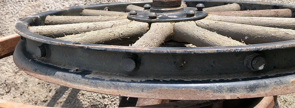

Sorry....should have provided more info.
The item in question is a steel felloe for 30 x 3.5 inch demountable rim. It is designed to accept fixed-lug rims, with notches by the mounting holes.Yes, it does fit a Ford Clincher Rim.
Here is a photo before the spokes and hub were removed and the felloe bead-blasted. "Firestone Steel Products" is a possibility but the profile of the felloe doesn't quite match the patent application.

Summary: I’m 99% sure you have a wheel/felloe that was manufactured by Firestone on or after Mar 1924 for use in the Ford USA assembly plants and as a replacement part for dealers.

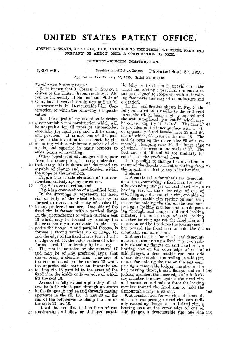

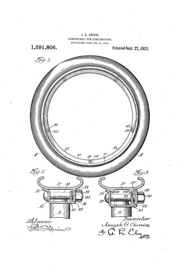

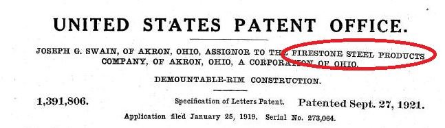

John – thank you so much for finding and posting that Patent information. From the second page it has:
Firestone Steel Products patd Sept 27 1921.JPG (22.9 KiB) Viewed 2923 times
That it is a patent for a demountable felloe and rim and that it was Patented Sept 27, 1921 i.e. 9-27-21 which is the same date stamped into the metal felloe indicate it might be the same felloe and rim. If the Patent date was different then it probably would not have been the patent for that wheel/felloe/rim. Initially I saw the Jan 25, 1919 date and thought – well this patent is not for that felloe/wheel. But then I zoomed in and read that was the date the Patent was applied for NOT when it was Patented.

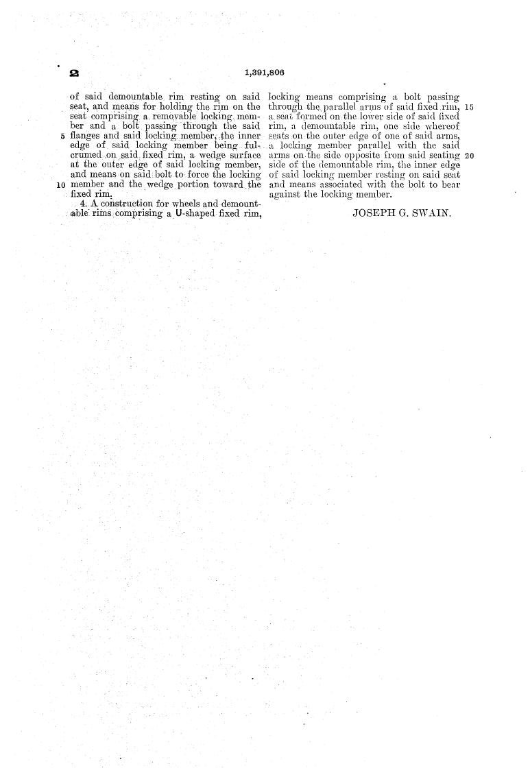

Looking at the illustrations in the Patent, it is close but NOT a perfect match for the felloe you show in the photo you posted. But on page 2 of the Patent it has:

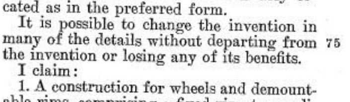

And that indicates to me that they could make minor changes and still keep their patent.
And the Patent states ASSIGNOR TO THE FIRESTONE STEEL PRODUCTS (see below)
And note that the word “COMPANY” is on the next line. That lines up with the F-S-P-CO very well.

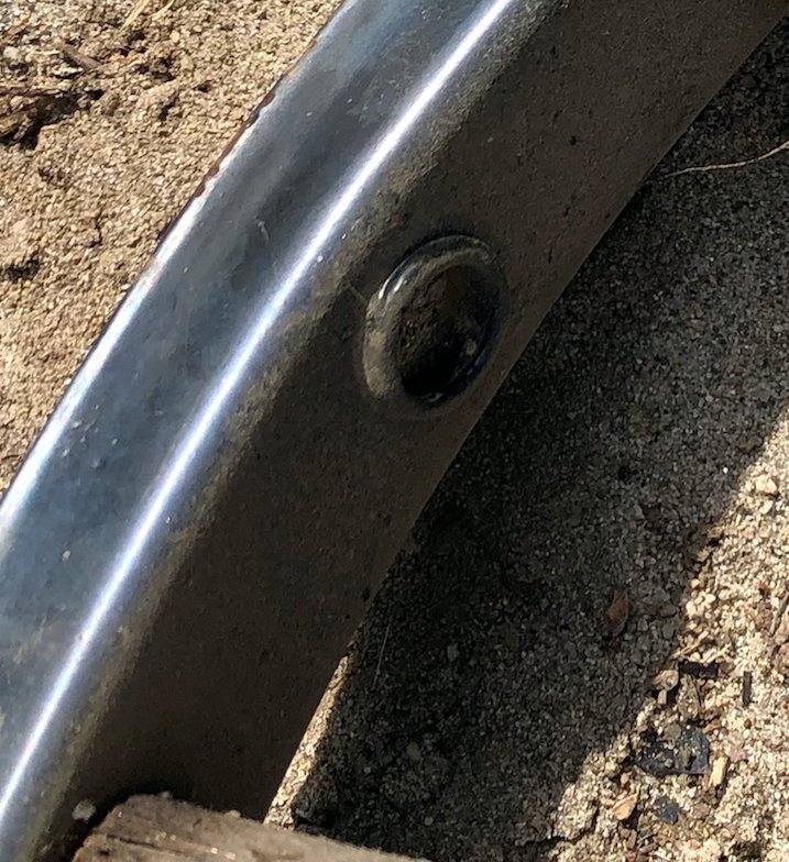

Hap - great info, I think you nailed it. Thanks! My wheel is like the top one in your photo, with the cup. The attached photo shows what the valve stem hole looks like from the outside.
None of my rims have a lug that would fit into the cup but I suspect they'll still work fine. Someone once told me that the cups and lugs were a feature in felloes and rims that utilized loose lug rims to help center the valve stems.
