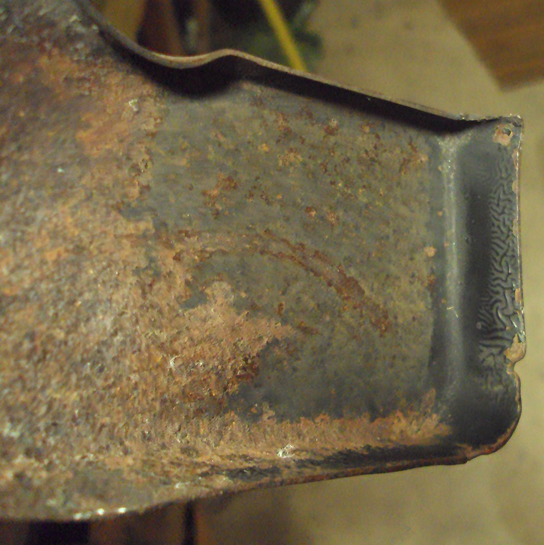

I am at a loss as to what the hole on the end of the hood shelf off my 1924 Touring. Can anyone shed some light on this? Thanks [/size][/b]

It could be for drainage but not what you're thinking. Imagine if the shelves are painted while hung from one of the holes on the other end. The first process of painting is cleaning the parts. They would be run through a cleaning bath and the fluids would need to drain and dry before paint is applied. If water doesn't drain out, the paint won't stick in that area. Where I work, adding drainage holes is common for a quality finish.
Re: 1924 Hood shelf question
This hood shelf shows where the paint accumulated during the dipping process. There is very little paint anywhere else but it drained here to the point of wrinkling. This has no hole but I'm not sure that would have made a difference. It does give a clue as to what direction it was hung to dry.
While not proving that is what the hole was for it does give some reason to think that.
I am convinced Rich B. was correct in mentioning they were probably dipped parts. I had some fun in the '60s with a coffee can nearly full of water and floated a half an inch of Dulux enamel on top. I was impressed with how parts could be dipped and then tipped different directions to let the drips run off. Many other paints won't work for that.While not proving that is what the hole was for it does give some reason to think that.

John - The "notch" shown in Richs' most recent two photos is the type of "notch" I had in mind in my 6:59 post of 11/26 above. That makes more sense to me for water "drainage" than a hole centered vertically as shown in the original post. Mention has been made in this thread that possibly several different Ford contractors might have made these hood shelves, each with their own different details and very minor variations, and I'm thinking that that might be the case with hood shelves,.....???

The notch is not an intended feature of the hood shelf. It is a result of a lot of metal being compressed when that corner of the piece is stamped from a flat sheet of steel. Daniel's first photo shows how distorted the metal is in that area. It is the end of a wrinkle and each shelf developed it's own personality at that point.
At left are the earlier hood shelves (reproduction). You can see the distortion they have.When did I do that?

The ones shown above with the top down slots cut in them, could be from the firewall that has slipped down and was riding on them. That would be approx where the edge would be. I looked at the ones on my 25, the back end is hidden by the firewall and body so can's see much except a little bit of the end sticking out past the body.
