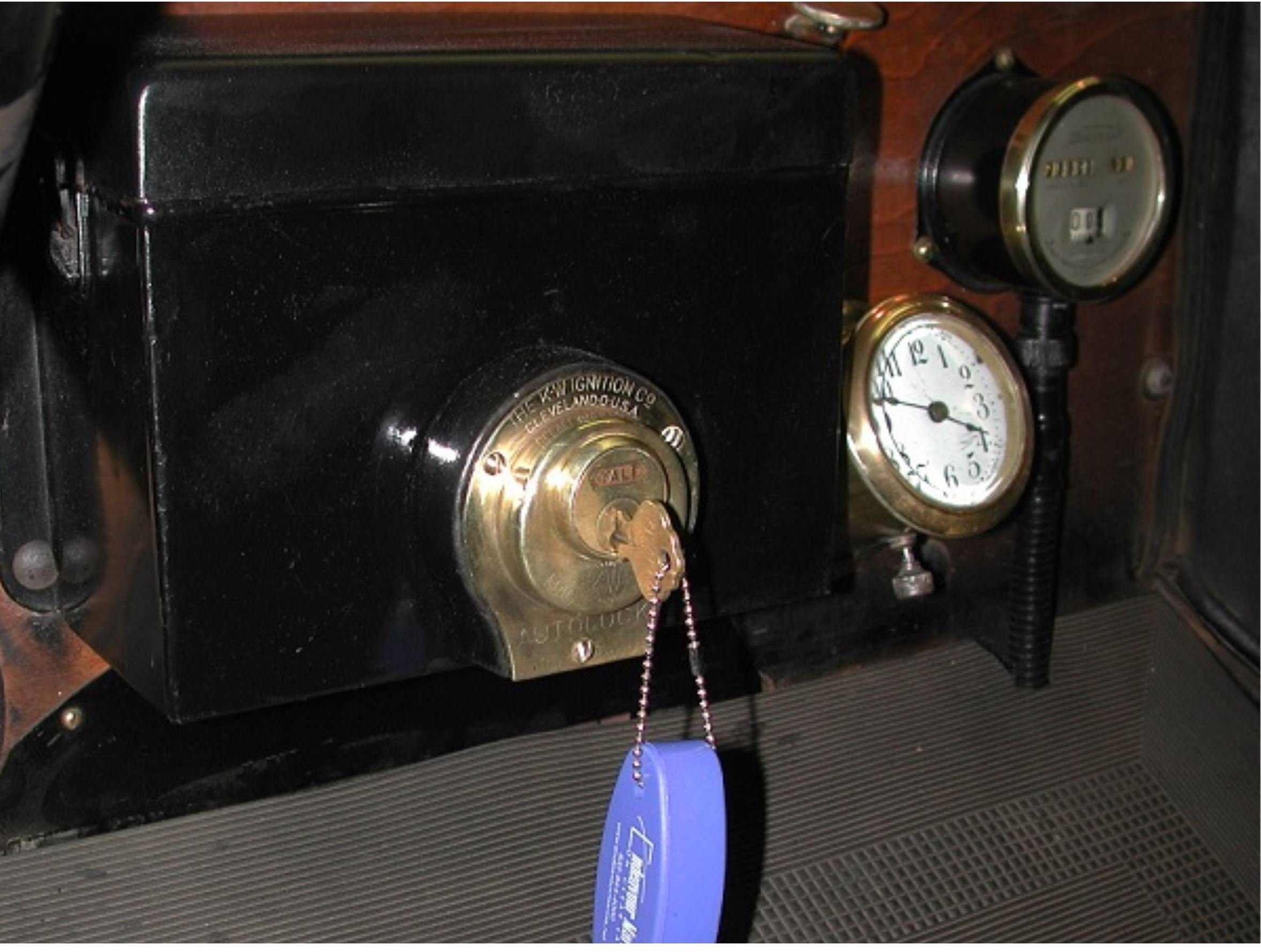

A KW master vibrator would have had a KW switch. Very nice master vibrator but with an added on switch.

Looks like a KW Master Vibrator to me John. May be an earlier version of yours. Les, none of the 4 brass brackets can find a place to mount wood screws to the left of the steering column 😞

I stand corrected, I did not know that they had different switches. Thanks.
Posts: 5263
Re: Mounting a KW Master Vibrator on a 1914
Post by RajoRacer » Tue Dec 01, 2020 7:41 pm
That's an anti-theft switch - I have one like it on my KW Master Coil also.

Post by ThreePedalTapDancer » Tue Dec 01, 2020 7:59 pm

The KW Master Vibrator could be purchased with the regular kick switch or the autolock switch. Here is a advertisement and photos showing both styles.

Very good ! Great information all ! I never considered covering up the data plate Ed. Is it difficult to access the switch that close to the top of the steering column ? And both styles were offered at the same time according to Todd. This might be the earliest version of a unique key for a Ford instead of the common coil box key of 1909-1922 that’ll start all of em 😁 And if I mounted it above the steering column I’d have to lose the APCO column bracket. think I’ll forego the MV Installation..

KW also made the "AUTO LOCK" switch for the 1913/1914 coil box.
The only difference is "AUTO LOCK" stamped just above the lower mounting screw.
I have both and the internals are the same.
Also, the locking KW switches don't have the same internals as a regular
Ford metal coil box switch but they mount the same.
Doesn't help with the Brassitis, or Woodboxitis, but a bit easier to just change your two switches.
However .... it says Mastervibrator. ;)

The KW Auto Lock seems to be a 3rd option on this thread. But I still think I’ll stay put with the 4 Brent Mize excellent brass top coils. Besides, I’d hate to cannabalize my KW MV just for the switch. Then I’d have an extra ‘14 Ford switch and a KW MV box w/o a switch. 😁
