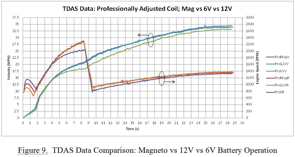

It is all about ramp time of the coils. Ramp time at 6VDC is much longer relatively speaking, than 20+VAC on magneto. You have a finite amount of advance that you can input to the timer, so at 6VDC you will ultimately end up running quite retarded whan at cruising speed.
There are tricks you can do to timing and coil amp draw which negates much of this, though it comes at a safety cost if hand cranking and your timer and timer rod is the least bit worn or arbitrary in it's setting. All of this trouble goes away if you go to a distributor and modern coil with a 6V battery. But, if you want the "genuine T experience" find a car with a working magneto.

Ron Patterson wrote a very good paper on this subject which goes into far more depth than I did above: http://www.funprojects.com/pdf/More%20o ... Timing.pdf
