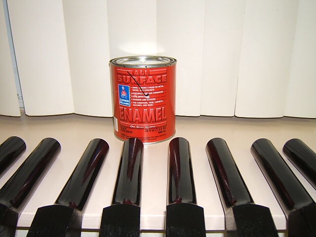

If there is grease or oil on the firewall, I would thoroughly clean it with lacquer thinner until all oil residue is off. After that, I would prime the wood with one coat of Sherwin Williams Oil Based Wood Primer. After it dries (about 4 to 5 days) I would apply a finish coat with 2 coats of Sherwin Williams All Purpose Gloss Black Enamel. Both Primer and finish can be nicely brushed on with a good 2” sash brush. I have posted pictures of the products. In the photo showing the can of black enamel, you can see the spokes I brush painted and how well it looks. Gloss is much easier to keep clean of oil, dirt and grease, than flat or satin finishes. Jim Patrick

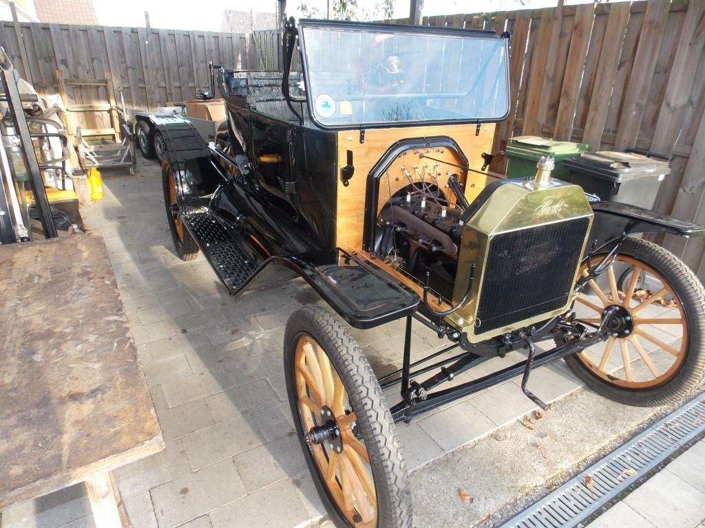

40 years of boat building with wood--epoxy techniques has taught me the necessity to thoroughly edge seal laminated wood materials. All other methods pale compared to epoxy encapsulation. Plasticized wood simply cannot absorb water. I have, on hand, gallons of System Three laminating epoxy. Chosen over the West system due to ease of mixing--two to one--resin, hardener, with equal results. Thankful for the sought after door-strap clamp you're sending me, It would please me to send you proportioned elements sufficient to thoroughly stabilize the open grain edges of your firewall. Sand off the resulting raised grain and epoxy smooth shine and the wood is prime for painting. In the case of my '16 firewall, the clear finish reveals no sign of the guardian epoxy beneath. With fast hardener (all I use and have on hand), after warming the firewall edges, with a heat gun, to enhance absorption, you would have about 20 minutes, at around 70 degrees, to liberally slop epoxy until the open grained plies refused it.
