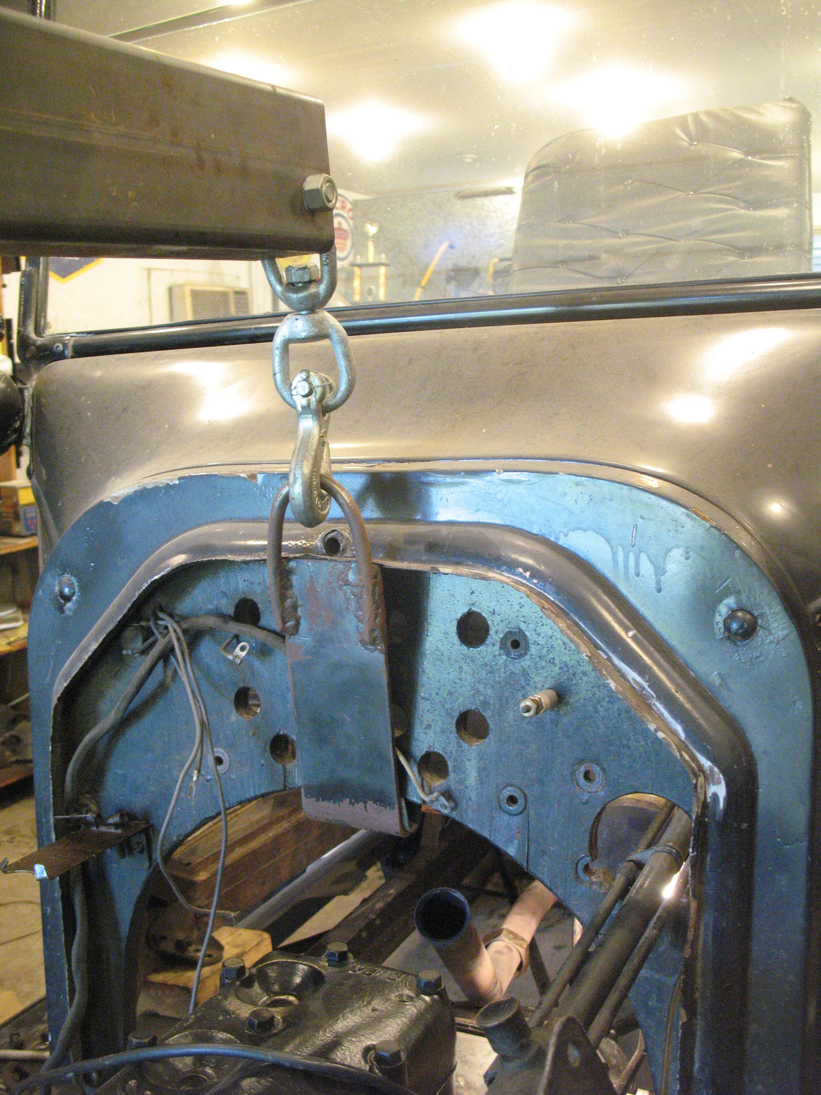

I made this lifter for raising the front of the body. Makes it easy.

Steve, that is a fantastic body lifter that you made. It may not be a bad idea to put a rag or something on the wood firewall before lifting to keep that 100 year old wood from shattering. I always removed the firewall on my 18 when I removed the motor but I was not concerned with damaging paint of the hoodformer bolts. Frank

Frank, it has inner tube padding. I think the firewall is only 45-50 years old, so it is solid. :)
