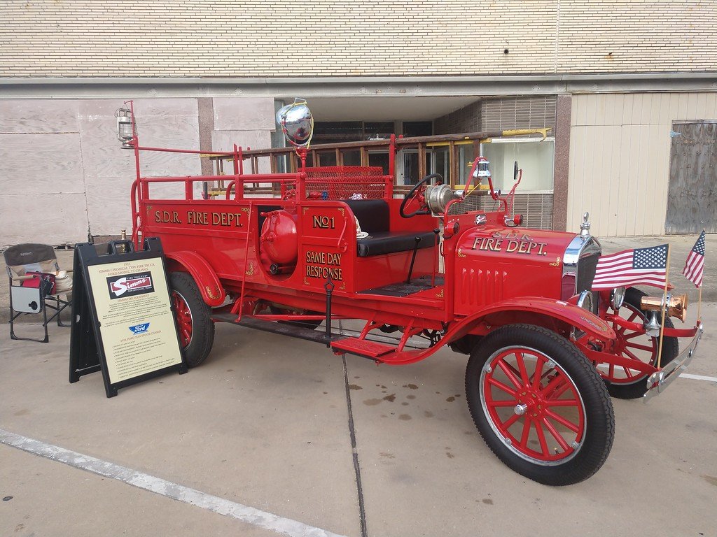

Please post a picture— pictures of your Fire truck.

By request, my Fire Truck. 1924 Simms on TT Chassis.
