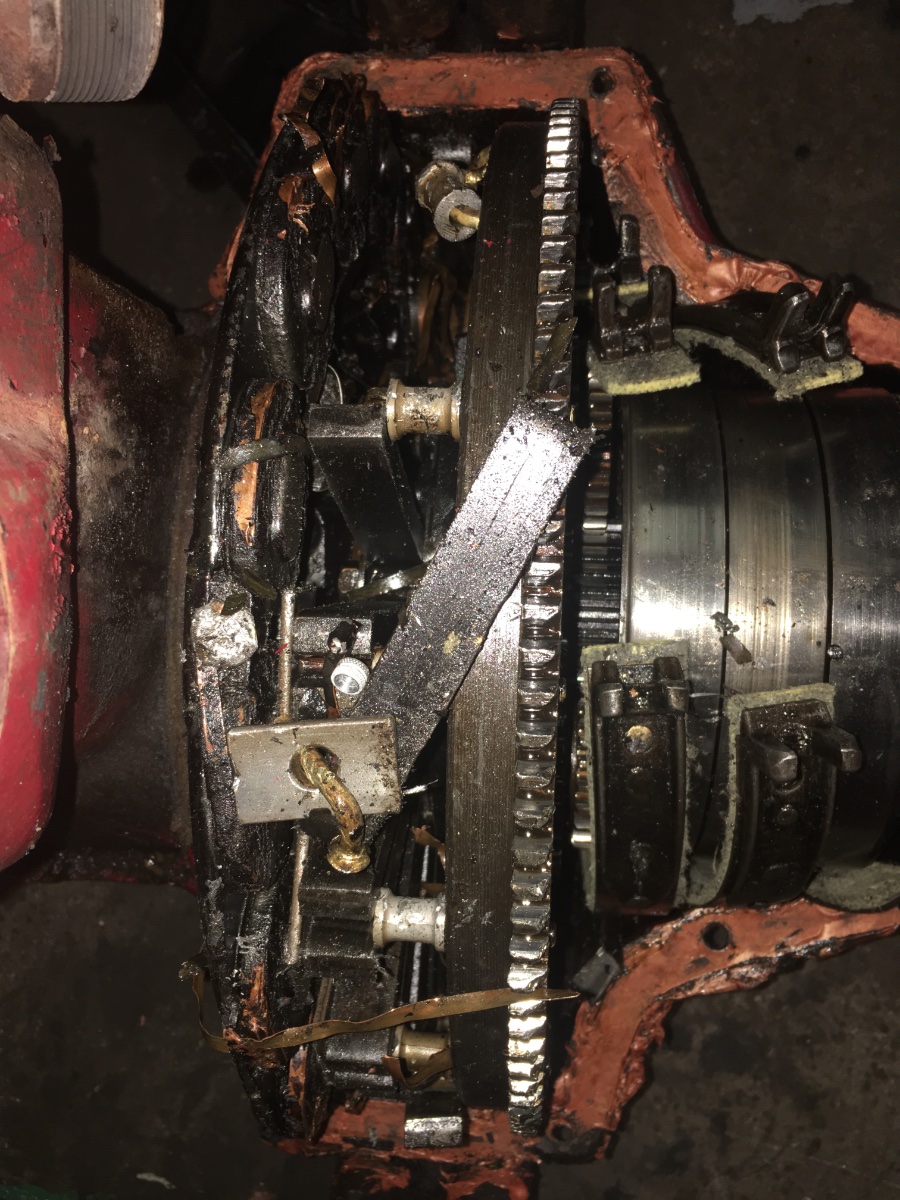

You are so lucky that they didn’t escape. I have had two engines where the magnets let go and hit the magneto coil with horrible results. Unless you remove all the magnets and have them magnofluxed, I don’t know how you can avoid the potential for a problem. Of course you can remove all sixteen and run on a distributor but that will get me banned 😊😊
Most recent failure
Most recent failure
My Coupe still has magnets as does the 09, but the 14 Touring and the speedster have them removed. I miss the noise of the coils and moving from a stop is more challenging due to the lower inertia of the flywheel without magnets.

Post by kelly mt » Tue Mar 05, 2019 11:14 am
Tony, yes this motor has a Bosch front plate distributor. So I did remove the magnets and put on slingers. At least when they come off the damage is minimal.
