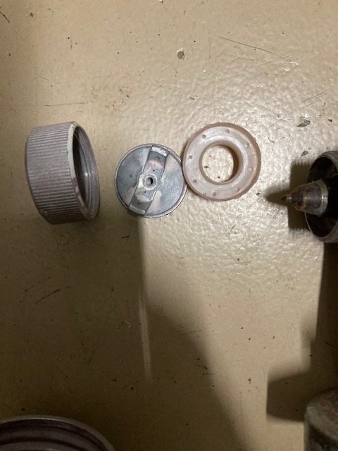

Hello all Merry Christmas, I am planning on spraying white Tractor Paint viewtopic.php?f=2&t=17755&p=134688&hili ... or#p134688 on my chassis. I have this Craftsman 919.15624 Paint Sprayer, is it good enough? I have not used it for 15 years. Owner's manual is now missing, nothing turning up on duckduckgo and another well known search engine that I am trying to get away from. This one seems close: https://www.manualslib.com/manual/32713 ... 15519.html Any tips appreciated on painting my T chassis and wheels with this. A lot is already primed but the wheels are not. I have a can of red Rustoleum fish smelling type of primer. Any other suggestions on primer that I can easily get?

I'm sure there are some guys who have or know about you spray gun, but a few points first
The gun manual is for a different type of gun to yours, it is what is classed as a suction feed gun, it is set up so that the air draws paint from the pot into the air stream and it is then sprayed in a controlled fan.
You gun is a low pressure gun, the pot is sealed and some air pressurizes the paint in the pot and forces it out out of the gun at the air cap. Normally this type is used for thick material not normal paint which is a lot thinner when mixed to spray. On the chassis it may produce a satisfactory finish if you do some testing first but a normal suction feed gun would be better.
I would not use a red primer under white, grey would be far better and new paint rather than some old left over would be a better option, if your paint has gone off you may find after using it you have problems and cleaning it off the chassis to fix it would be a messy lousy job,
Use new good quality primer, suitable for the white you intend on using.
Tips on spraying test the paint and gun on something else which doesn't matter first till you get a nice result, spray inside and all hard to reach bits first and finish by spraying the big easy parts which will be seen when the car is finished.

I actually have that same gun. It’s somewhere in a box and has been for years. Never could master it, it tends to spit! No book tho...sorry

I have one of those Craftsman guns. Used it for a lot of years spraying primers and acrylic lacquer. Worked pretty good, shot it at about 40-45#s at the gun as I recall. But, I agree as the others have advised; go the economy hvlp spray guns. Easier to use and good results. I would recommend Eastwood epoxy primer. Durable and takes a lot of different top coats.

That Sears gun will spray automotive paint, but a pressurized pot gun takes some getting used to as it can put out more paint than one normally sprays.
