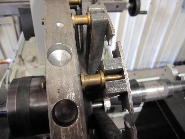

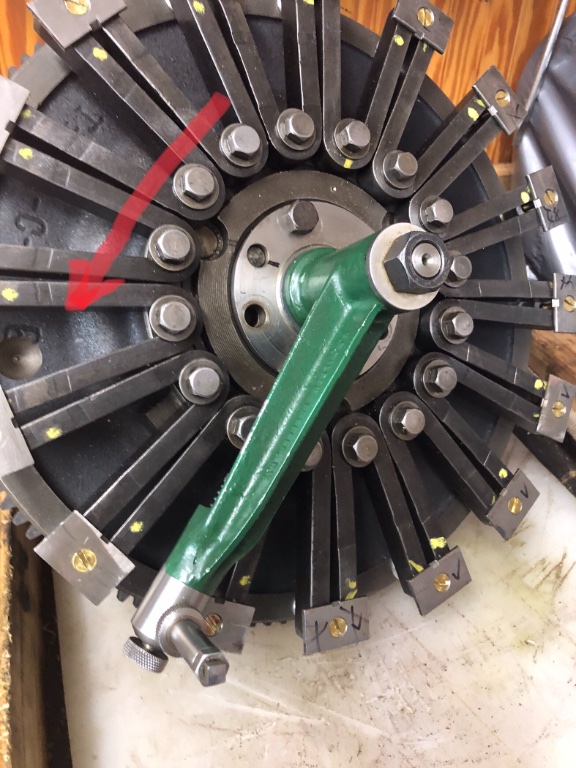

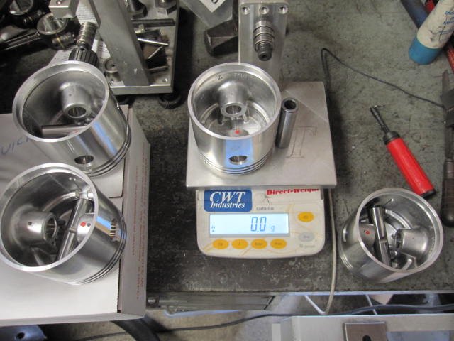

As Dan mentioned the parts have to be balanced separately and don't forget to weigh the triple gears as most often they are off.Tim Rogers wrote: ↑Mon Dec 28, 2020 6:51 pmFor people in the know- should the crank and flywheel be balanced separately and then balanced again as an assembly or just balance the assembly only?
As seen in the pictures we dynamically "spin" crank and flywheel transmission drums and make corrections. We static balance "Weight match" the rods pistons and triple gears. Balancing the engine makes a big difference as most often the rods are way off along with flywheel since there's no way to keep weight of the magnets even. Balancing takes care of the out of weight situation and also makes the car so much better once done properly.

Here's a perfect example of the flywheel being Way off.
This is a 1914 we did .
It was off @ 134 grams almost 5 ounces per inch of the diameter of the flywheel.
Looking at it the total amount off was 1010 grams/ 2.2 pounds in total unbalance.
Combined weight of unbalance of the magnets and flywheel and also the plates.
After i drilled the two 1" holes I was able to get the total balance at two hundreds of a gram per inch and a total of tenth of a gram.
Better than it has to be but closer I get it, the better car runs and lasts.

John showed a picture above of a pretty standard flywheel mandrel. The flywheel is radially located on the mandrel by the cone as shown above. The cone angle is steep enough that it contacts the edge of the bore in the flywheel- not the chamfer on the bore. BUT, as Dennis asked above, it is always good practice to indicate the inside diameter of the counter bore that locates the flywheel on the crank flange during setup, to make sure it is running true. To add to this, any clearance between the crank flange OD and the ID of the flywheel counterbore can introduce additional runout at assembly.
Now another fine point- did the crank grinder indicate the flange OD when the main journal was ground? As you can see, all the little details start piling up pretty quickly.
Last comment- balancing machines with modern electronics are amazingly sensitive- down to the point where you can chase a perfect balance using an 1/8" drill bit and the balancer will see the change in unbalance. It almost becomes a game where you want to see how "perfect" you can get it even after the machine is telling you that you are in spec for a given unbalance amount. Not so easy to do with older equipment. We upgraded our balancer about 4 years ago, and the difference was amazing- but not inexpensive.
