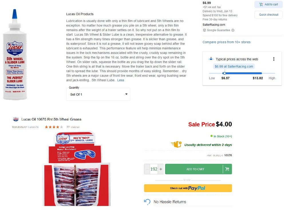

I was wondering if 5th wheel grease would be a better solution for the ball end. I would prefer a grease for the ball end to be "water proof" not just "water resistant"
- Posts: 3743
- Last Name: Wrenn
Re: Is there a way to keep the u-joint grease in?
Frank, I've been using the "Red 'n Tacky" ever since starting with Ts in 2012. I think it works super good. Just my opinion.
- Posts: 6452
Thanks lots of brand's to choose from. Question : does it leak out much? Some owners have complained about the grease that they use (brand?) leaking and making a mess.
