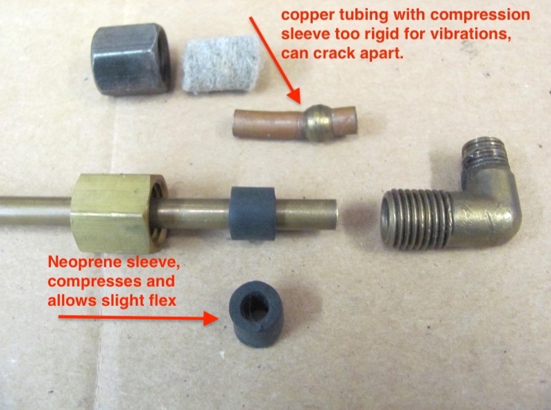

Likely will get flack, as proponents of thin wall copper 1/4" tubing are among T owners. But just because you haven't had a failure, the term may not be up yet on your copper tubing
Most times, the copper tubing is installed with the compression sleeve, into the Ford carb inlet. That type of fitting is too rigid for the twists and vibrations the long fuel line will have, as the T flexes and pitches on driving.
Here is an example of a copper line failure on a recent tour. The owner found out when parked, the carb was leaking profusely. This is the piece that was fractured away. The copper tubing just had too much fatigue.
The better choice is brass or steel tubing line. As for the compression sleeve, Ford used felt, but modern neoprene fuel line provides a superior compression sleeve.

Unless modifications are made, compression fittings should never be used on T's. They require two machined surfaces to accurately pinch the fitting to a firm fit on the tube. The brass outlet on the sediment bulb and the elbow at the carburetor are castings. While the threads are machined, the ends of the castings are not. Tightening the packnuts will compress the acorn onto the tube for a god seal, but the acorn will not necessarily seal on the cast end of the fittings, resulting often in over tightening to try to get that seal.
The short length of modern neoprene fuel line makes an admirable seal using the original packnuts on original fittings, leaving a joint which can tolerate flexing/twisting.
