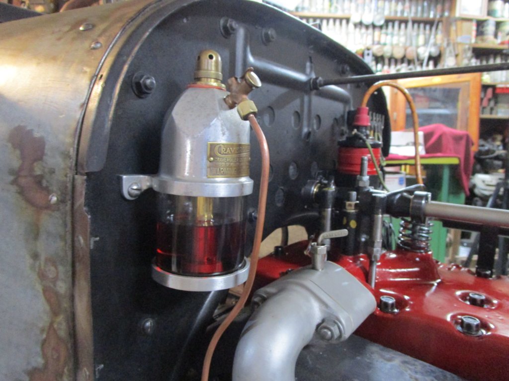

I did take a few pics, one is of my new "dip axle" that I needed to clear the hand crank and a couple of the "Craveroiler" upper cylinder lubricator in use. First pic is of " valve closed" "no vacuum" then "valve open" "a little vacuum" I ran it for about 2 minutes with the vacuum valve wide open and never did smell the Marvel Mystery Oil or see any smoke. Ill have to play with it some to figure it out ...
Anyway, All seems to be well in speedster land again .... Thanks for the input, its always appreciated ...

Mike, I believe it may be because I hooked up the lubricator for the Marvel Mystery Oil. The "mystery problem" just needed some oil. :)
