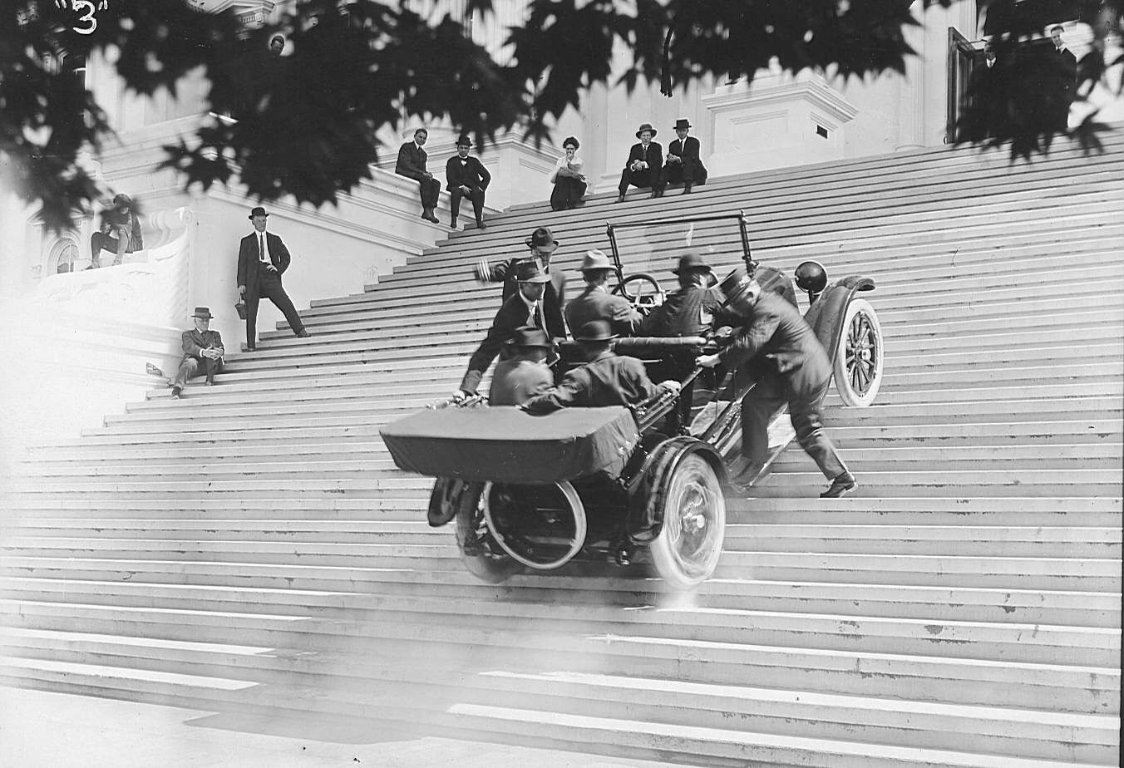

What problem climbing a steep grade with people in?

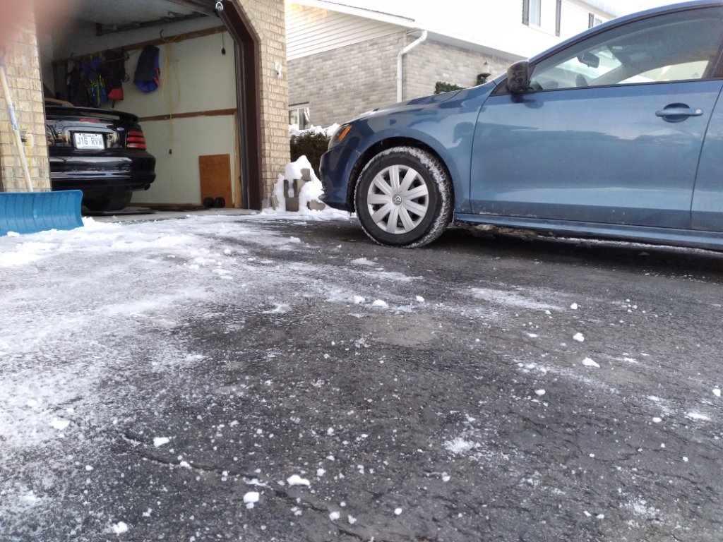

Sounds like maybe your driveway looks a bit like this? My advice--sell the house and get one that's on flatter ground! ;) :lol:
I didn't read all the rather lengthy suggestions, so I at least hope someone also mentioned to make sure your bands are well adjusted. Also, if nothing else, put one of those concrete "car stoppers" in your garage, like they used to have in parking lots years ago. I think overall, for safety sake, though, backing it in might be the best. That way, when leaving the garage, you have full frontal view, hand on the emergency lever, one foot on the service brake, such as it is,left foot on clutch holding neutral, and just coast out of the driveway. Dozen different ways, but in the end, you gotta figure out what works for you. Good luck!
steep driveways.jpg (73.37 KiB) Viewed 8171 times

Again, thank you all so much for you answers. They are all interesting to read. I'm posting pictures of what I have to deal with. And also I have remeasured my driveway length and height just to be sure. I also used a grade calculator to make sure I've got the right % and it gives me around 13%... Not as bad as 20% :? But still... still steep. I have to be vigilant when parking the 5 speed Mustang so imagine with a Model T.
Here are the pictures, let me know what you think!
Thanks. Phil.

...more pictures.

I can't get a perfect perspective on your driveway, but it is not nearly as steep as TWrenn driveway. It looks like you have a curve on the way up. I think a winch mounted high enough on the front wall at the right as you look at the picture would work. Not so high it would lift the car as you got into the garage, but high enough so the cable would not drag on the driveway.

Oh Hell. That would be a piece of cake in a T. Buy yourself a Touring or a Roadster so you can drive right in, and the wind will blow thru your hair like it does in a corvette. Come to Milwaukee and I will teach you how to drive a Speedster. Then you will never have a problem parking in your garage.

Looking at the pictures I think it won't be a problem if the car will fit in the door. The fact that the driveway levels off a bit before the door means you can back off on the power at that point and ease it in. It's not like a manual transmission...with the lever in neutral the left pedal is the go pedal. Release it at the top and coast in. If you need a little more forward motion, press it in again briefly. Rest your right foot above the brake and apply as needed. Piece of cake! Just get a little driving practice in first.
Word of caution...don't trust the parking brake when parking on a slope. I carry chocks in my car for that purpose. That's a good job for your copilot :D

Your entry should not be a problem. It may take some practice but the slope doesn't appear to be as much as I have. I back a 12 t hack into the barn and squeeze between a storage bin and the bumper of a 27 Marmon. I get the T up into the barn just to where it is on the level floor and pull it in using the front wheels. I find that I can rotate the wheels pulling on the spokes and turn the wheel at the same time. Not to belittle your concern but it should be a piece of cake for you. Just takes practice.

:lol: After seeing the pics, I said exactly what Dave Hort said! :lol:
The last pic does show it a bit steeper looking than the others, but still...not bad at all. Thank GOD it's nothing like that idiotic
driveway in the pic I posted above!! Off topic as it is, THAT builder oughta be thrown in jail for even attempting to peddle a piece of crap driveway like that! Worse yet would be the idiot(s) who bought into that junk!! :lol:
Be brave, go slow, you'll be fine. Just be sure the TOP IS DOWN!!

I agree with the others, Your driveway is not a problem once you get the hang of driving a T and are careful going up the slight hill. I agree also that before you buy a T, first measure the height of your door opening and make sure the T will fit in, preferably with the top up. Many modern garage doors have a 6'6" to 6'11' high opening which often are not high enough for the earlier cars.

Pictures can be deceiving, but I agree it doesn't look bad at all. It also looks like your doors are tall enough, but measure and be sure.

I'm happy to read that its not enough to cause any issues.
Thank you all for your input!
