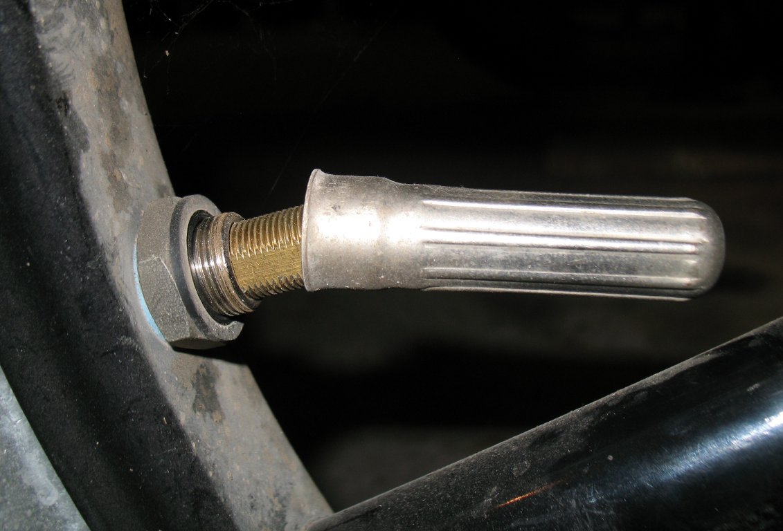

Here's a valve stem cover and a rim nut, brass version. Larry will tell you this is not correct, and he's right. The modern metal stems, and the originals I use, are larger than the Schrader 777 used by Ford. As Dude Lester said, "It don't hurt the runnin' of it none."

What is the purpose of the bridge washer? Is it necessary if I use a rim flap? It seems like it could be contributing to the problem by preventing the tube from being “flush” with the inside of the rim. By rim nut I was referring to the thin nut that comes with the tube. I assumed this goes on after the valve is through the wheel, as that’s how I’ve seen it on other vehicles.
