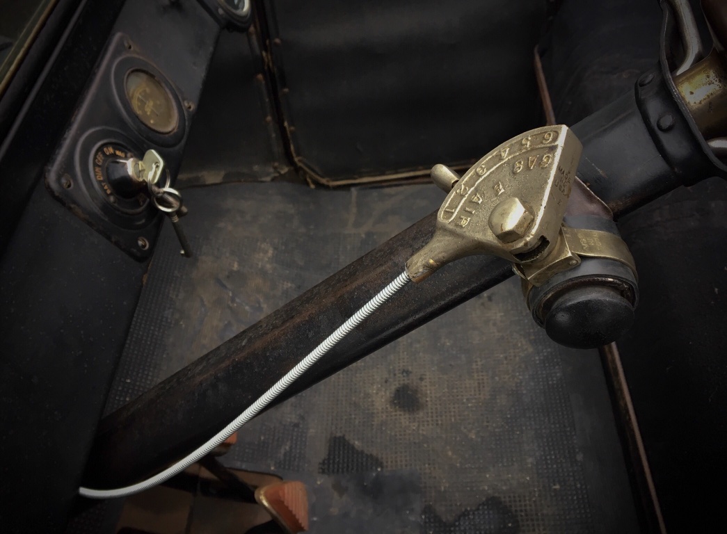

Here is a vintage column control I use for either an OF I have or the U&J I’m currently using. It comes in very handy when starting in cold weather. You can gradually back off on the choke as the engine warms up.

Here is a pic of one similar to what Allan mentions. Not sure who made it. A spring loaded ball holds it in place. Also, showing an ad for the type that Mark is using. These were made and offered by Schebler. Don’t know why , but I’m drawn to choke controls. Maybe because the originals are so hard to find. Shameless plug. We have them for Carter, Zenith, Stromberg and Schebler. The Schebler looks great polished up in brass , especially with it’s brass wire tube, on a brass T

Thanks for the pictures. Mark, your brass control looks functionally much like the one Tim is making now. How did you route the cable from the column to the carb?
Anyone else care to show the routing that works well for you?
