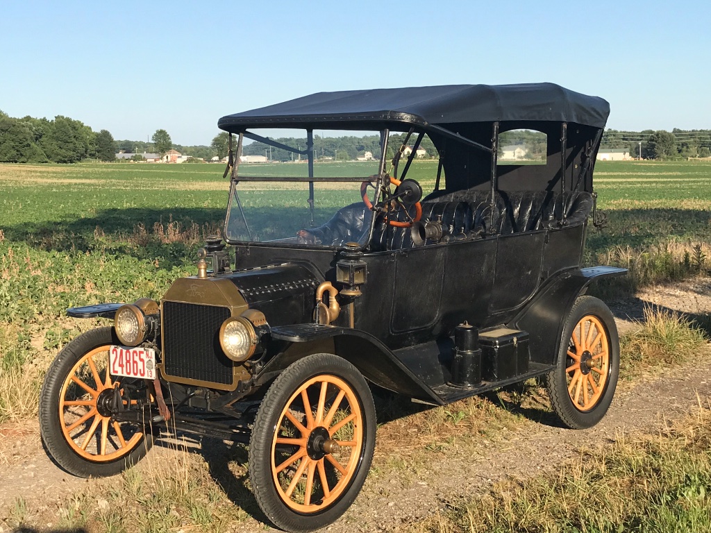

After market colors

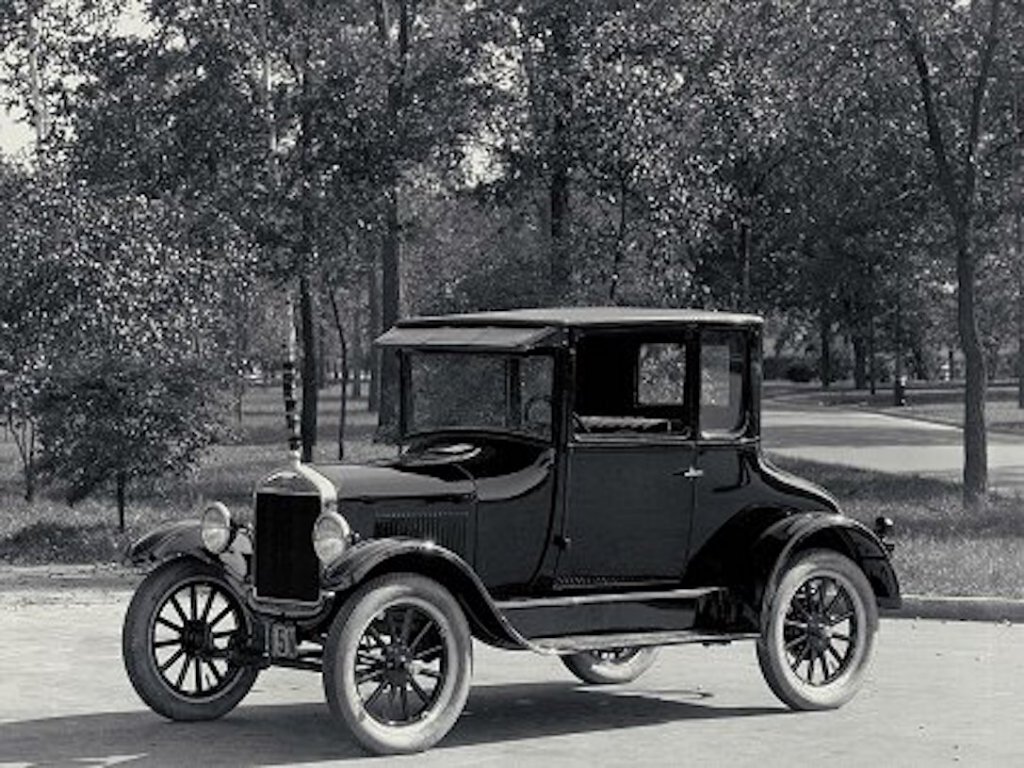

Post by Steve Jelf » Wed Jan 27, 2021 12:01 pm
While "natural" wheels became an option in 26-27, they are primarily a modern fad. Before 1926 all wheels were painted body color (black 1913-1925). In 26-27 the stock wood wheels remained black. I believe that's what you'll see in most period photos (not advertising) of Fords with wood wheels. I believe I've seen "natural" wheels in 26-27 advertising, but even there the wheels are usually black.
1925

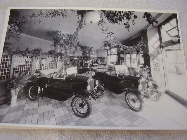

24-25

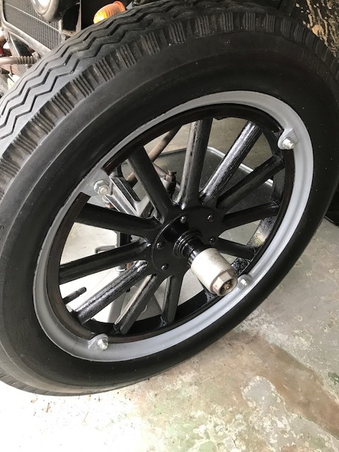

26-27
1926

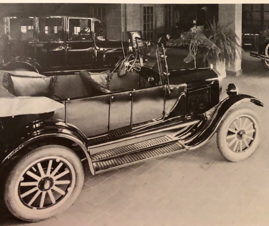

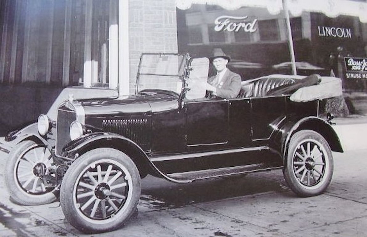

Another new Touring, sport model in 1926 in dealer showroom.
Just like today, the dealers present the most beautiful or optioned out cars to draw in customers. They know what the customer likes the best, and sell that high end model.
Many didn't go for the 'beauty' T of the day, but a lot did as marketing of features was done by all the other mfg. and in 1926 natural wood finish on spoke wheels was the In Thing. :lol: You were driving the Cat's Meow if your new T sported tan top cover, windwings, and those beautiful varnished wood spoke wheels, that glimmered like a Gar Wood fast craft. ;)

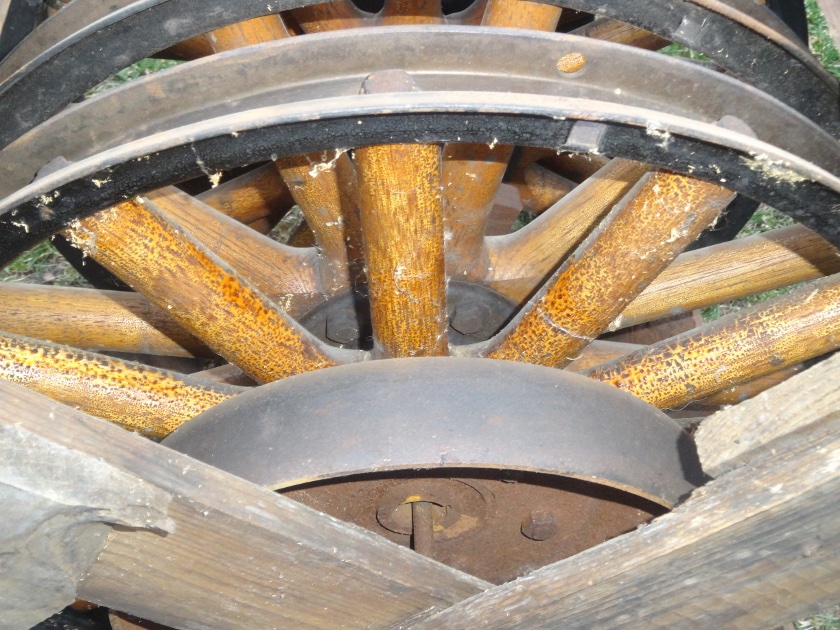

George.
Ford offered factory varnish wheels, these were offered to dealers, and were factory installed at Branch assembly plant on cars to dealer orders too.
Check the Ford Parts and Price lists. (Aug 1, 1926) as follows: #2801E Front, natural balloon; #2814M Rear, natural, balloon 8"drum (for the '25 ) #2814M2 Rear, natural, balloon 11" drum ('26-'27)
NOS crated natural, balloon wheel, for dealer shipment if ordered by dealer to replace painted spoke wheel for customer desires.
DSC00821%20630x840_zpsjndqsgzv (525x700).jpg (184.01 KiB) Viewed 5199 times
75 years of storage in who knows what environment and these varnished spokes could use a re-finishing. ;)
