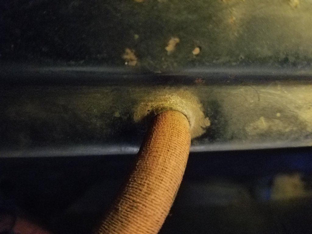

We talk about these every so often so I measured and took a picture
of mine in the shop today.The running boards and splash shields are original 1913.
The carbide generator holes have the diamond pattern "shortened" in front
of them so the punch hits a flat spot. Slight indentation on the top and a
slight smooth rim on the underside. It is 21/64" in diameter.
The gas hose hole is 1/2" in diameter and has a smooth 1/8" high rim
around the edge to protect the gas hose.
