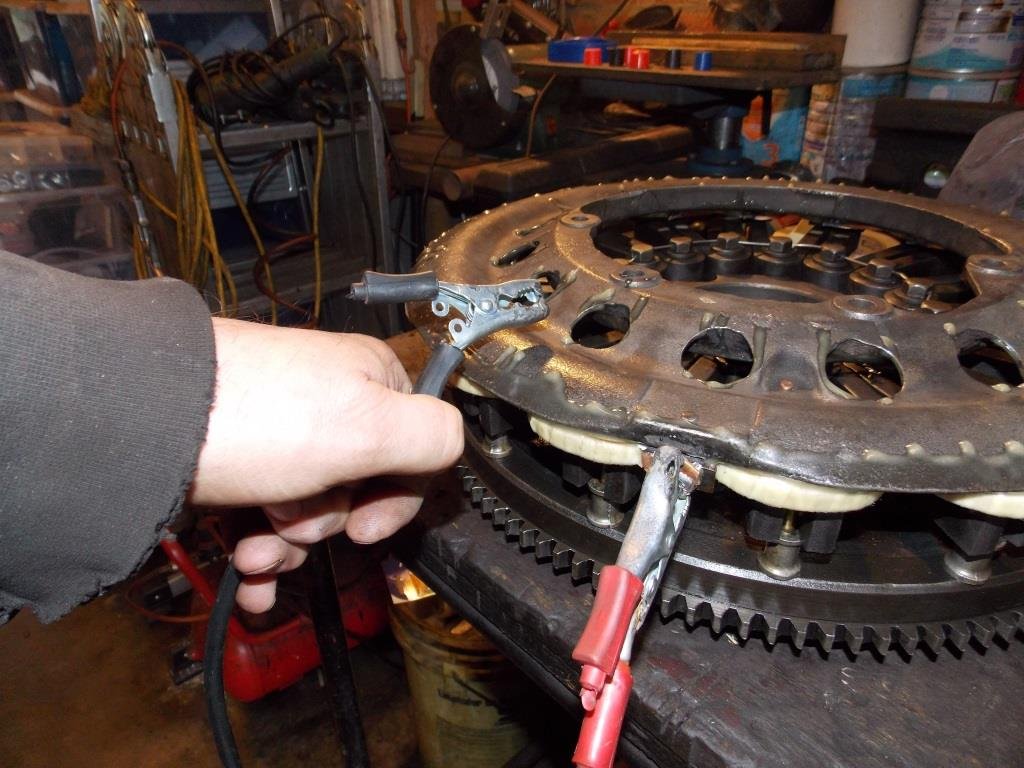

There is a fourth way to charge the magnets, an easy one when it is all apart, with a fresh rebuild flywheel and good magneto coil loop.
Put the flywheel with the magnets on top on a flat table. Put your coil ring, well centered, on top of the flywheel North magnet on South coil.
Connect three 12V batteries to get 36V. Connect the positive wire on the magneto post and flash a, few times, with the negative wire on the coil ring frame.
I leave the negative wire connected for 2 seconds each flash, 5 flashes should do the job.
Test for the charge: Try to seperate the coil ring from the flywheel by hand, you will need a bar to do that.
Most of the time you can lift up the magneto ring with the flywheel hanging on it.
Twelve years ago I did this also with one 12V and one 6 V battery (all the batteries I had available that time), the car is still running well on magneto.
The flashing is also a good test on the condition of your coil ring.
Good luck
Andre
Belgium
centered coil loop on the flywheel
Charge test by lifting up the assembly
Flash
Flash
36V connection
36V connection
