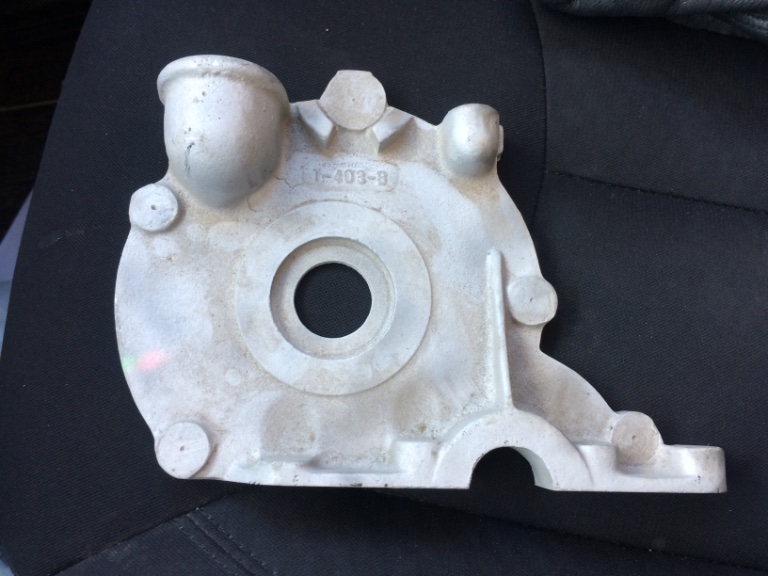

Yesterday I found this casting in my shop. The oil filler is located a bit differently. So what era is it correct for?  Or is it RHD drive?

And perhaps the B is 8!!

Reproduction of the early front plate for the small dia. 2-piece timer case of 1909. Part #3009, Factory # T-403B. Used ‘09-‘10. (after the first 2500)

Thank you for the information. I have no idea why I have it!!
If someone needs it, it’s available!!
Otherwise I may just make it fit onto my 13 RHD
