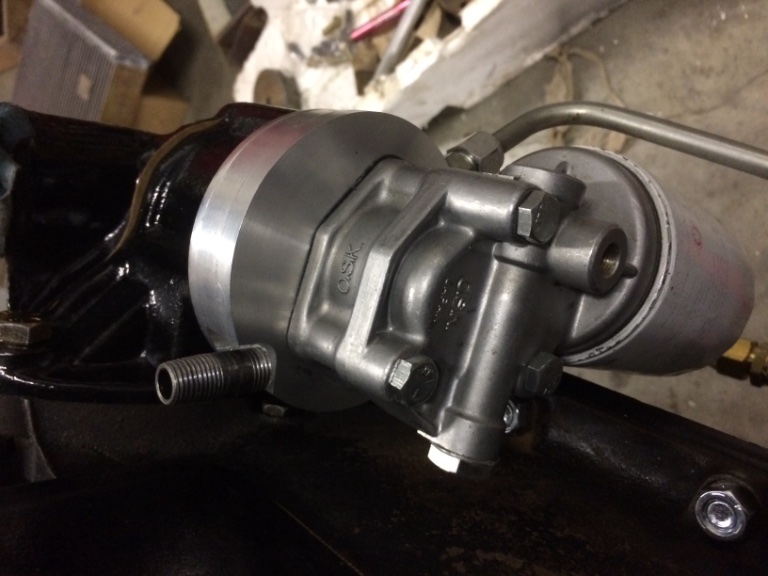

All the mag drives turn at crank speed, and the mags have a built in 2:1 reduction for the distributor cap to run at cam speed.  The generator gear runs faster than crank speed (I don’t recall how much faster...?), and it sure makes the B210 pump... PUMP!  My speedster motor used to idle at 75 psi, and peg the 100 psi gage at about 2000 rpm.  I cut down the bypass spring and have it idling at about 30 psi now, and 50+ psi at speed.
If you were to adapt a B210 pump to a mag drive, the adapter would not be near as simple. The mags are mounted with 2 bolts into a lower base, and the B210 pump bolts directly to the face of a casting

My only gripe about the B210 pump is that the original generator drive gear gets cantilevered off the end of the B210 shaft with an adapter bushing.  Turns out it’s not a very big gripe, since my pump has been operating trouble free for 10+ years and probably 10,000+ miles.

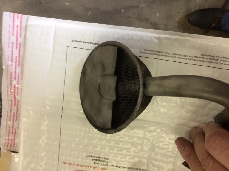

One thing  that is important to do is putting a screen filter on the suction side,  pickup tube also. Any lint from the bands going through the system will
clog up and you can burn up an engine or rocker system. We found this out the hard way on a DO.

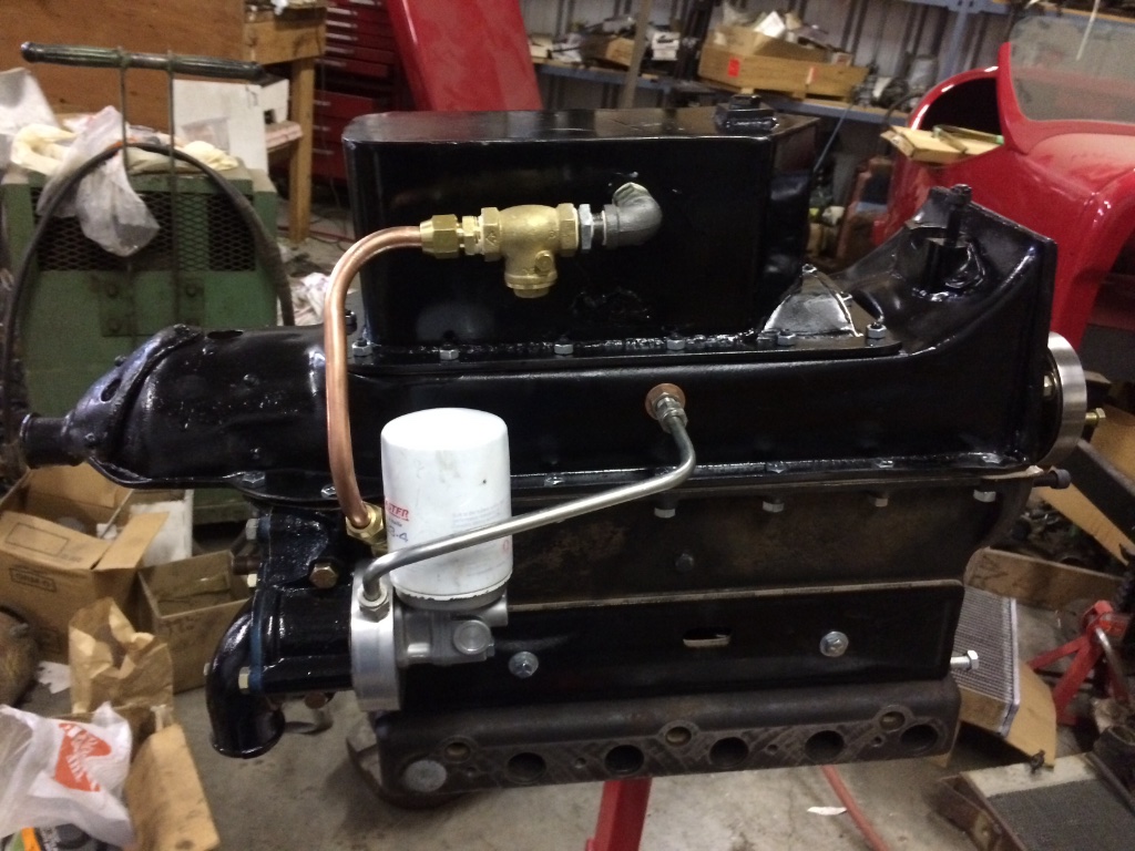

The pipe nipple pointing up is the priming connection. Typically only needed after a oil change or sitting for a long time

I like the sound of dumping the overflow to the transmission. Nice install Les.
