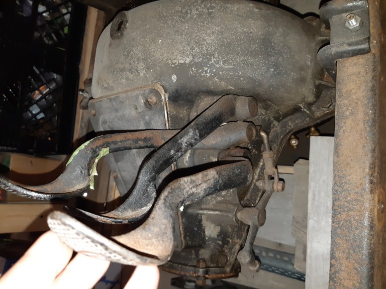

Post by nsbrassnut » Fri Feb 05, 2021 6:15 pm
Hi Martynn
Hear are a few pictures of a '14/15 Canadian RHD hogs head with the pedals still in place. Although the pedals are lettered, the shape of the pedals and pedal arms is essentially the same for all that I've seen at least up to '20 or so.
This may help with your drawings.
Drive Safe
Jeff

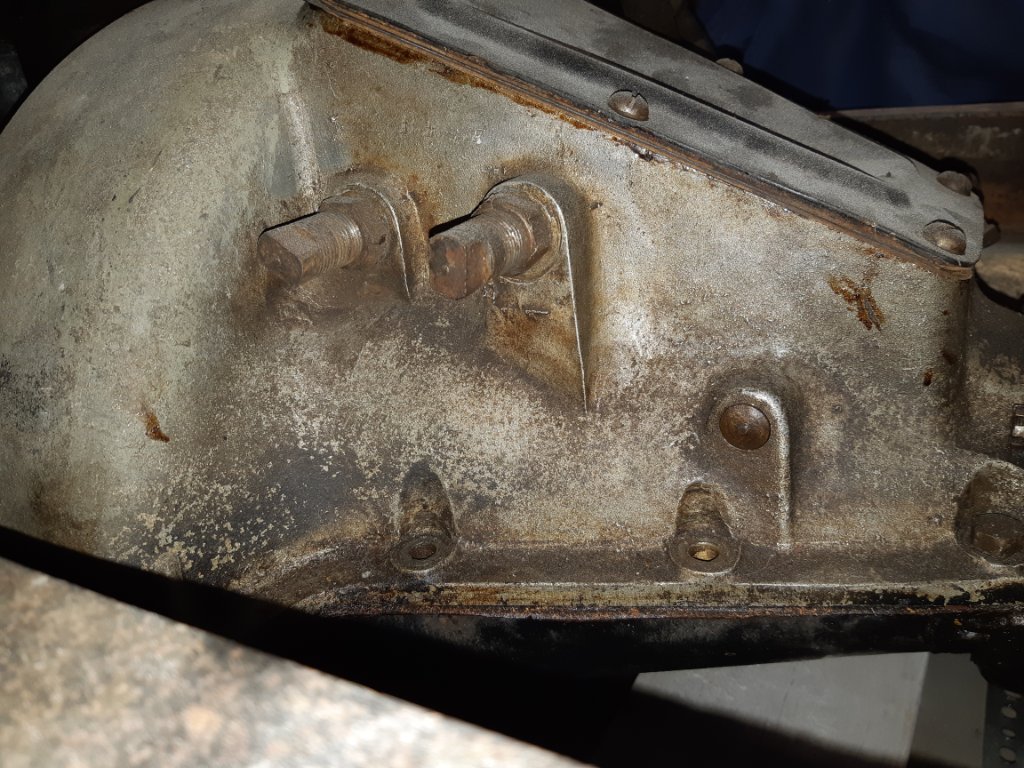

Something else that may be unique to Canadian Hogs, with the transition to cast iron, come across this one in having the support ribs that are much larger than what was added to the later aluminium ones and larger than what's on later 16+ cast hogs, The pedals are ribbed ones on this cast iron one.
The attachment 000_0679.JPG is no longer available

For the '15 CDN cars, I think the change from lettered to ribbed pedals happened some time through the year. My '15 roadster had a mix of pedal, the two pinned in place were lettered, the removeable clutch pedal was ribbed. So its possible that early '15 CDN still used lettered pedals, and by the end of '15 the change to ribbed pedals had worked its way through.

And something for Frank. Just to show that Ts are rarely consistent. I have a RHD Canadian hogshead that came attached to a '16 block. Its cast iron and doesn't have the extra re-enforcing ribs shown in your picture. Those extra ribs may have been added a bit later in the teens. I believe that Ford Canada didn't really get its own foundry up and running until around 1919 when they started to cast Canadian blocks and maybe that is when the different hogs heads were made.

But to support your comments. I went back into my files searching for a picture of the engine in a Canadian 1918 nearby. It appears to also be a 1918 cast Canadian block. Not real clear in the picture, but the DA of Canada is below the steering column. Casting date appears to be 3-2-18 and the serial C151XXX. And a later picture of the restored engine showed it was clearly a Made in Canada block, but you can't read the casting date in the fresh paint.
The starter in the second picture may be deceiving. The owner added a starter hogshead and starter when restoring the car.

I would suggest taking another look at the clutch and brake pedals for the RHD in the pictures. Both pedals have some significant bends in the pedals to get them in the right position. With your drawing being a 3 D angular project they can be hard to show. In the current view they look fairly straight when they actually have some real sharp bends in them, especially the brake pedal. The reverse pedal is nearly straight, with the offset right down at the boss for the shaft.
But please keep the drawings coming.

Jeff, I've tried to make the brake pedal as close to what I've seen of its bends as possible. But the angle upon which I've drawn the hogshead, doesn't lend itself to showing it as it really looks in 3D...in 2D it is a bit harder to give the correct depth to slight angles as they would actually appear. If you will notice the bend on the clutch pedal and the bend on the brake pedal are in opposite directions for each other. I know that the reverse pedal is nearly straight, so are you saying that it hasn't got that bend on it like I'm showing, that it comes off the boss on that angle without a bend? Do you have a picture of one of these pedals outside of the hogshead?, something like a side view, so I can see where it comes off the boss.

Jeff, hope this is more in line with what you had in mind. Went back and took a closer look at those pedals and their bends. One of the pictures I've got shows a rather severe bend to the right on the Brake pedal.
This not how Ford depicts them, the pedals are all evenly spaced from each other much like they appear on the LHD cars. But I can see the advantages of such a bend, my guess is that some owner did that because he kept hitting the Reverse pedal along with the Brake pedal and probably stalling the car (any two pedals hit at the same time will stall the engine...it's one of the last resort panic stop techniques). I had to do it just once myself, kept me from hitting some lousy Japanese "shoe skate" from behind when he cut me off on PCH 1. Needless to say, scared the shit out of him by the look in his eyes in his rear view mirror as my car kept getting closer and closer with no signs of stopping, than he or I was comfortable with. I finally had to turn by jumping the curb, crossing the sidewalk and coming to a stop in a parking lot, cussing a blue streak over what kind of imbecile he was and questioning the legitimacy of his parentage too! Since then I drive more like a Motorcycle rider than a car driver...watching absolutely EVERYBODY! Their front wheels even slightly makes a move in my direction I start hitting the brake.

This is a 1915 brake pedal which shows the amount of RH bend
You will notice the pedal leaves the end connected to the shaft at a steep angle to the right and then bends back vertical
