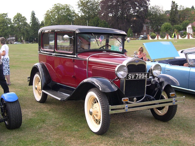

Thank you everyone. Very helpful, especially about it being black above the beltline. I will check out the newspaper links. It sort of sounds as Ford was much more compliant to the customers desires, down under and that any color the customer wanted below the beltline was on the table, as long as it was available. If that is the case, I may go with the black fenders, splash guards and apron, with maroon below the beltline and black above the beltline. Here is a photo of a two toned Model A as well as my ‘26 Fordor. Except for the black paint ending to a point on the Model A cowl moulding, which the Fordor does not have, it is easy to imagine a ‘26 Fordor painted in the same type of two toned color scheme. Jim Patrick
