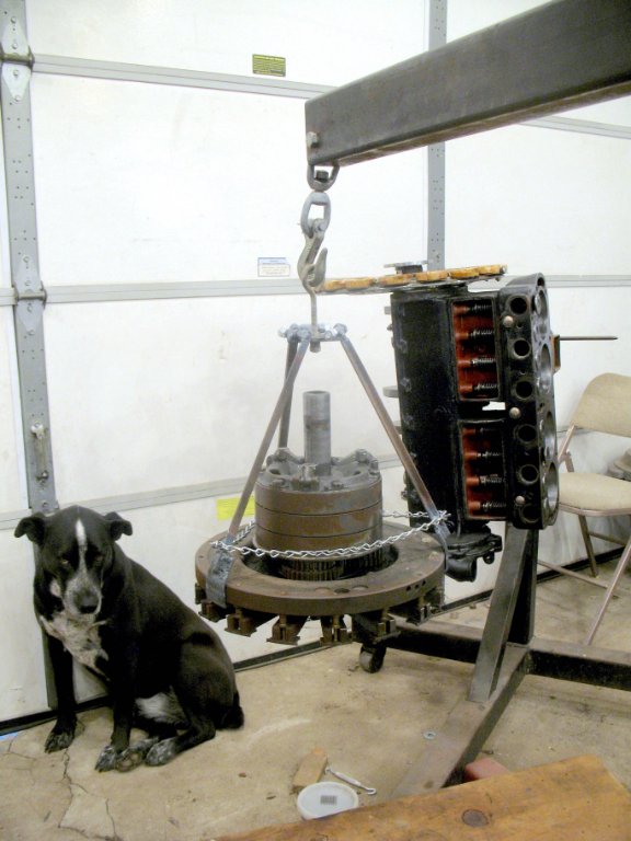

- Posts: 5539
Re: Welding machines
Jeff, your pup looks like he has done something bad and knows it!

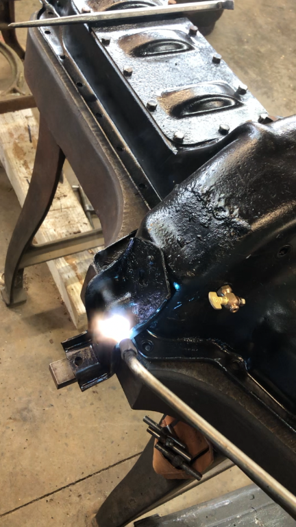

If I could only have one thing to weld with, it would be a complete oxy-acc set up. It must include a cutting torch, various brazing-welding tips and a rosebud heating tip. If you get proficient with it, many things are possible. All welding processes are revealed while using this set-up. Arc, mig, tig, plasma, and of course brazing/soldering. The oxy-acc is the most versatile and is mother of all these processes. Being proficient with it will give you a great understanding/head start when using all the other processes. Building my race car, I relied heavily on my oxy-acc set up!
