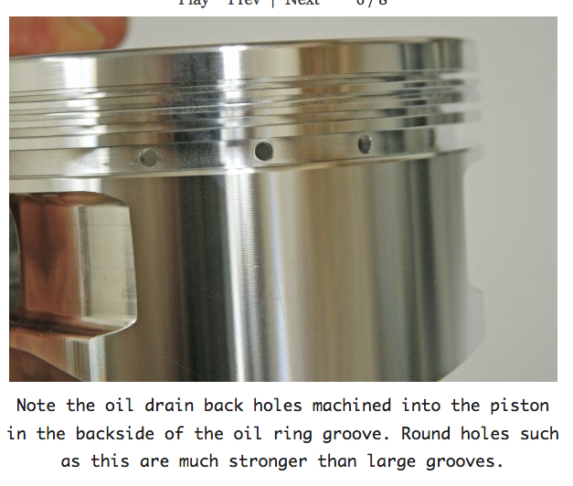

GrandpaFord
Posts: 146
First Name: Neil
Last Name: Kaminar
Location: Mebane, North Carolina
Re: new piston rings
Post by GrandpaFord » Fri Jan 11, 2019 7:35 pm
Phil, All modern pistons have the holes in the oil ring grooves.

Posts: 6801
Post by Scott_Conger » Fri Jan 11, 2019 10:16 pm
And that is all well and good for modern pistons with oil rings.
Model T's do not have oil rings. Just 3 compression rings.

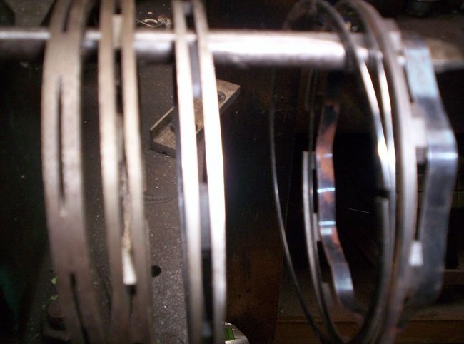

Kerry
Posts: 1463
Last Name: van Ekeren
Post by Kerry » Fri Jan 11, 2019 11:31 pm
That being true, the original piston only had 3 compression rings but over the years many styles of replacements.
4 different oil ring styles, 3 different pistons with oil relief holes.

Kerry
Posts: 1463
Post by Kerry » Sat Jan 12, 2019 12:41 am
The oil relief holes in the centre and right pistons in the photo are below the second ring, drilled in a shamfer that is machined just under.
GrandpaFord
Posts: 146
First Name: Neil
Last Name: Kaminar
Post by GrandpaFord » Sun Jan 13, 2019 2:45 pm
If the 3rd, or 4th, ring does not have the slots, then there is no need to have the holes in the pistons. If it does have the slots, then the holes should be drilled. If you don't have the slots then you don't have an oil control ring and all the rings are compression rings. The rings should be close fitting in the grooves and the gaps should be correct. The huge gaps that Phil reported will allow lots of oil to be pumped above the pistons. If the rings do not fit tight in the grooves then they will pump oil into the combustion chamber.
For my money I would change out to modern aluminum pistons with an oil control ring, but it is Phil's car and he gets to do what he feels is best. Aluminum pistons also means more work and money.
