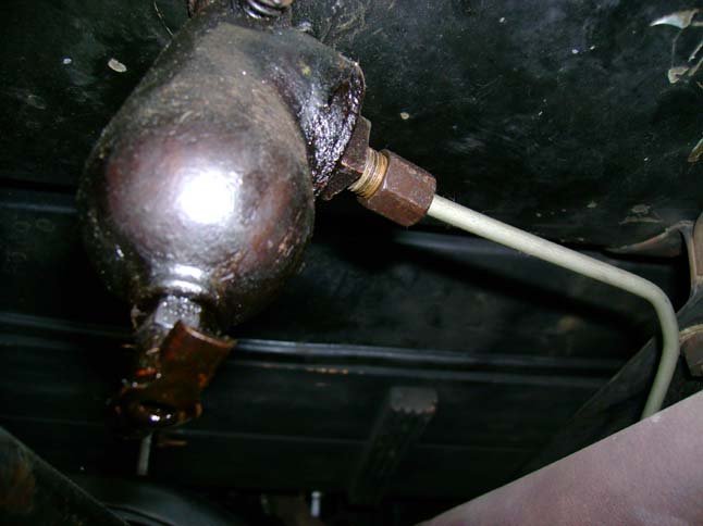

The most important thing about the route of the fuel line is, the line should slope up at each end with one low point between the two ends. Do not have a high point somewhere between the two ends because an air or vapor bubble can form and rise to that point then the fuel will stop flowing. It will just compress the air. This is called,"vapor lock". I will attach pictures of the way I ran mine.It goes straight across over the exhaust pipe, lowest point at clamp which is attached to the bracket at the brake cross shaft and up toward the carburetor.
